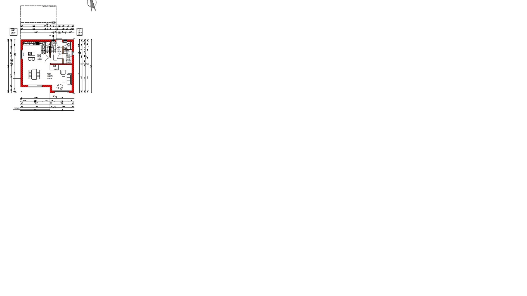

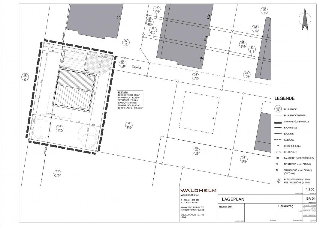

I also find this one better than your other design.
For example, I would still plan a small window on the west side of the living room to let in some sunlight and move the carport forward instead.
But I’m assuming you have a general contractor or a contractor with an architect who works for the company, possibly without much enthusiasm.
This proposal can certainly be improved as well, for example the cold storage room — the same old story about storage space!

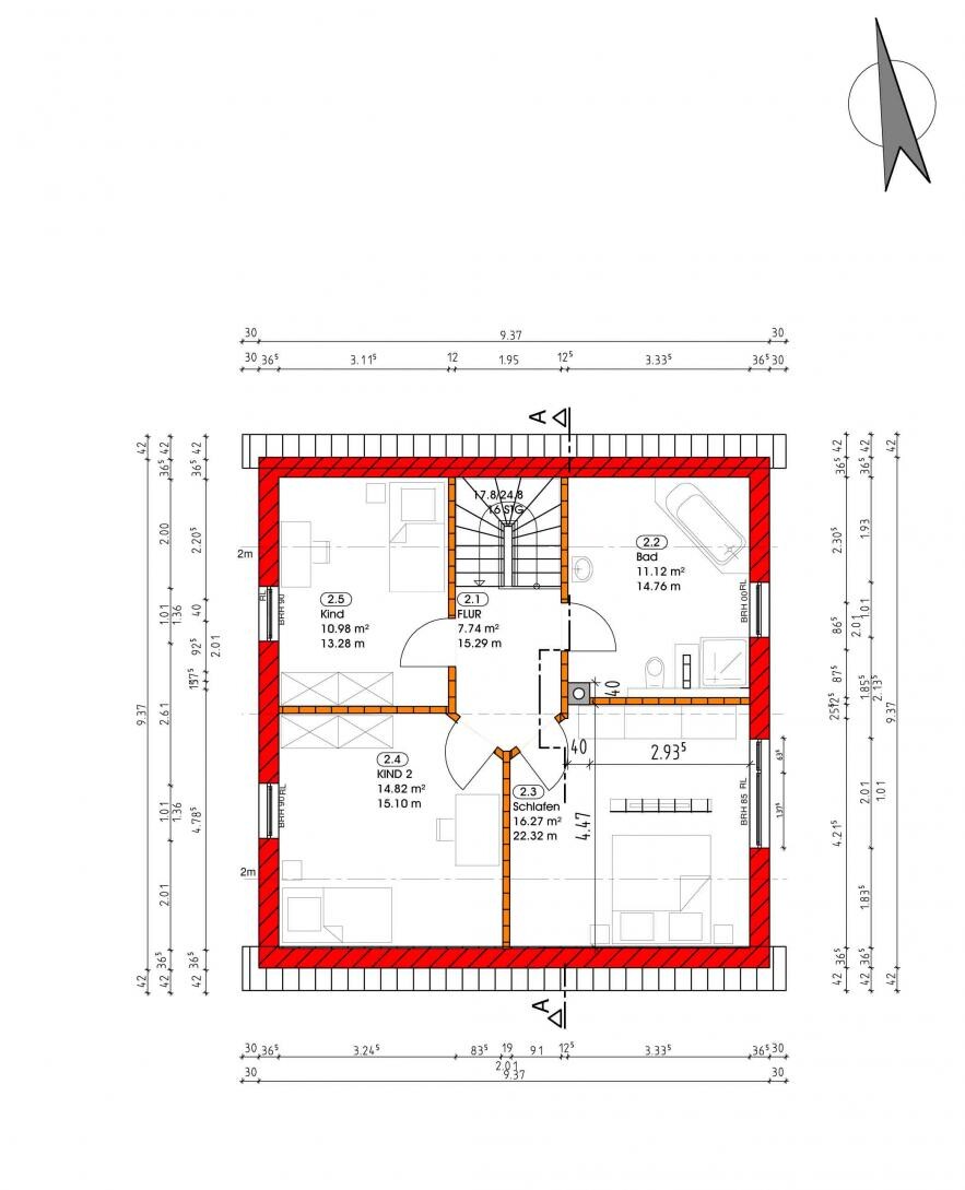

Bauexperte13 Nov 2013 12:29The hallway has become nicely spacious.
But where will the electrical cabinet go?
Where do you dry your laundry?
Who will cut down your 3-meter (10-foot) bedroom wardrobe to 2.90 meters (9.5 feet)? After building the house, you probably won’t have the budget for custom modifications.
Which child will get the small storage room?
On the other hand, you have a bathroom big enough to dance in… I’m not a fan of that spacious, hall-like atmosphere in a bathroom—but some people need that size (especially with four occupants, I guess)—so if you need it...
still, I find the room layouts and their relative sizes quite random and not well thought through.
