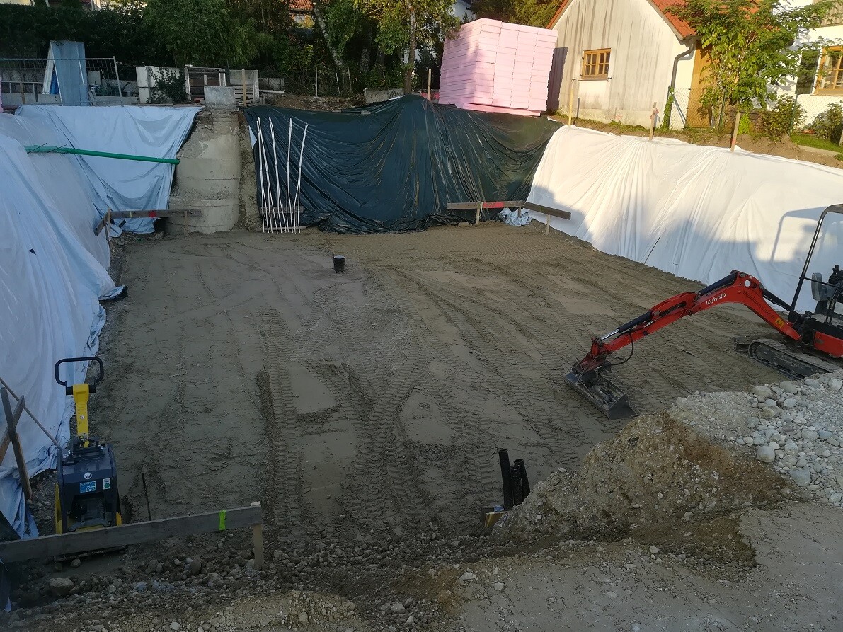

So, a lot is happening here, but you can’t really see it.

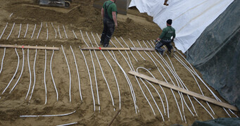

The drainage was installed, the house connection (and yes, it goes through the concrete slab), and now the geothermal pipes with ground activation have been laid and immediately covered with sand. So right now it looks more like a beach. The white lines at the back are from the geothermal pipes:
Next comes the insulation (the pink boards you can see at the edges), then an EPDM membrane, and on top of that the wooden subfloor.
