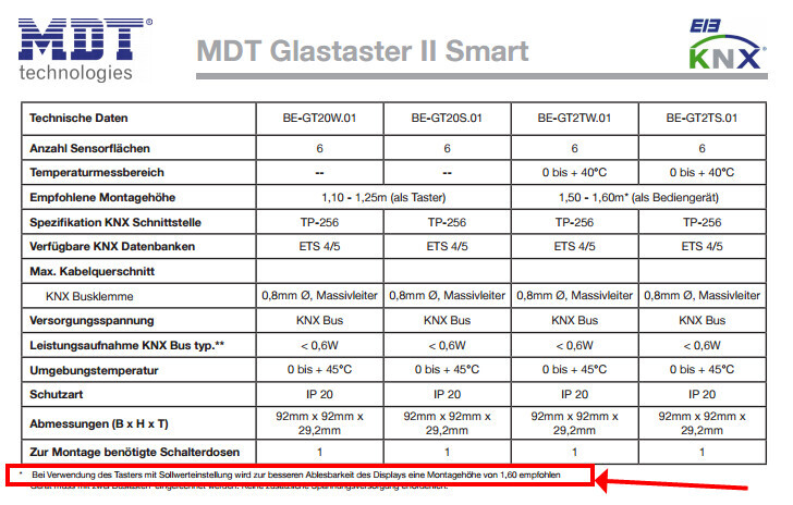

The recommended height is 1.50–1.60 meters (4 ft 11 in – 5 ft 3 in) according to mdt (website). However, the switches allow for any height and are always readable and operable.
In our living room, they are set at 1.40 meters (4 ft 7 in), and throughout the rest of the house at 1.10 meters (3 ft 7 in).
truce schrieb:
@Sascha_aus_H
Nice MDT push buttons.
At what height did you install them?
We were unsure because standard push buttons are usually placed around 1.15 m (3 ft 9 in), but MDT recommends 1.6 to 1.7 m (5 ft 3 in to 5 ft 7 in).
We have them installed now at about 1.4 m (4 ft 7 in), I think.
Did you install KNX yourself?We installed them at 1.3 m (4 ft 3 in), which I find perfect. However, we are not very tall (max. 171 cm (5 ft 7 in)).
I find the Gira G1 too low and would place it at about 1.5 m (4 ft 11 in) next time.
I had the electrician handle the wiring and distribution cabinet. I installed the sensors and did the programming myself.
