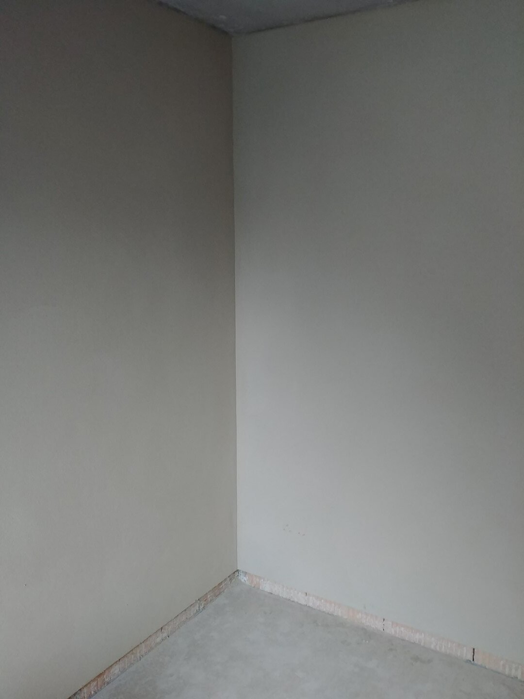

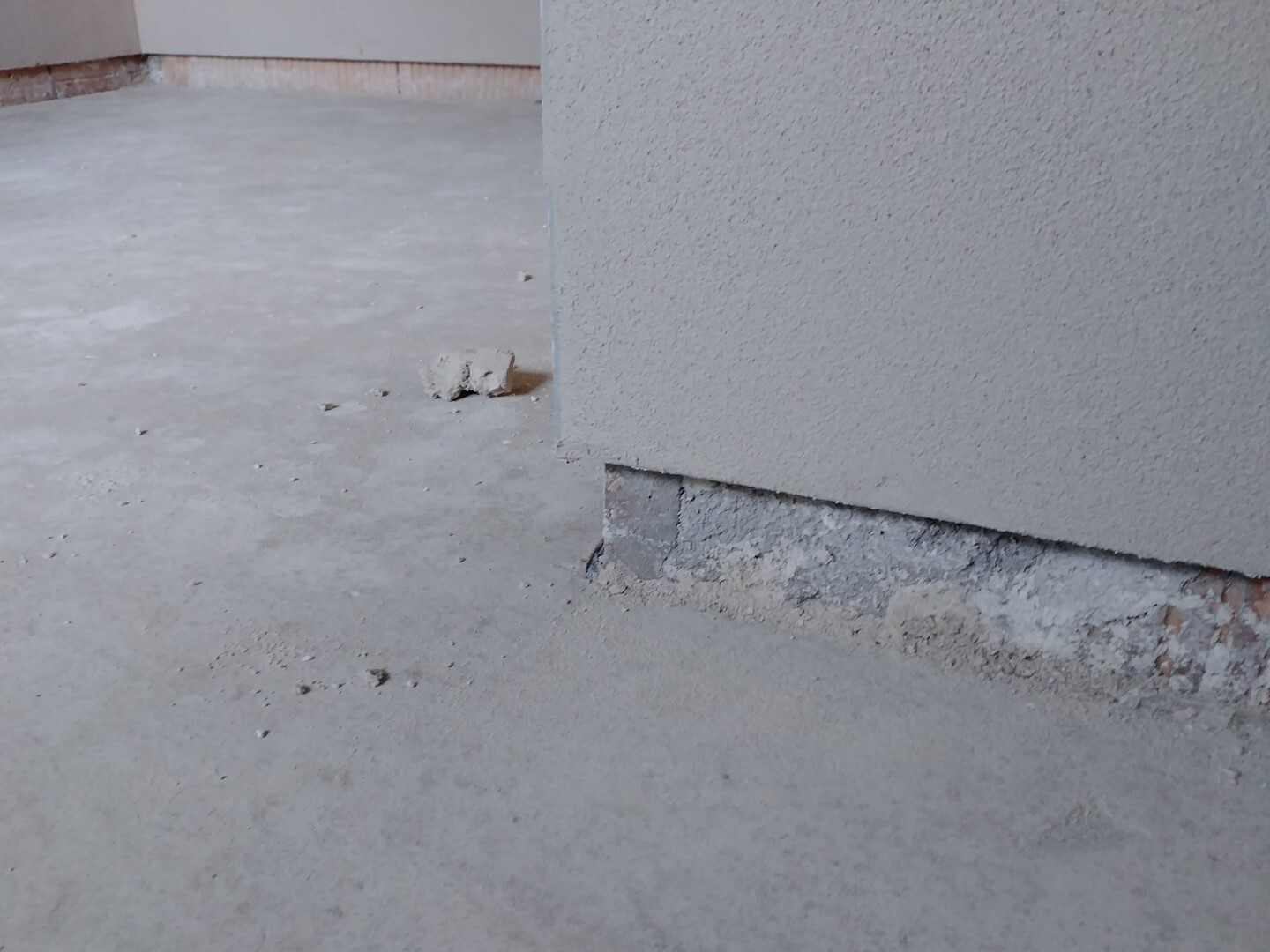

The interior plastering is making progress. Since we discussed flush baseboards earlier, here is a picture.
The plasterer has now installed a plaster reveal, precisely at a height of 8cm (3 inches) above the screed, so that the baseboard fits nicely underneath.
We are being charged €2.50 per linear meter net, which totals approximately €700.
By the way, the screed is not really affected by the subsequent plastering. However, I feel that my tradespeople generally work very cleanly.
winnetou7812 Sep 2017 08:38I think the price is fair.
However, I find it difficult to imagine that if the plaster is not perfectly smooth, the transition might appear wavy.
That’s why I put a strip of plaster on the wall before plastering. After the screed was installed, I walked around the whole house with my battens and marked the finished skirting heights, installed a finishing profile, and plastered the gap. This way, the distance to the screed or finished floor is consistent everywhere.
