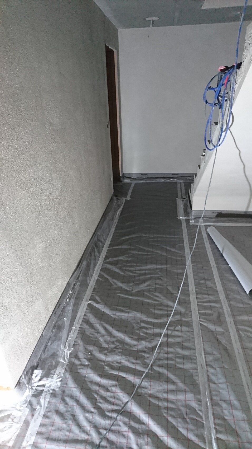

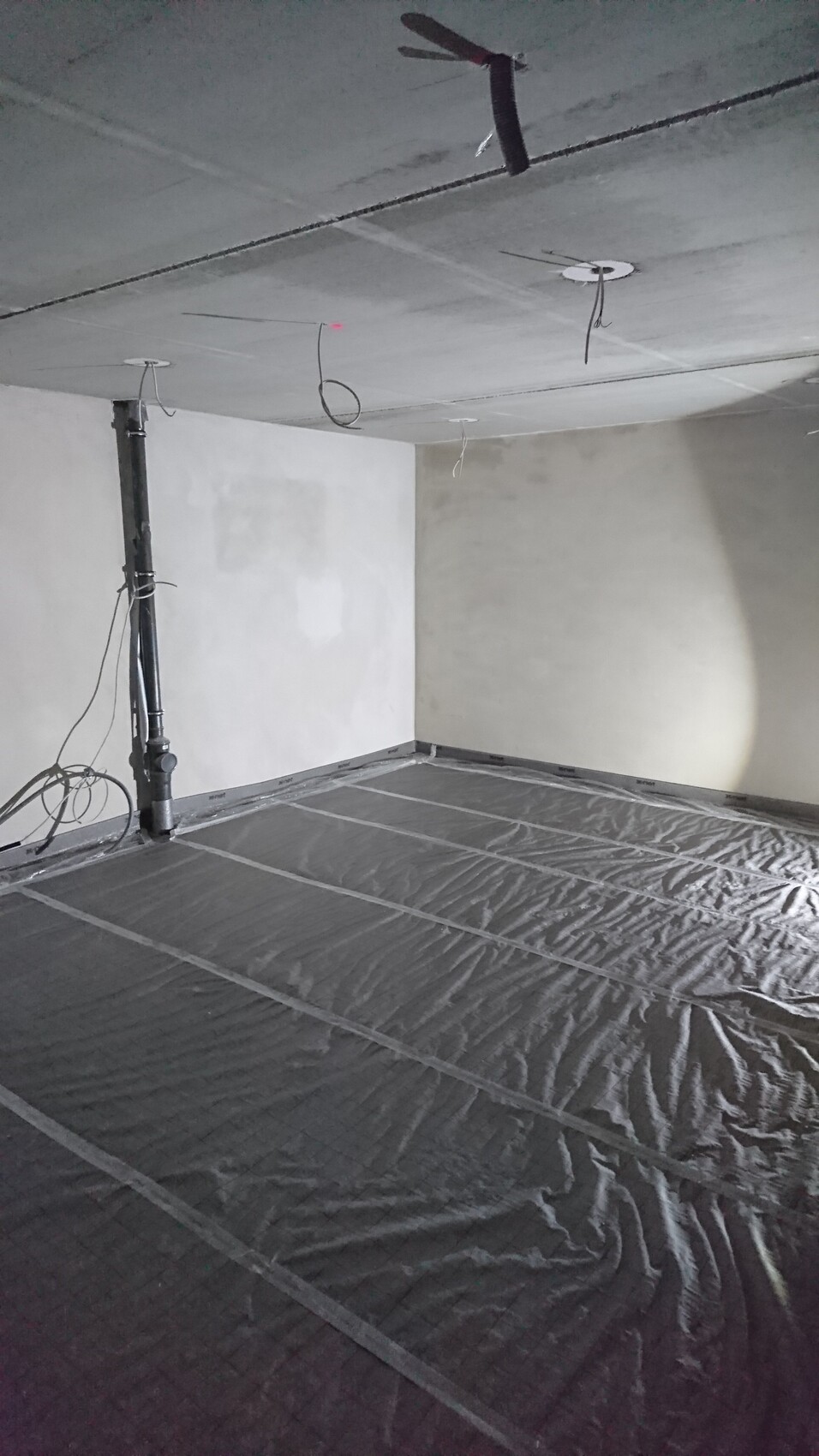

Grantlhaua7 Sep 2019 07:44Good morning everyone,
Yesterday we finished installing the insulation in the basement. Today we will work on the two upper floors, and we might even manage to lay the first heating loops in the basement.
PS: A tip for anyone planning to install insulation themselves (I don’t have many good ideas, but this one was actually not so bad ): Buy a few cans of marking spray paint from the hardware store and spray the water and electrical pipes accordingly. Then press the styrofoam onto the pipes. This way, you get an exact outline of the pipes, creating a clean cutting template.
