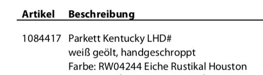

BauNoobie schrieb:
WOW! Great flooring!
What is the name of this floor covering, and how much does it cost per square meter? Please include a website link if it can be ordered online.
Good luckThank you
The parquet is from Wicanders.
Here is a photo of the engraved label.
In my case, the floor was glued down.
The official price is 67 euros per square meter (about 6.2 sq ft), offered at 54 euros, and after a lot of negotiating, I finally paid 50 euros.
