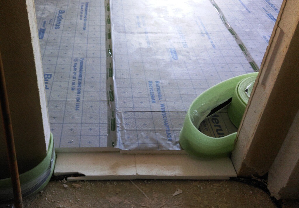

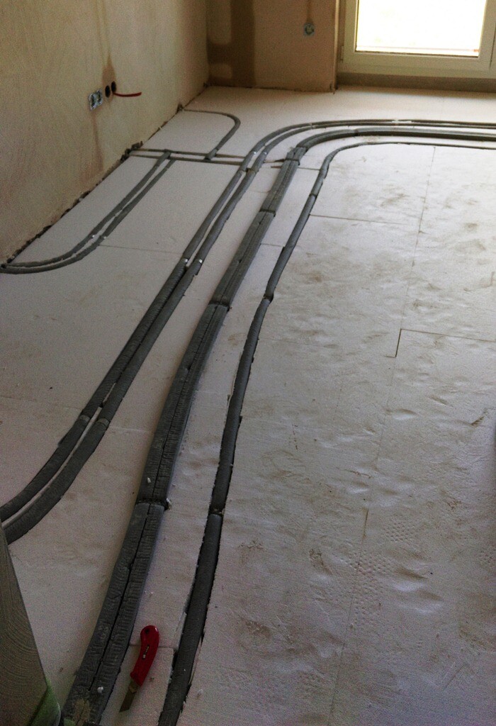

So, yesterday 11 hours on site... this morning I can feel every muscle in my body... I simply am not used to it anymore... but tonight we’ll continue.
We started on the upper floor because there was still some moisture on the ground floor from the plaster (but everything dried out yesterday).
Procedure for the upper floor:
  • Sweep (and vacuum if necessary)
  • One layer of EPS boards (30mm thick, 1m x 1m (1.2ft x 3.3ft)) on the concrete. This is the most work because all pipes need to be cut out.
  • Then the edge insulation strip is installed around the perimeter, fixed to the walls with a hammer stapler.
  • Next comes the “system board” on top. This is a membrane with another 30mm (1.2 inches) insulation layer underneath. It comes in sheets of 12m x 1m (39ft x 3.3ft) and is easier to lay because only the domestic water pipes (rectangular insulation) need to be cut out.
  • The membrane is then sealed by overlapping and sticking the seams.
  • Afterwards, the membrane is glued from the edge insulation strip onto the system board.
Here are pictures of a finished room (showing the two layers and the edge insulation strip) and a room with pipes and the bottom layer of EPS:

On the ground floor the same approach is used, except a 53mm (2.1 inches) PUR board (1.20m x 0.60m (3.9ft x 2ft)) is installed underneath first. This board needs to be cut around the pipes, then the other boards are placed on top.
Cutting around the water pipes or empty conduit pipes for cables is the most labor-intensive part everywhere.

Jochen1048 Jun 2015 09:17
Good morning,
we have now finished installing the insulation. Yes, it was quite enjoyable since it felt good to finally do some work on our house ourselves. However, we were all relieved once it was done.
The time investment was quite substantial. My father and I (both, in my opinion, skilled craftsmen), my wife (fortunately also somewhat talented), and two additional helpers on Saturday together spent about 110 hours. Short breaks for meals are not included.
However, from my point of view, we worked very thoroughly during this time and left the construction site wonderfully clean.
The work on the ground floor was actually easier since the PUR boards are the same thickness as the pipe insulation. However, especially in the utility room, there were significantly more pipes. For cutting the PUR boards, I would recommend using a jigsaw. It is much easier than using a utility knife.
We filled small gaps or empty spaces above the round insulated pipes with loose fill. One bag was more than enough for this.
The PUR boards were cut quite precisely, but it fit exactly. We still have about 2 m² (22 sq ft) of EPS boards and system boards each remaining, so the planning was good.
The edge insulation strips were a bit too few and were unfortunately stapled incorrectly over a few meters (with the adhesive film facing up), damaging the film. Therefore, we had to get additional supplies from company L. in N. This was offered to us in advance and worked perfectly.
