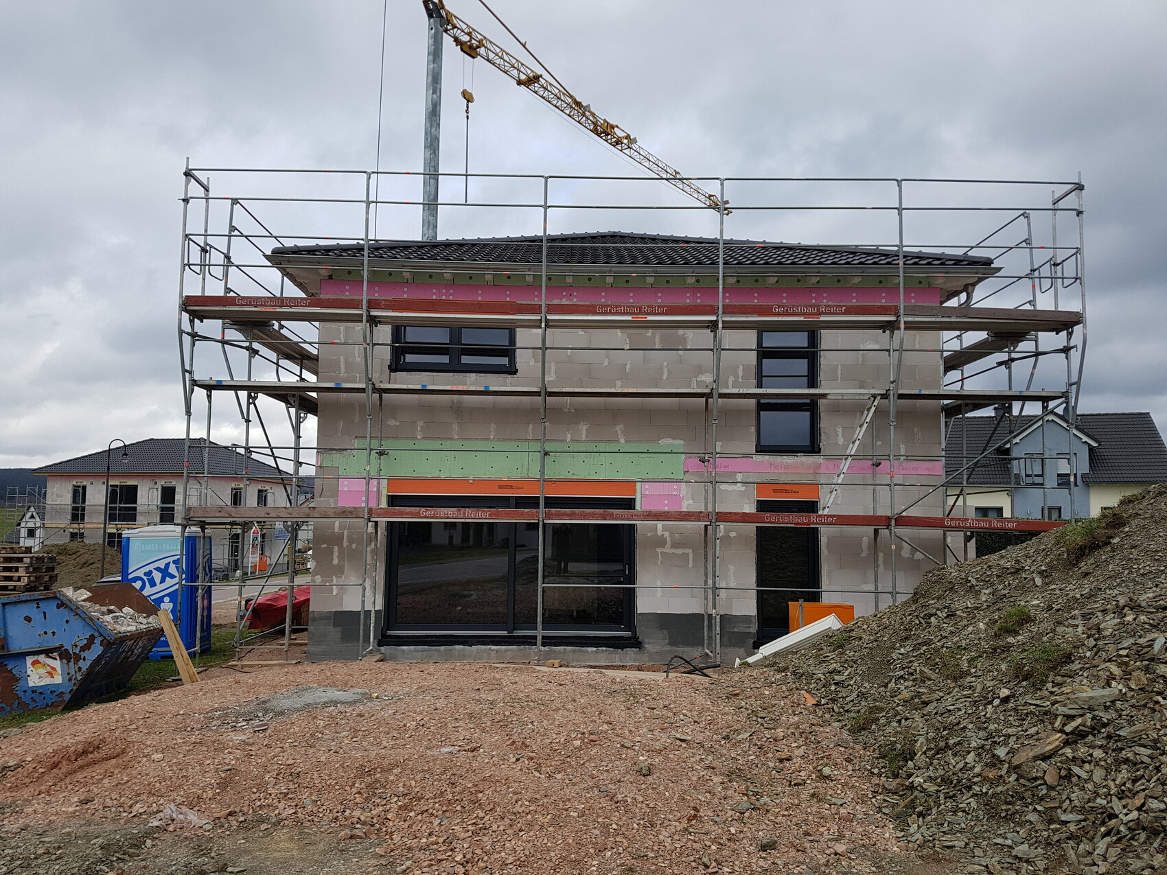

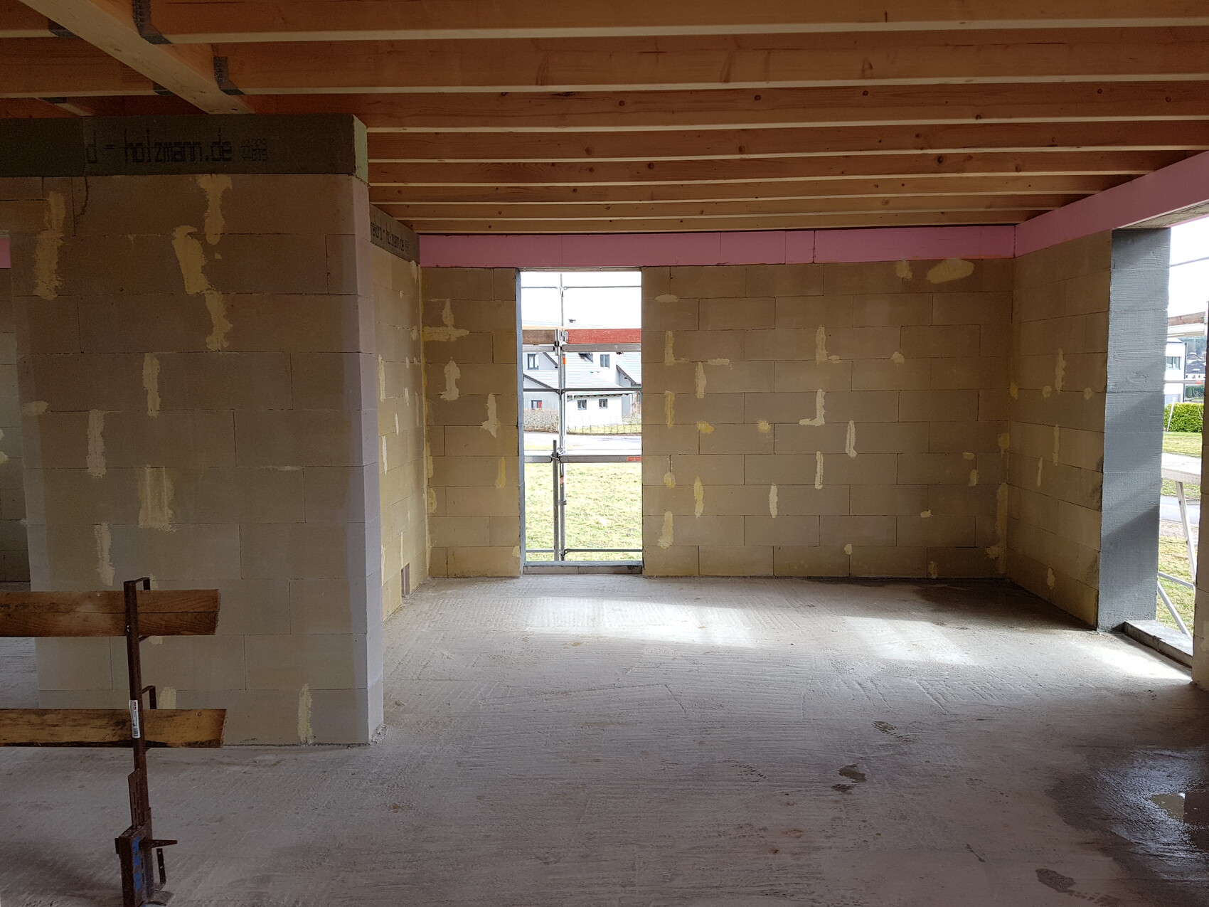

CrazyChris8 Mar 2020 15:24A quick update: The roof is on, and the windows are installed. Unfortunately, everything was significantly delayed, which has caused the shell to become quite damp by now. So, the priority is to let it dry and wait. The photovoltaic system will be installed tomorrow.
The peeling barrier is also applied to the walls. It’s a nasty substance. I strongly recommend wearing a full-body suit. Definitely apply it before the windows are installed! Otherwise, just roll it on without worrying too much and use a paste brush for the corners. It took about 1.5 days to finish. Approximately 350 square meters (3,767 square feet) of wall area. I was glad that the bathrooms, utility room, and garage are getting the lime plaster. Poor back of mine...
