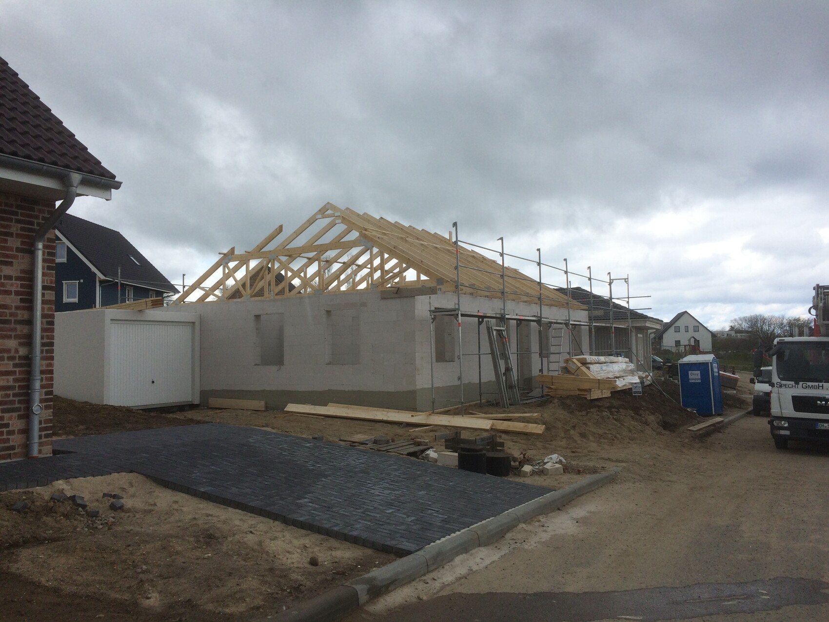

The insulation is correct. Was the concrete foundation possibly not properly sealed against rising moisture with a bituminous membrane? Also extending slightly up the wall. And was the exterior wall coated at the bottom with waterproof slurry? In one of the photos, you can see moisture creeping into the stone before the bitumen waterproofing. That stopped afterward. The gray waterproof slurry helped as well.

Baustelle mit zwei Fensterrahmen, Leiter, Werkzeugkasten und Korb; Schatten der Holzbalken.
Wohnhaus-Rohbau mit Holz-Dachstuhl, Gerüst und Baumaterialien.
