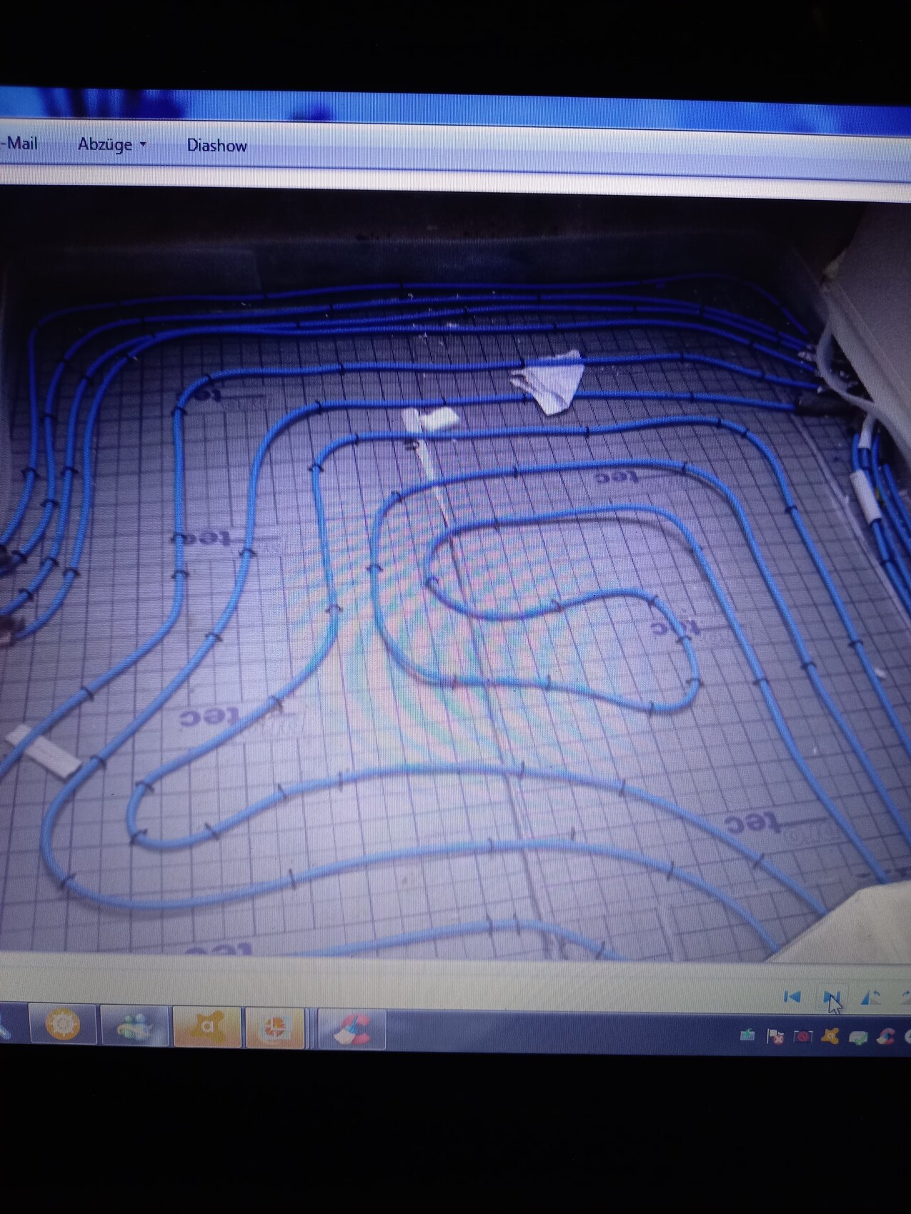

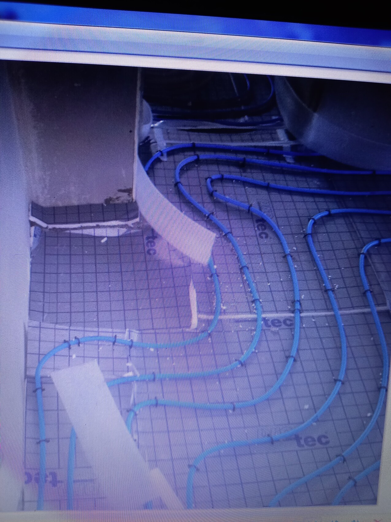

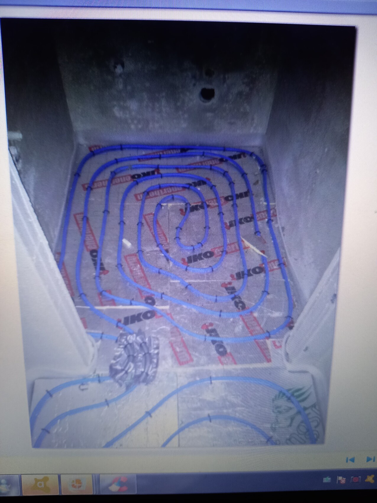

Hello, during our new build in 2017, I only just noticed in the photos that the insulation boards in the floor structure were not bonded (sealed) together. The edge insulation strip was also not sealed to the insulation boards. The underfloor heating pipes were seemingly “stapled” directly in place, and then the liquid screed was poured.
Now we possibly have hidden mold within the floor construction.
Who is responsible for inspections and any further necessary actions?
Thank you

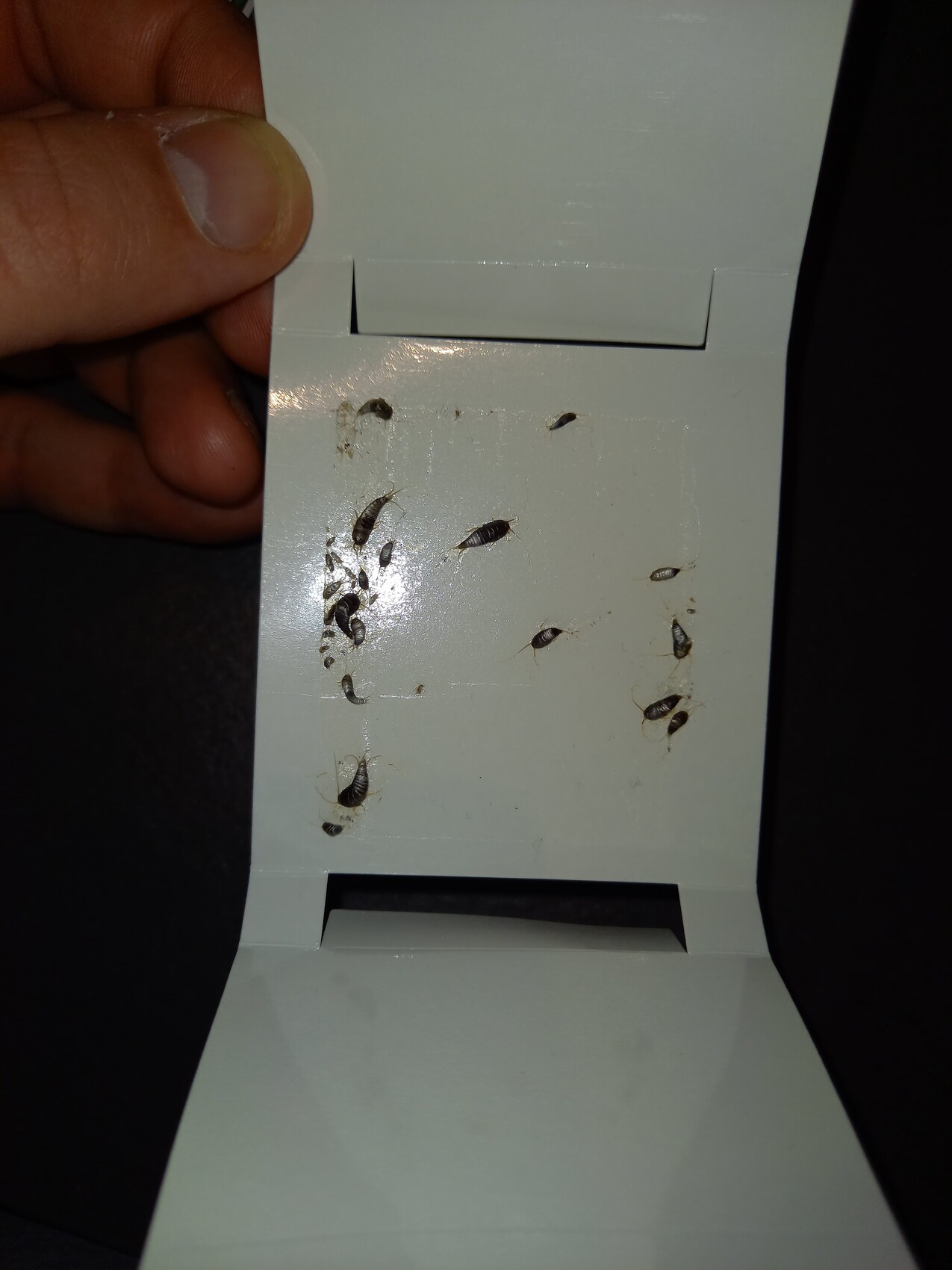

B.Beat
18 Mar 2021 23:41
Close-up: Hand holding a light blue plastic piece with many tiny black insects.
I think these are silverfish and not firebrats, right?
NatureSys
19 Mar 2021 07:50
I believe it is more likely silverfish. Paperfish have a very elongated body and are less wide.
