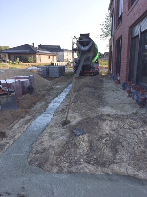

This is about pictures here:
Concrete for strip foundation of the terrace wall.

What was complex for us were the three lift-and-slide windows also on the upper floor, around the corner, with blinds, laminated safety glass (VSG), and glass balustrades.
Conclusion:
The raised terrace should have been built in this form right away with the shell construction; the general contractor didn’t want to at the time, suggesting to have it done by a landscaping company instead. In hindsight, it would have made much more sense.
