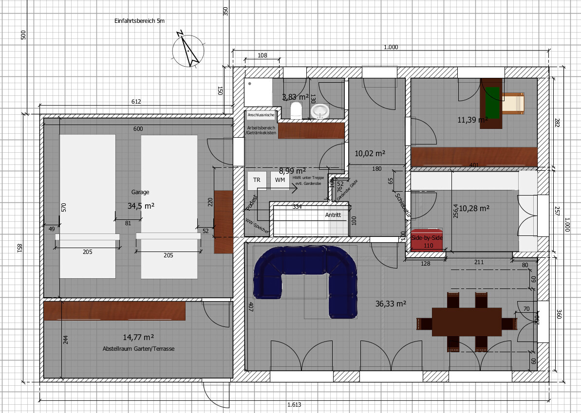

GrymWe have now had several in-depth discussions since the idea of using the space under the stairs as an extension of the utility room and the idea of a direct passage to the garage have developed. Here are the findings, which are basically close to the design that one construction company now wants to finalize and price:
We have now seen the garage passage into the utility room in two private houses (one belonging to acquaintances), and it seems very practical, so we want that. The staircase is closed and basically asymmetrical. It goes up about 9 steps, then a landing, then another 6 steps. Including the landing, that totals 16 steps, or 17 risers. At the second rise, a step can easily be added or removed as needed.

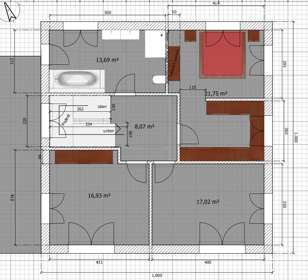

My thoughts on individual rooms:
- Both children's rooms are rectangular and about 17 sqm (183 sq ft). The closet niche in the left children’s room does not seem like a limitation to me. I consider these two spacious children’s rooms, also suitable for teenagers; both have south and garden-facing windows.
-> Children's rooms: OK or not?
- The bedroom is wide enough, with a sufficiently wide passage at the bottom, east-facing; the walk-in closet has over 7 linear meters (23 feet) of shelving and an interior movement space of 1.20m (4 feet) in width.
-> Bedroom/walk-in closet: OK or not?
- The bathroom size basically results from the leftover space. I don’t like small bathrooms or toilets directly next to the bathtub. We want double sinks. We do not want a separate children’s bathroom.
-> Bathroom possibly too large for some tastes but otherwise OK or not?

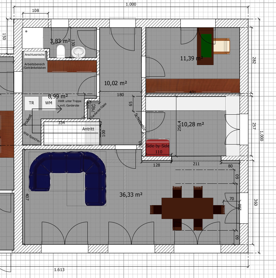

- We want an open living/dining/kitchen area arranged at a corner. I have seen 4.07m (13 feet) for the living area live at acquaintances and found it good; 3.60m (12 feet) for the dining area with a 90-100cm (35-39 inch) table should fit well. The kitchen includes 6 linear meters (20 feet) of cabinets plus a large separate fridge and freezer. A sliding door is planned to avoid hitting anyone when opening; generally, both the kitchen and living room doors are planned to be open and only closed when needed. This is also how we do it at home.
-> Living/dining/kitchen: OK or not?
- The hallway is now 1.80m (6 feet) wide. We have seen 2.00m (6.5 feet) (very generous; wasteful?), 1.30m (4 feet) in a semi-detached house (functional, works but not impressive), and 1.40-1.50m (4.5-5 feet) in show homes (neutral impression). The coat niche is planned with hangers perpendicular to the hallway direction for jackets, etc. Possibly, another wardrobe will be added in the utility/transfer room to the garage because it is used frequently. Larger shoe storage will also be in the utility room, but some pairs (for me only one, for my wife a few) can remain in the hallway (e.g., between the WC door and utility room door or between the workroom door and the exterior wall or in the coat niche). The WC is planned with a shower mainly for visual reasons, though it will be used occasionally. At 2.5-3.0 sqm (27-32 sq ft), it’s visually too small for a stay room (even if one only spends a few minutes there). The work area in front of the connection niche is partly a passage area and partly for storing drink crates, which can be moved when needed. Next to this is about 2 linear meters (6.5 feet) of additional cabinetry; opposite are the washing machine and dryer under the stairs. The hot water tank could possibly be placed in the rear corner of the utility room since it normally does not require access. (The landing is at the 10th step; the height under the landing and the height of the hot water tank must be calculated and planned in detail.) Or would another necessary technical device be suitable there? If not, that space can remain unused. Next to the washing machine and dryer, there is at least 1.20m (4 feet) available for other appliances or the mentioned second wardrobe. If necessary, the approx. 2 linear meters (6.5 feet) of cabinets will have to be replaced by essential technical equipment, but there aren’t that many devices after all.
-> Hallway, utility room, WC/shower: OK or not?
- There is also a study room, let’s call it the PC room. It houses the computer, some cabinets, and additional storage primarily for documents.
-> Study room: OK?

Bieber081519 Aug 2015 22:05I would make the kitchen open, without a door between the kitchen and the hallway, and instead include an island.
The study could be a bit smaller in favor of the hallway... Just an idea.
Do you need the shower on the ground floor? There might be potential there as well.
Conclusion: Overall good at first glance, except for the corridor, which feels narrow and tunnel-like (still 180 cm wide (71 inches)... compare it to existing houses, maybe that’s just nitpicking, I’m not sure...).
Edit: Good question, should the heating be placed behind the washing machine? If that even fits...

In a private house of a home seller, we noticed the following: the couch is positioned as shown in the picture above, with the TV in the bottom left corner. We don’t actually watch that much TV, but occasionally, of course. However, we make sure the TV is never on when our daughter is present (6 months old), so right now, screen time until around 8 p.m. is basically off the table anyway.
You could also turn the couch around to face the wall, and you are right about that. I would recommend having TV outlets and enough power sockets on both sides, or maybe even on three sides. Also, a cable duct would be useful.
There is a coat rack area (meaning we would install a rod with hangers) just before the stairs begin. The rest of the wardrobe—an idea again taken from a real, lived-in private house—would preferably be more like a utility room area rather than just a passageway to the car (or even as a passageway to the bikes).
The interior furnishings are not complete; the cabinets shown are more for illustration. In planning terms, this is often referred to as space allocation proof. Regarding the cabinet issue, it will probably be necessary to rotate the couch 180 degrees. The window front towards the garden might be a bit too large; it might end up being just two large lift-and-slide doors, which would leave space in the middle.

The heating system can be placed next to the washing machine on the right/east side. I haven’t yet considered installing the heating under the platform. Some technical equipment might even be located in the garage, which will be an insulated timber frame construction and therefore frost-free. For example, some acquaintances had their entire electrical connection box, meter, and fuse box in the garage. The detailed planning isn’t that far yet. If it’s just a gas boiler, it might fit in the utility niche.
We don’t necessarily need the shower, but by now we have seen many bathrooms both with and without a shower. A shower definitely creates a better sense of space, and if things ever need to be quick, two people can shower at the same time.
The hallway is rather spacious, I would say. There is no staircase there, which shouldn’t be forgotten, and the actual width is 1.80 m (5 ft 11 in). We recently saw a house with a 2.00 m (6 ft 7 in) wide hallway, which felt more like a palace entrance in terms of space. Shoes—those used frequently and also for guests—can be stored, for example, between the exterior door and the outer wall (behind the entrance door) or between the bathroom door and the utility room door. Most entrance halls I know are around 1.40 to 1.50 m (4 ft 7 in to 4 ft 11 in) wide. The Potsdam city villa by Kampa in the Chemnitz model home park has a hallway width of 1.40 m (4 ft 7 in); there’s even a video available online on YouTube. Even this 1.40 m (4 ft 7 in) width (if the online floor plan is to scale) seems good and spacious to me.
