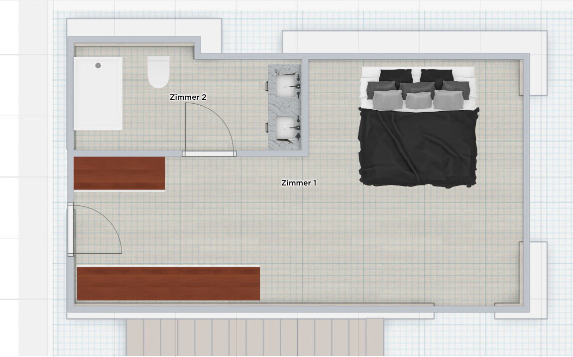

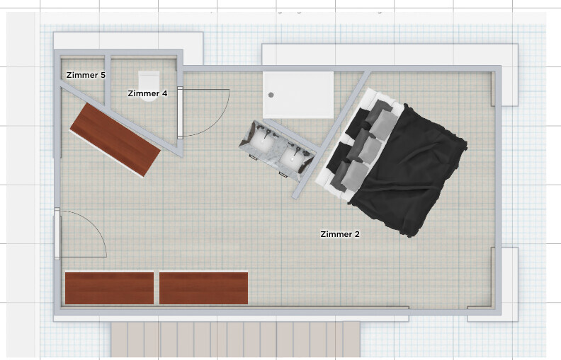

Just a quick draft, sometimes a bit different than boring 😉 , done on the computer:
Other bedrooms can be relevant for the placement of the bed.
For the window placement, the other windows matter—here mainly the external views.
derdietmar21 Sep 2021 20:38Hello,
Thanks for the suggestions. The first one is already somewhat in line with our plans. The second one is probably not quite our style 😉 but at least it’s thinking outside the box – thanks for that!

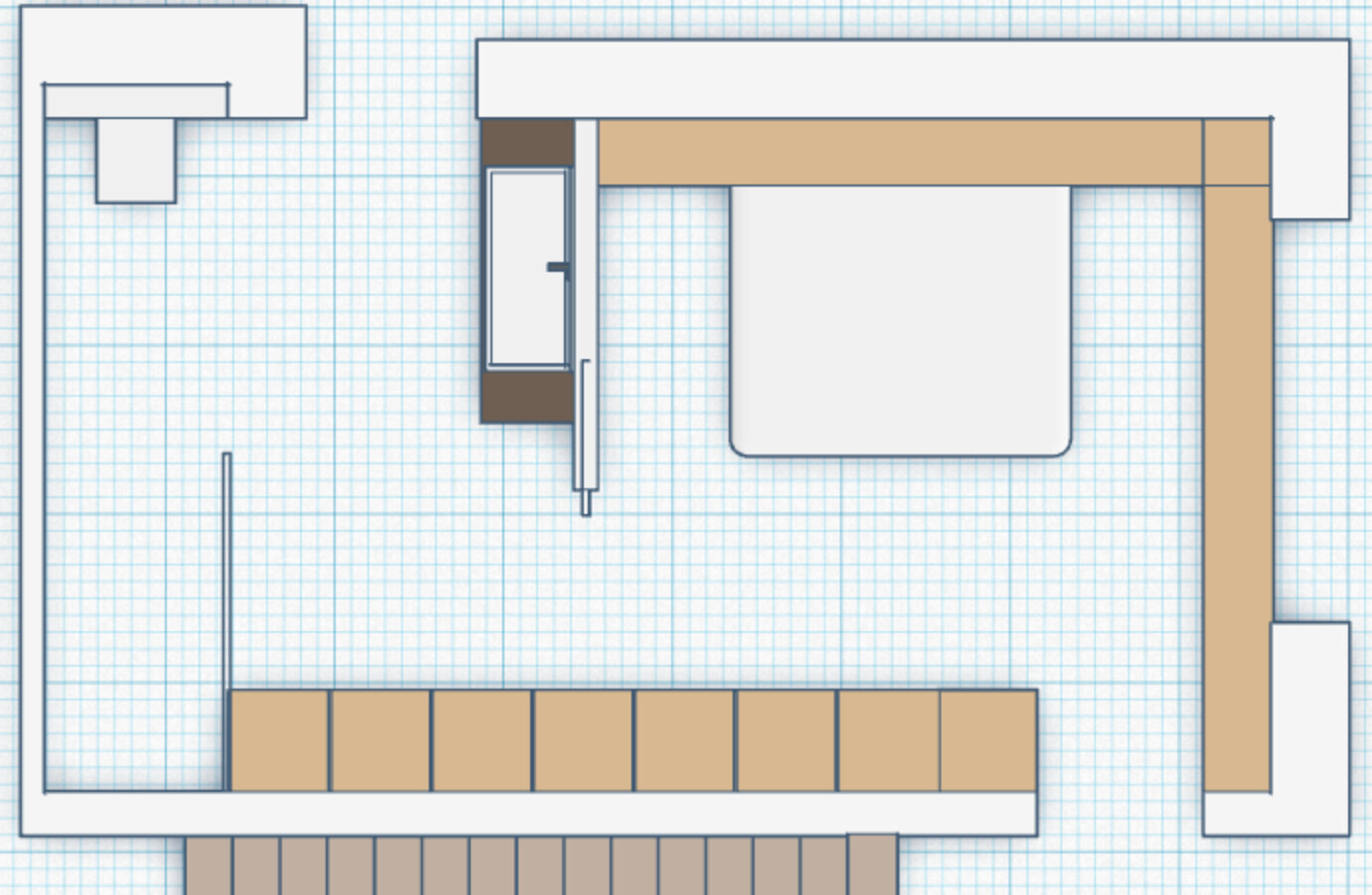

Here is the current planning status:

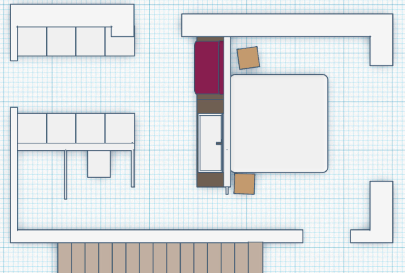

And a version with a separately lockable shower room including a toilet:
