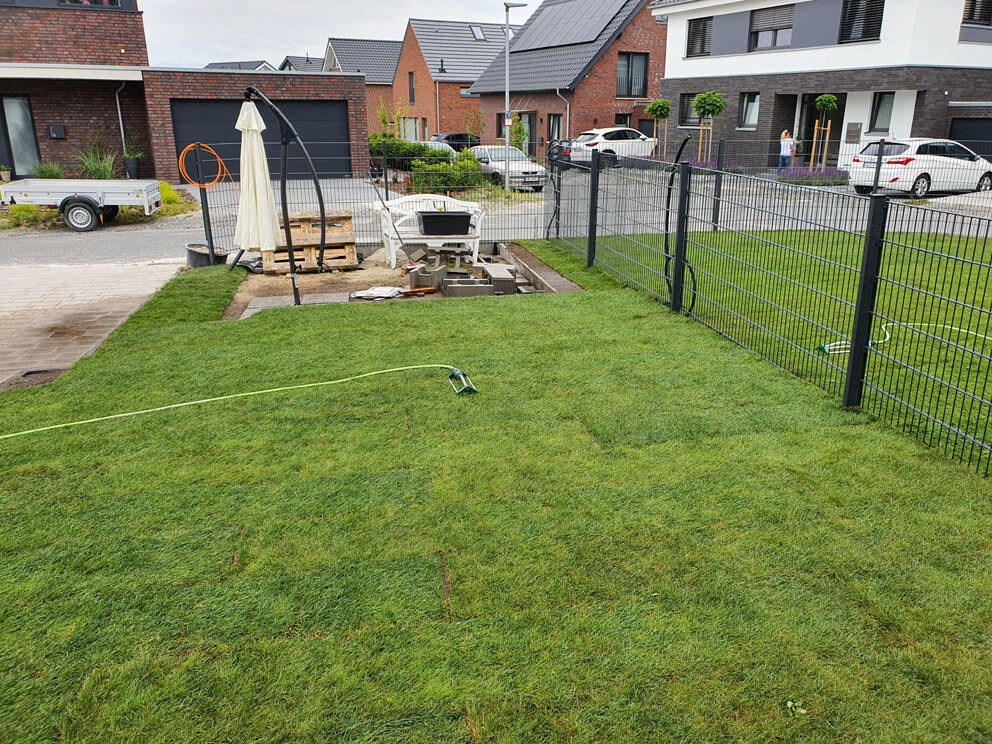

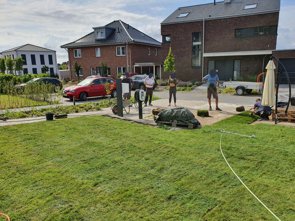

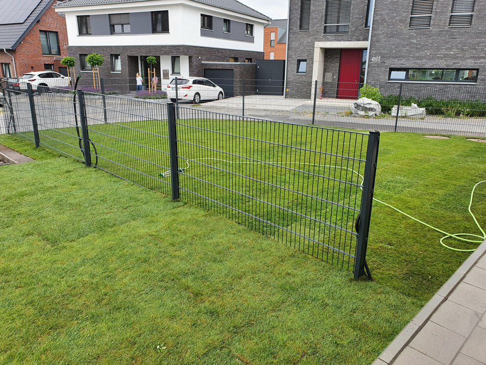

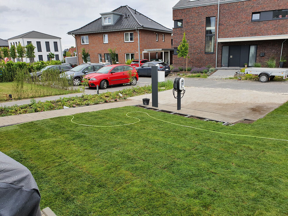

Finally, the gray-brown desert is gone. One morning and 160m2 (1,722 sq ft) of rolled turf laid in both gardens (had it laid 😉)
Still missing are a small gate, my wooden terrace, the yew hedge starting in August, and a few more colorful plants.
Three minutes after finishing the work, I posted the remaining 5m2 (54 sq ft) of rolled turf on eBay Classifieds.
And 10 minutes later, it was already gone, including the 4 single-use pallets.

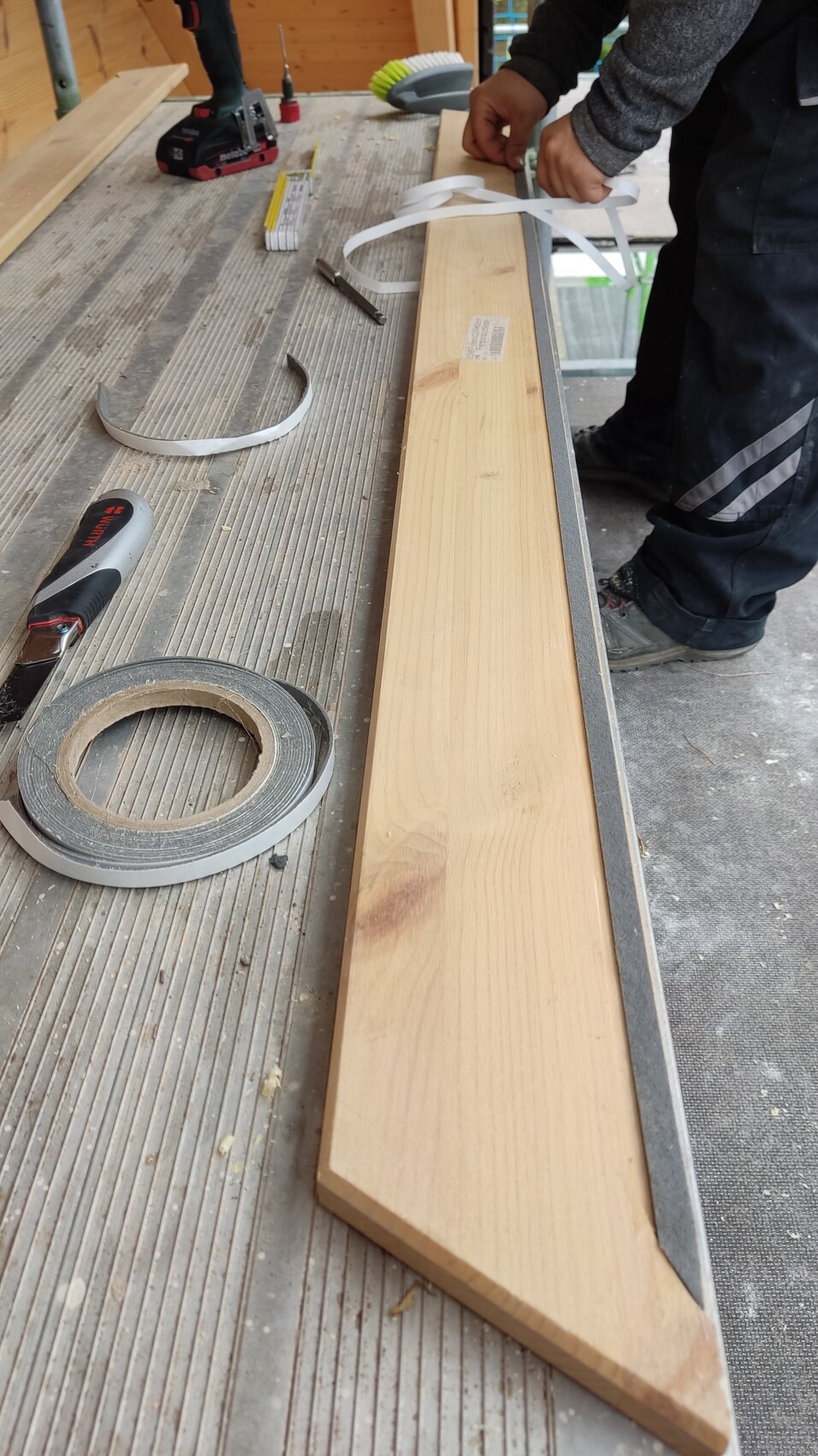

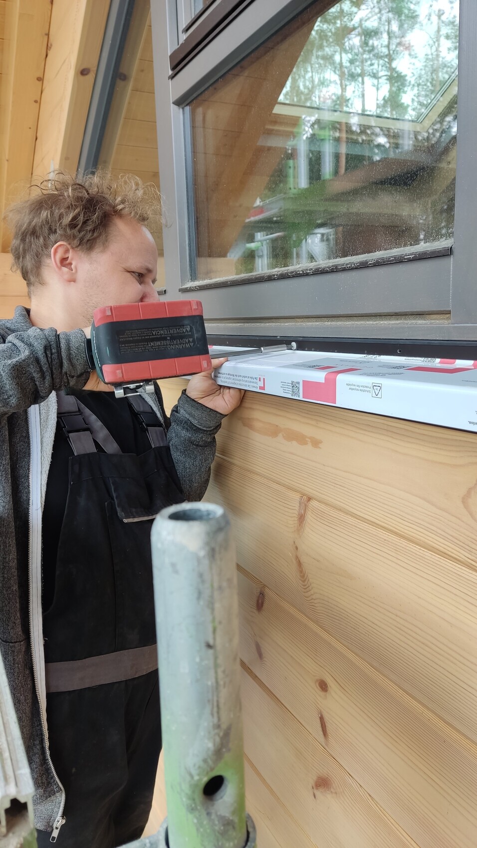

Preparing the window sills; a rubber strip goes on the back, sealing strips on the sides, and compriband attached to those.

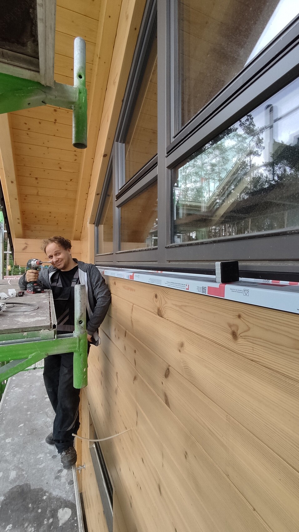

Then position them
Screw them securely in place

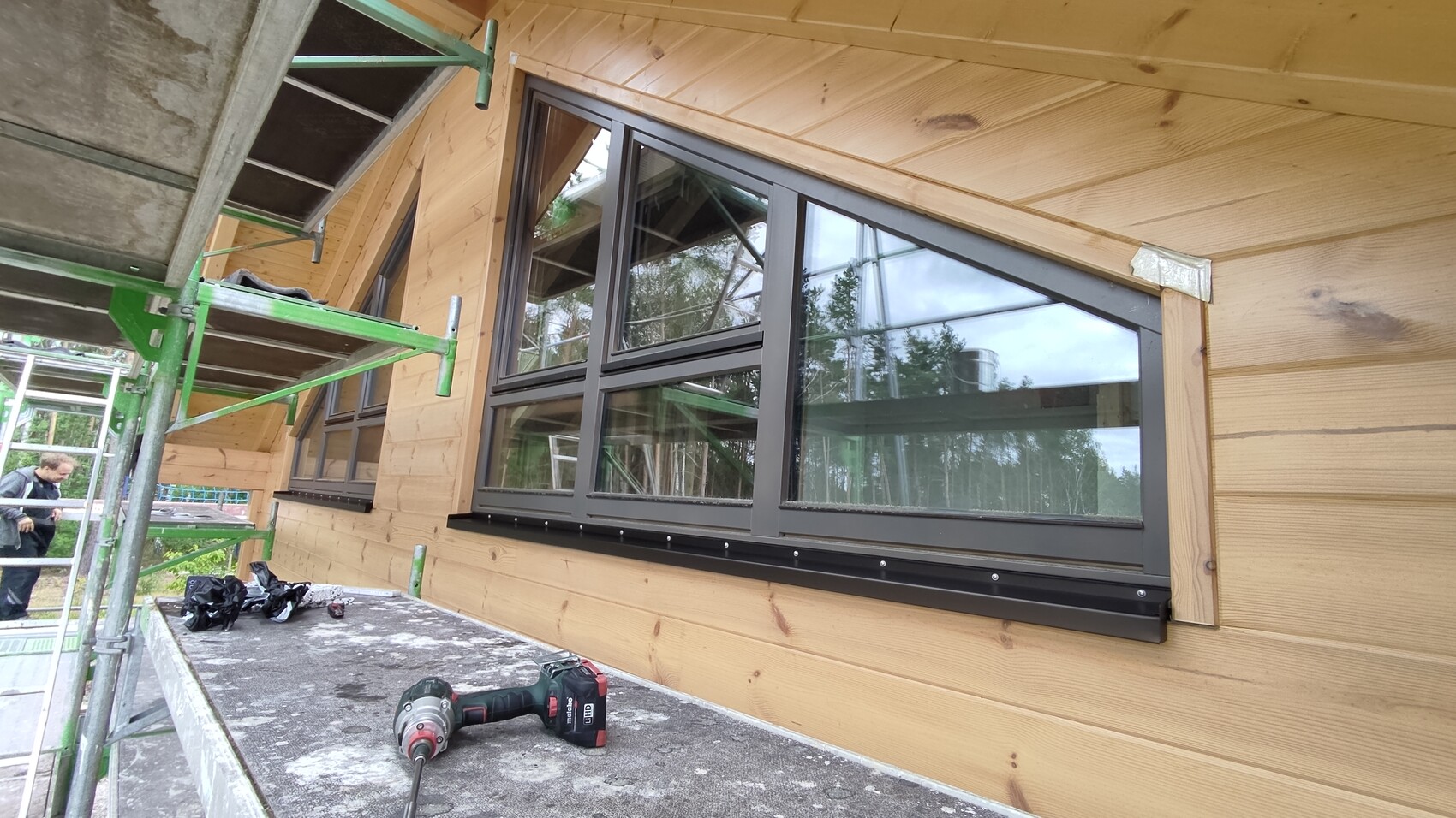

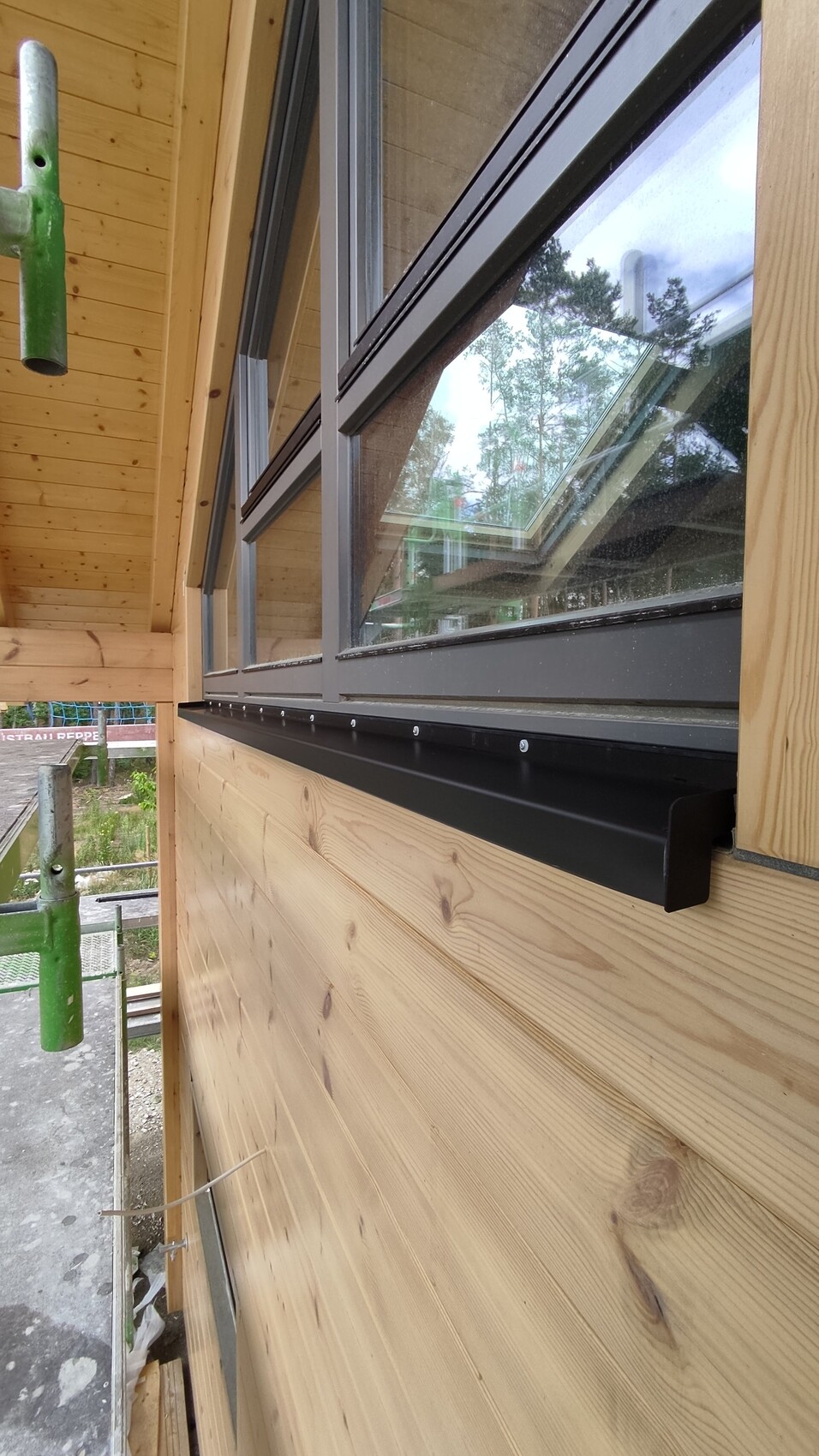

Et voilà. Caps will still be added to the white parts, but unfortunately they were delivered in a disgusting brown instead of black...
And both of them
The house with window sills you can barely see because the scaffolding is still in front ^^

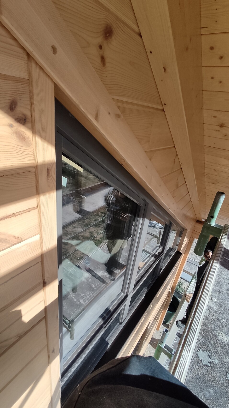

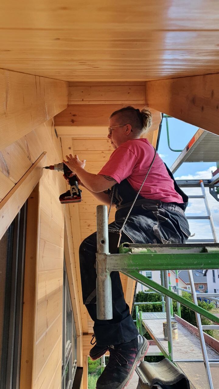

And then the lintels. These are also impregnated, glazed, and waxed. We pre-drill with a Forstner bit and then cover the drill holes with matching caps. Compriband is applied on the back.
And then install them
Ta-da!
