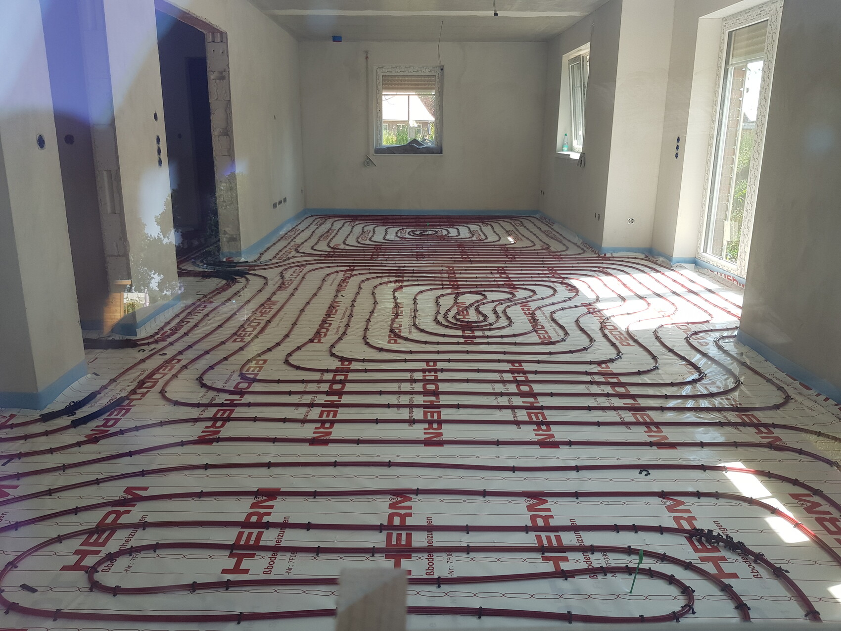

kati1337 schrieb:
Here I’m showing you our snakes. These are the only snakes I like.
We’ve had them since this week.
More photos on the blog.
Isn’t the installation spacing extremely large and uneven? What kind of supply line is planned?
hd45899 schrieb:
Isn’t the installation spacing extremely wide and uneven?
What supply temperature is planned? A supply temperature of 35°C (95°F) is planned.
I didn’t think it looked uneven on site. The photo was taken with a phone camera through a window, from one side of an entire 11m (36 feet) long room, so I don’t think it’s fully representative.
I can’t say if the spacing is too wide because I’m not the heating installer. But I have thermostats on the wall where I can set the temperature, and I know what the builder promised me. Honestly, I can’t imagine that for nearly 400 houses per year—almost all built with underfloor heating—they would work with a subcontractor who delivers poor work, without any homeowners complaining.
Tarnari schrieb:
That is basically correct.
However, it is probably very often installed following the principle of "we have always done it this way."
I asked very critically about this in our area. That is of course true. We quickly end up back on the meta-level on which our entire choice of builder is based. Due to our lack of technical knowledge, we selected the builder almost entirely based on reputation. They are not the cheapest, but so far everything has gone quite smoothly, and any minor issues were resolved immediately. I cannot imagine that they would choose a subcontractor for the underfloor heating who could damage their reputation, especially considering the number of houses they build. They probably always work with the same ones.
According to their quote, the underfloor heating was also installed not according to a fixed pattern but based on a personalized heat load calculation. I don’t feel qualified to judge, as countless factors come into play, right?
We will see. The screed will be laid over it by the end of the week anyway, so no use dwelling on it now.
