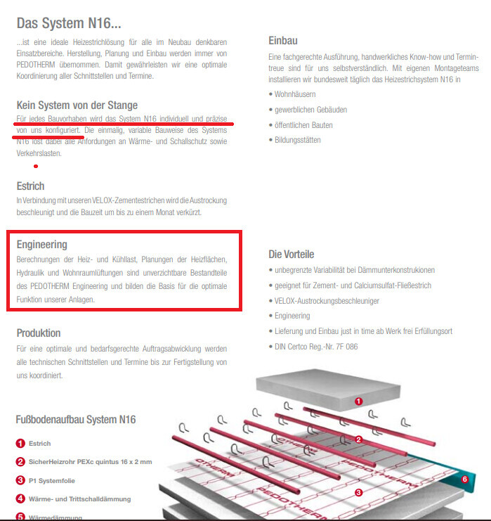

A supply temperature of 35° is planned.
I didn’t think it looked uneven on site. The photo was taken with a phone camera through a window, from one side of an entire 11m (36 feet) long room. So I don’t think it’s fully representative.
I can’t say whether they are spaced too far apart, I’m not the heating installer. But I have thermostats on the wall where I can adjust the temperature, and I know what the builder assured me. Honestly, I can’t imagine that with almost 400 houses per year, nearly all with underfloor heating, they would work with a subcontractor who does a poor job, and then no homeowners would complain. I’d like to pick this up briefly again. Not because I want to claim something was done wrong or anything like that. Whether you follow advice or tips is your choice, but maybe some people reading this are still in the planning phase and would appreciate thinking about these things in advance.

The intention is welcome, and I appreciate the input, but I have already mentioned several times that this is not a standard design with a 35°C (95°F) supply temperature. I have also attached the relevant contractual documents.
Aside from that, in the worst case, we will suffer efficiency loss, not insufficient heating, since our system can also handle higher supply temperatures. I could only criticize it if it wasn’t sufficiently warm with a 35°C (95°F) supply temperature, as we pay the contractors specifically to design it accordingly.
