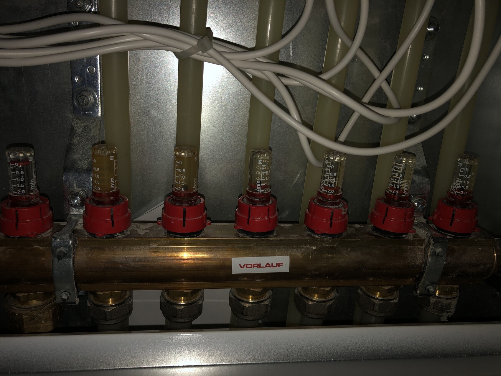

M4rvin
Hi, a brief update...
Since I lowered the heating curve to 0.4 and set the thermostats to max, the heat pump has been running continuously. The flow valves were fully opened everywhere. (Some don’t go lower than 1.5; I tried to manually open them further.)
The average temperature has risen by about 1 degree everywhere. On the ground floor around 21.8°C (71°F), on the upper floor slightly over 22°C (72°F), and in the bathroom 23°C (73°F). Current outside temperature is 3°C (37°F).
Should I take any action now to cool the house down? Or should I wait because of thermal inertia?
By the way, I also noticed that after I set the radiator in the bathroom to 5, nothing happens; the flow is at 0.
Take a look at a heating curve diagram.
A slope of 0.4 means that at an outdoor temperature of 3°C (37°F), the supply temperature is already around 34–35°C (93–95°F). That’s already pleasantly warm for your feet...
For a modern underfloor heating system, that should be the endpoint, not the supply temperature at 3°C (37°F) outside.
The endpoint at a slope of 0.4 and a standard outdoor temperature of -15°C (5°F) is over 40°C (104°F) supply temperature!
0.25 is the starting point with an endpoint of about 35°C (95°F) supply temperature. The underfloor heating system should be designed for this.
You’d rather want less, for example, an endpoint of 30°C (86°F). This saves real money on energy consumption.
The house will continue to warm up since it’s only been running for a few hours.
But you can already tell what kind of energy the heat pump is pushing into the underfloor heating system without being fully utilized because the energy recovery regulator (ERR) cuts back. Completely pointless. First, the water is heated properly, only to be dripped into the heating circuit. It just doesn’t make sense.
