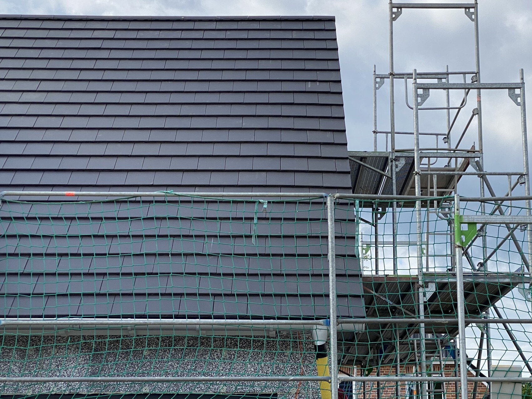

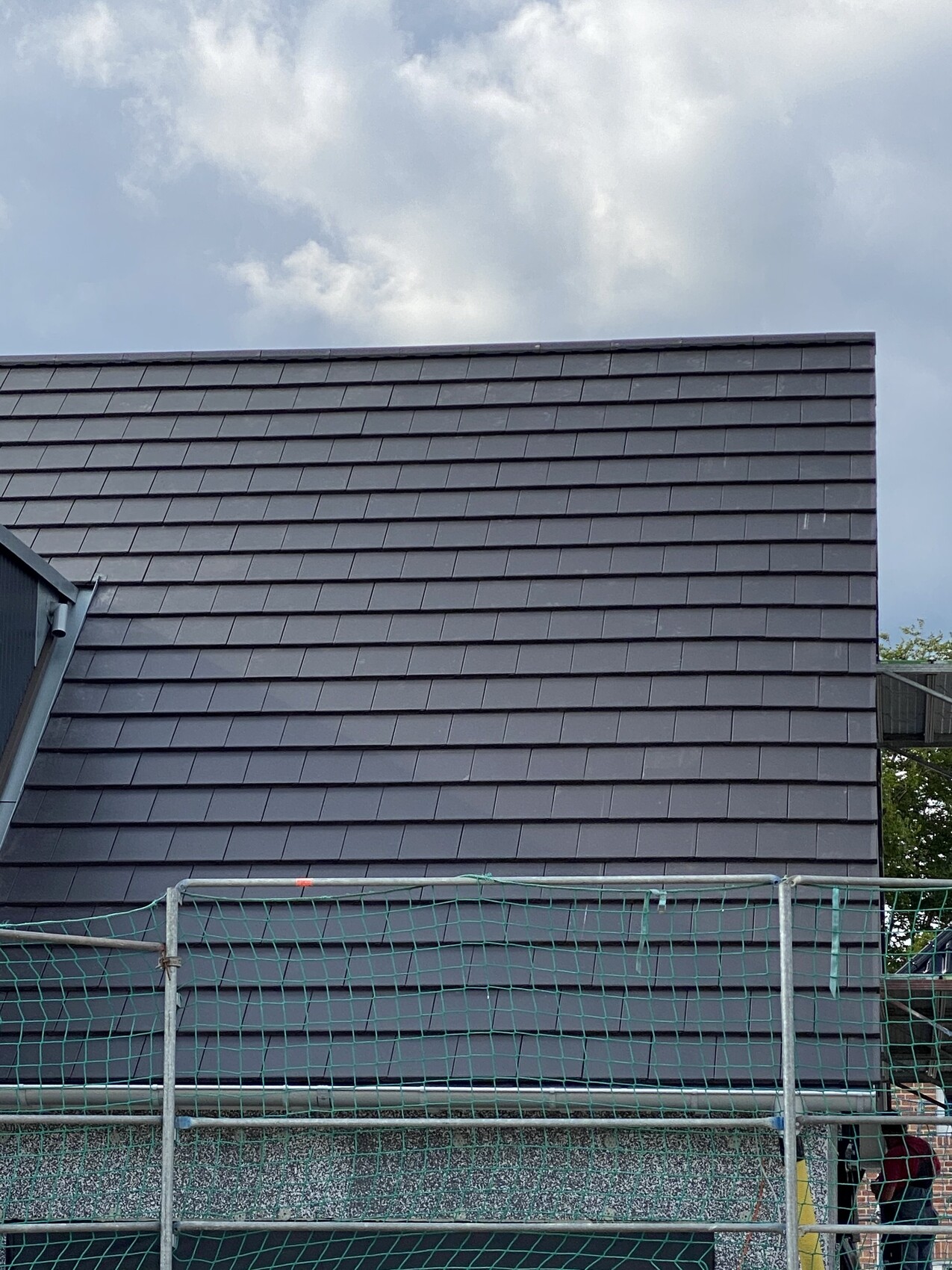

Our house frame was set up last Wednesday/Thursday, and the roof was covered yesterday. Everything went smoothly, and the weather was favorable.
Maybe someone can say something about the roof tiles in the lower half near the gable. To me, it looks like they are sagging or slightly "drooping." It could also be that it is very difficult to lay the Tegalit tiles perfectly straight, and this is just how it turned out.
knalltüte11 Jun 2020 19:11So, the 6th and 7th tiles in the bottom row (from the right) are bulging. The gap between the tiles is noticeably narrower at the bottom than at the top. Definitely about a 1.5cm (0.6 inch) variation? However, this cannot be seen in the picture with the counter-battening. Why is it there?
Maybe try lifting these two tiles to take a closer look?
If it’s crooked at the bottom, of course, it’s also crooked at the top.
For me, this is unacceptable (under no circumstances). It definitely needs to be corrected. I also can’t imagine the site manager saw this and approved it. They must expect resistance.
