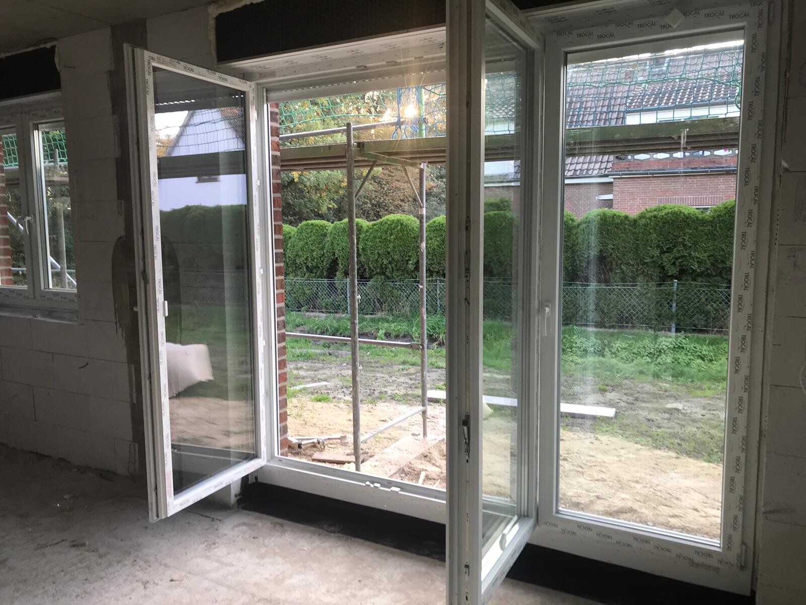

Our scaffolding has been taken down, and we’re very happy about that. In the panoramic photo, you can’t see it clearly, so please tell us: how exactly did you solve the issue with the triple patio door?
kaho674 schrieb:
Wow, I hadn’t heard anything about the arches until now. Me neither, but they are actually segmental arches, and very subtle ones at that — I still would have preferred if the windows had matched the arches.
We decided to have the patio door installed as a lift-and-slide door. This would have added about €3000 net to the cost, which we didn’t think was worth it.
From the inside, the two left panels can be fully opened as a French door configuration. The third panel on the far left is a standard additional door.
I was skeptical about this choice at first. Now I have to admit that I really like it, and especially so do we.
