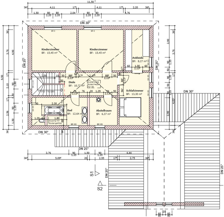

@jucre45 I really like your style. Is there a floor plan available, or is it meant to be a secret? Thank you very much. The floor plans are not secret, but somewhat plain.
Some details are no longer accurate, for example the layout of the bathrooms and the sliding door in the vestibule.
jucre45 schrieb:
Thank you very much. Floor plans are not confidential, but quite ordinary. Some things are outdated, for example, the layout of the bathrooms and the sliding door in the entrance area.I like it a lot!
Bookstar schrieb:
Is this timber frame construction? Was the question directed at me? If so, it is masonry, built stone on stone.
I really like it! How can you like that?
I want to see the bed in the bedroom with a width of 2.2 m (7.2 ft).
The bathroom is 2.56 m (8.4 ft) wide, minus the shower wall and bathtub—how wide is the passage?
Then the entrance: where do you put clothes? There isn’t even space for a shoe rack.
Huge house but in some areas it’s problematic.
