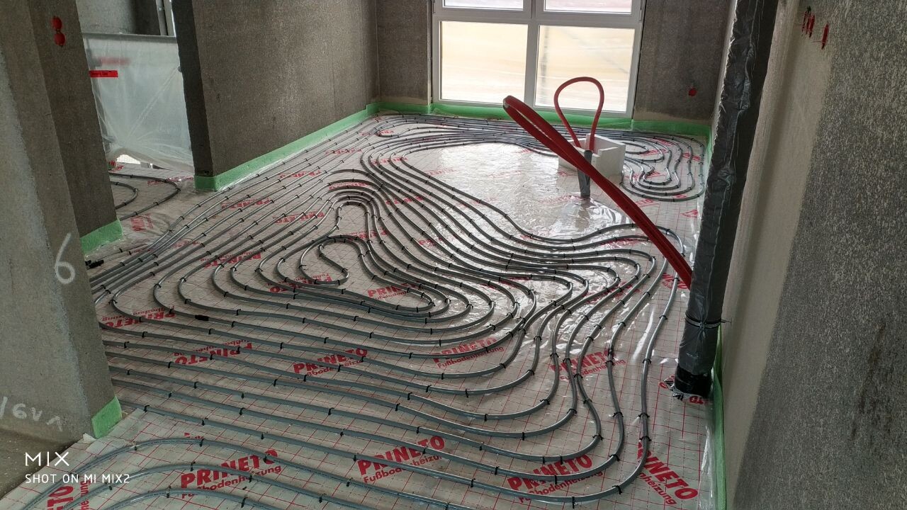

berny schrieb:
has been corrected...Aha (?) – what exactly was corrected, and what do the large red loops indicate? Is the island in the network of pipes a basin that is tilted like that?
Mastermind19 Apr 2018 20:52berny schrieb:
Underfloor heating in the bathroom has been adjusted...
Is that one heating circuit, or are there two circuits? For a single circuit, the critical 100 meters (330 feet) might have been exceeded...@11ant: They were missing 66 meters (216 feet) of underfloor heating pipe... discovered during an inspection by the Building Owners' Protection Association. I’m so glad to have them! The large red loops are water pipes, which will be separated later to prevent dirt entry and such... and yes, the bathtub will be placed in the "island in the sea of pipes."
@ Mastermind1: There are three heating circuits, now calculated with a total pipe length of 248 meters (814 feet).
