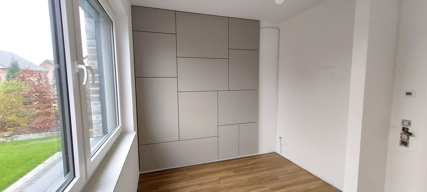

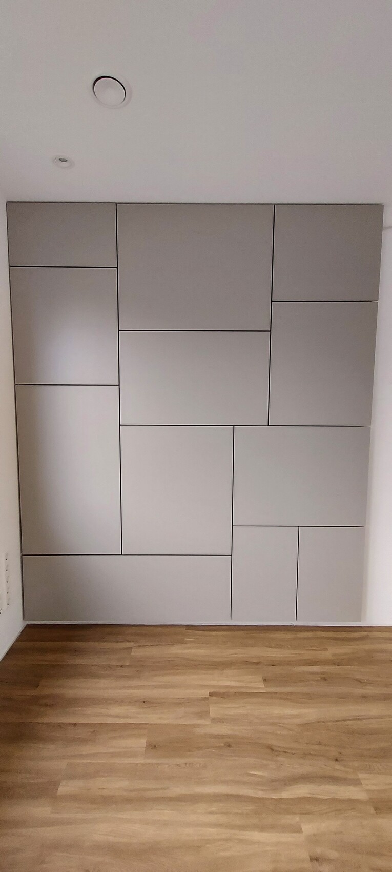

Home office project has started :-).
Wall cladding with a different approach.
Decorative coated 19mm (3/4 inch) chipboard panels arranged in a custom-designed pattern.
Mounted on Z-profiles fixed to the wall and removable at any time.
Modern interior with gray paneled wall, wooden floor, and window overlooking the garden.
Bright room with gray wall cladding made of rectangular panels of various sizes over wooden flooring.
