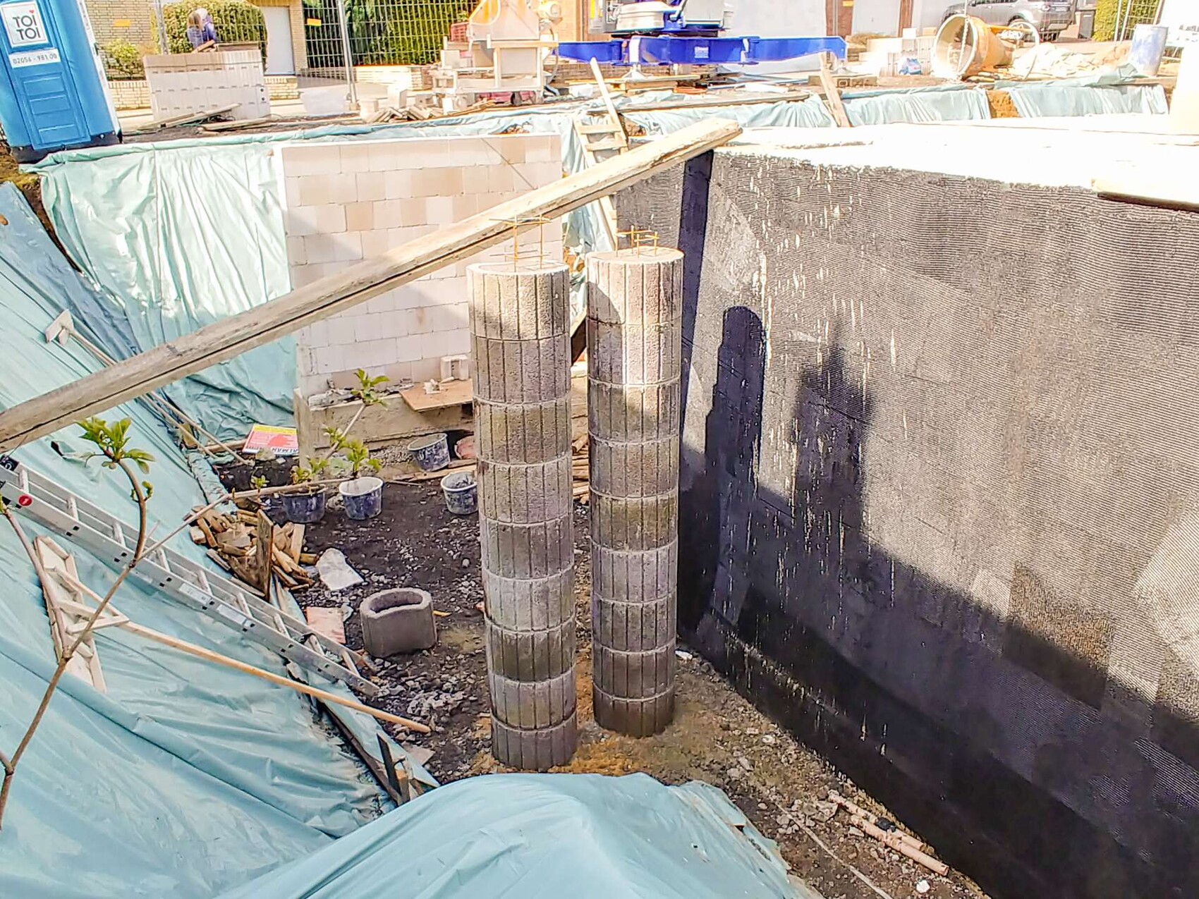

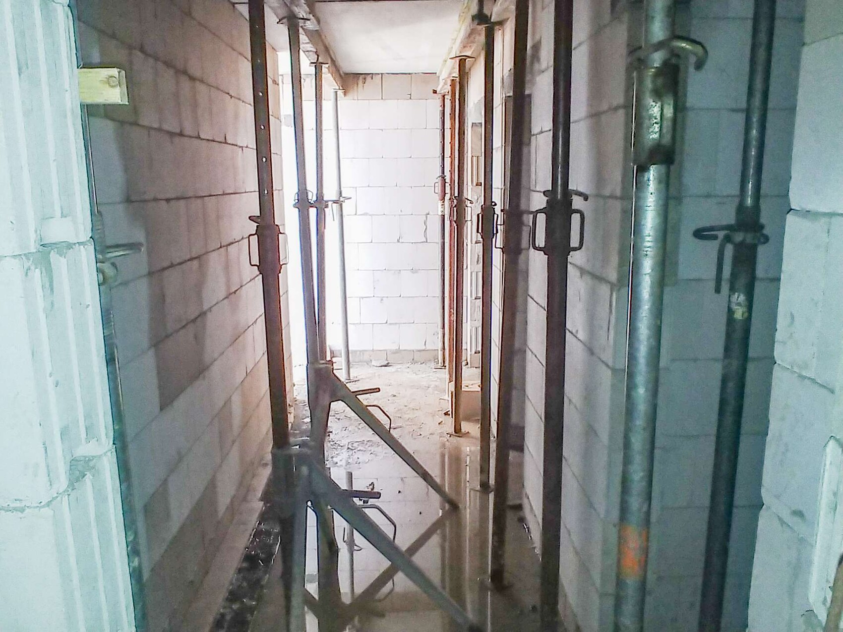

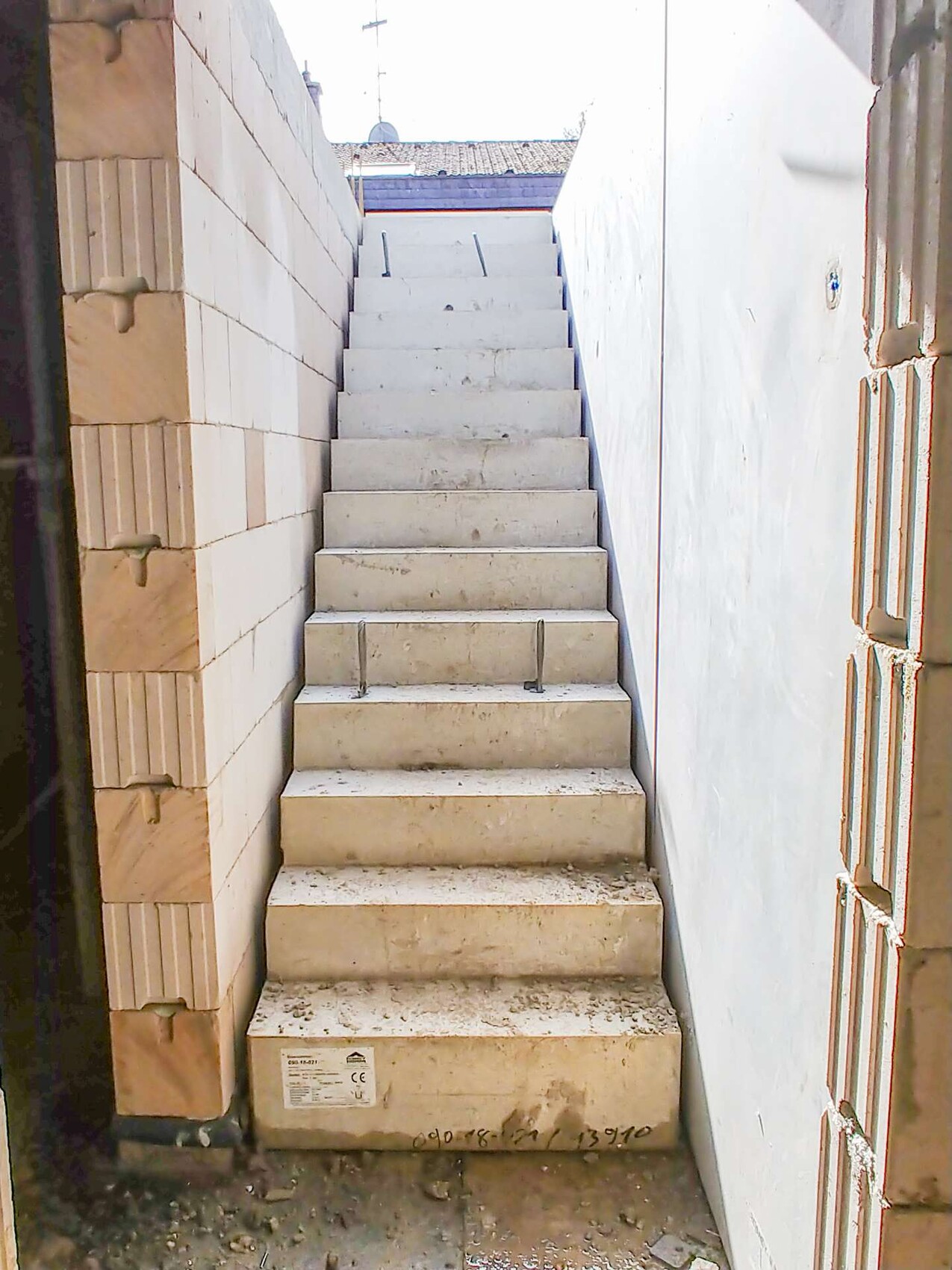

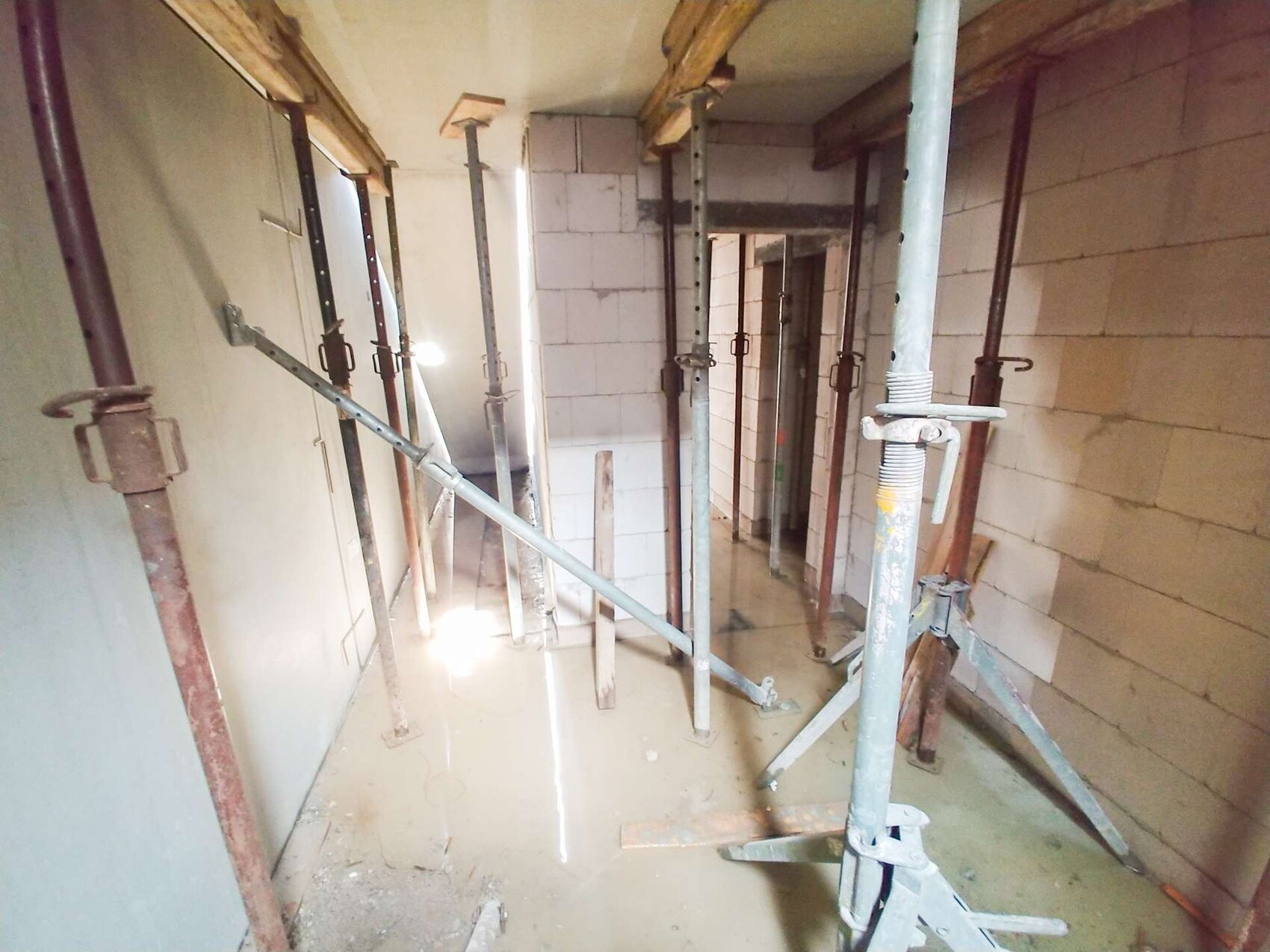

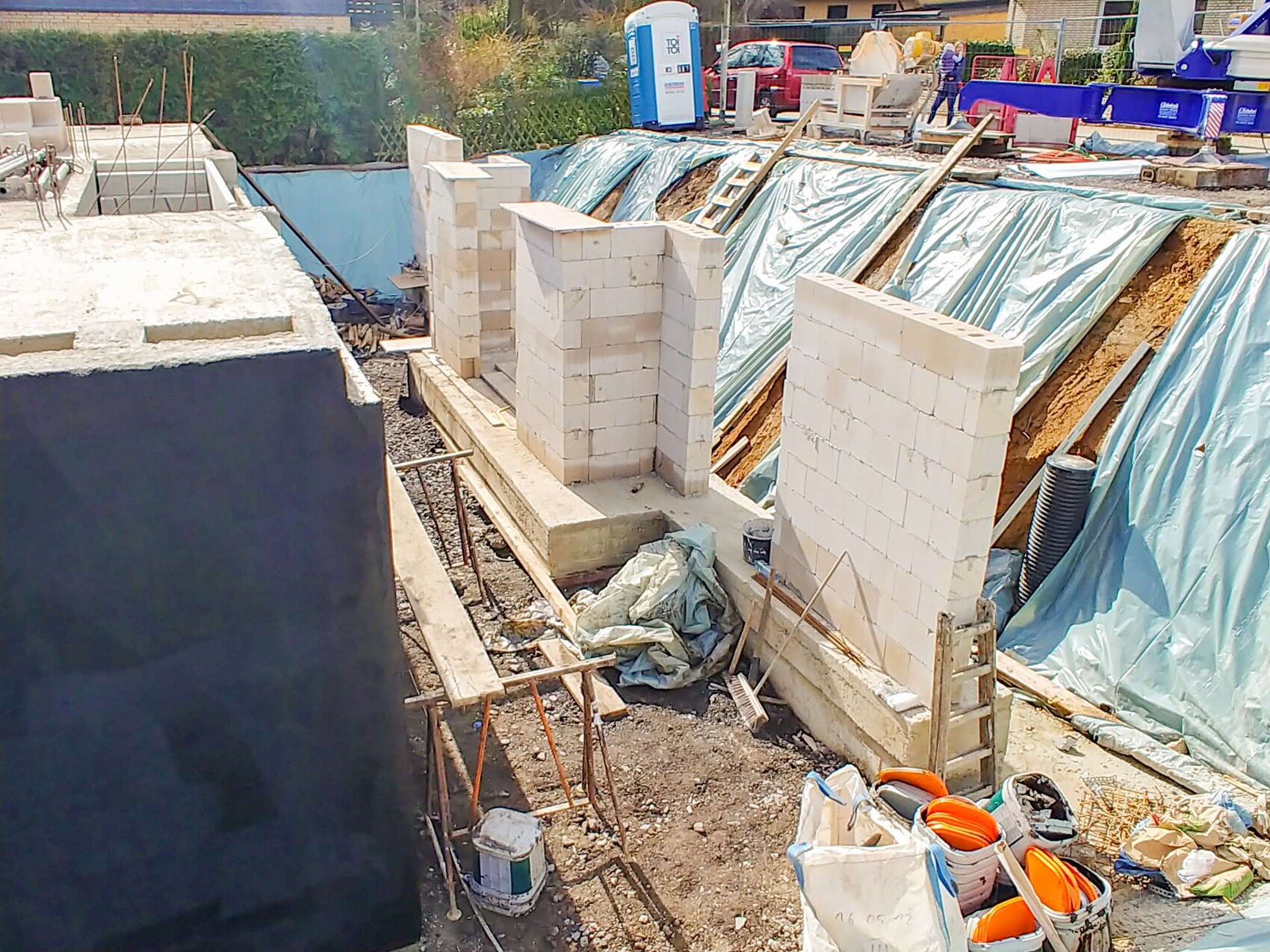

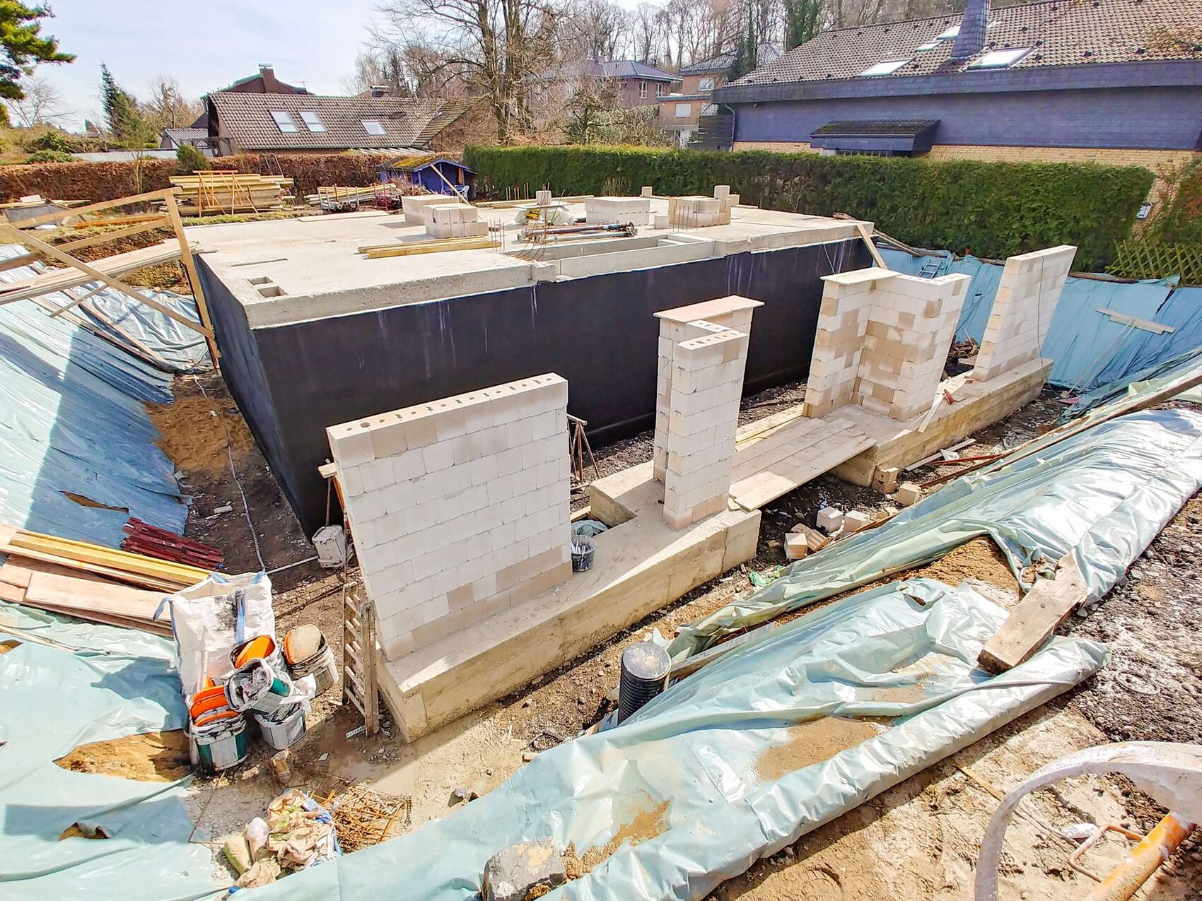

R.Hotzenplotz30 Mar 2018 16:47Here are the promised photos. On Tuesday, the inspector will come to check the proper construction of the basement before backfilling, and the backfilling is scheduled for Wednesday.
The planned completion of the entire house is currently set for week 35.
It is interesting to see what the round objects in the second-to-last picture are supposed to be. They were not there before and, as far as I know, it was not discussed what they are.

Interesting to see what those round things are supposed to be in the second-to-last picture.No need to worry, those are pier foundations, as Alex already mentioned. I would guess that a wall for a garage, carport, or extension either ends there or runs over them. Or perhaps they serve as supports for a canopy or overhang...
Do you know if they were formed? In our case, two are used in the area of the carport/extension as well. There, two 65cm (26 inches) inspection chambers are simply placed and filled with unreinforced concrete. This seems to be cheaper than using formwork. Whether they look like that, I don’t know, which is why I’m asking. But they also look like concrete rings...
What kind of walls are standing somewhat irregularly in the excavation in the last picture? They don’t seem to be connected to the rest of the building. The front wall looks like it might topple over soon. Is that an optical illusion or real?
