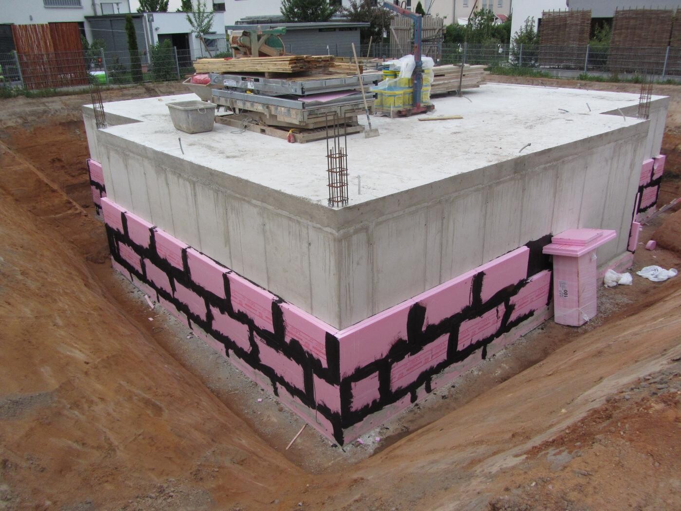

Oops, only a maximum of 10 pictures can be uploaded. Here are the remaining ones as of Sunday evening.
Construction workers standing on a concrete foundation with wooden forms and reinforcement.
Concrete foundation with pink insulation, steel reinforcement, construction timber, and material storage on the slab.

@andimann: Utility or living basement? For economic reasons, we decided against it. We are located in the catchment area of an open-pit mine, and when it is flooded, the groundwater level will rise from the current 22m (72 ft) to approximately 6m (20 ft).

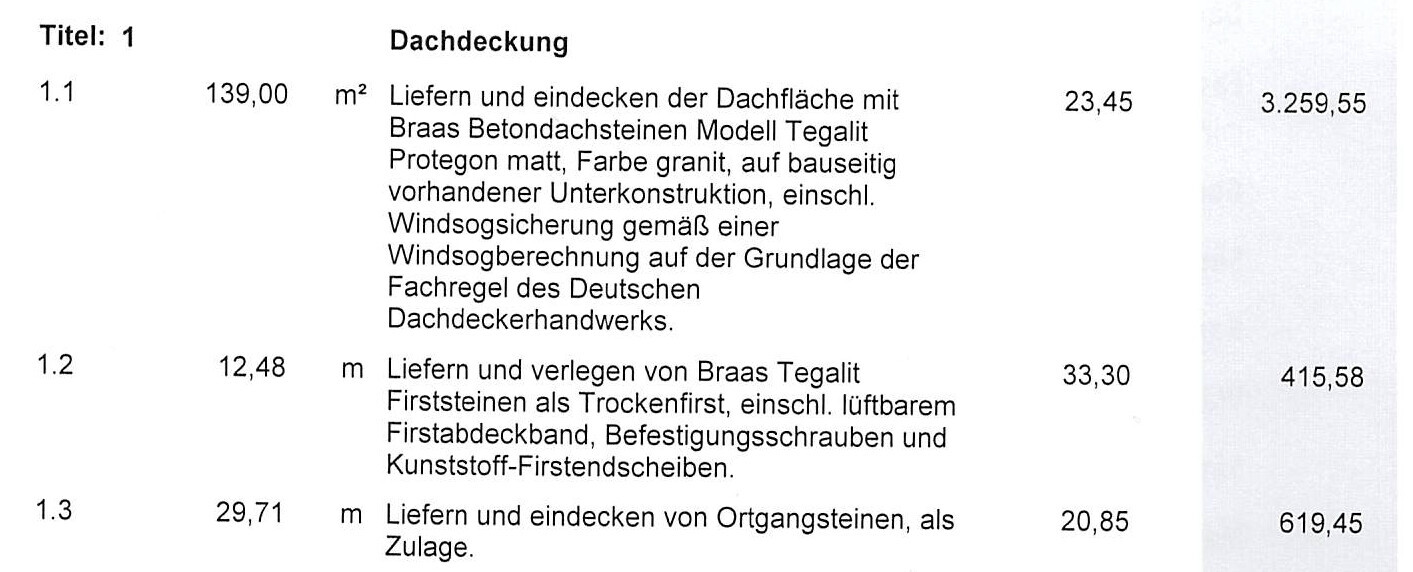

These are simply flat roof tiles – you see them quite often here. We initially wanted them too, but two things made us change our mind:
Installing a photovoltaic system is more complicated because these tiles usually don’t allow mounting brackets. Also, they need to be laid very precisely, otherwise it quickly looks awkward. Overall, it’s fine with Merlin, but it inevitably doesn’t look as nice around the roof windows.
Additionally, they cost almost twice as much – and honestly: you hardly ever look at the roof afterward. Even now, just before moving in, I don’t stand there admiring the roof – it’s just there. This happens with so many things where you spend a lot of time thinking about them beforehand, but in the end, you hardly pay attention to them at all.

Hello Sirhc,
Thanks for the compliment. I don’t think there are really pros or cons. At least neither the roofer nor the architect, both of whom are competent, mentioned anything on the matter. --> Just go for it! I found roofing to be relatively inexpensive anyway, so the extra cost didn’t really bother me.
Table for roofing with positions, dimensions, and costs in a building plan
Attached is an excerpt from the invoice (net price).
I would choose them again because I find them the most appealing, and when I look at a house, these always catch my eye.
Merlin

It will be a mix between a utility and a living cellar. For now, one room will be used as an office, one as a workshop, and one as a technical room. That leaves a 44 m² (474 sq ft) room intended to be divided in the future, half storage and half home theater. Whether we will actually do that, I’m not sure... The finished ceiling height in the cellar will only be about 2.25 m (7 ft 5 in). For an office or similar use, I think that will be sufficient.
