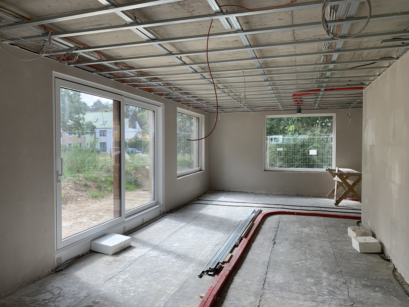

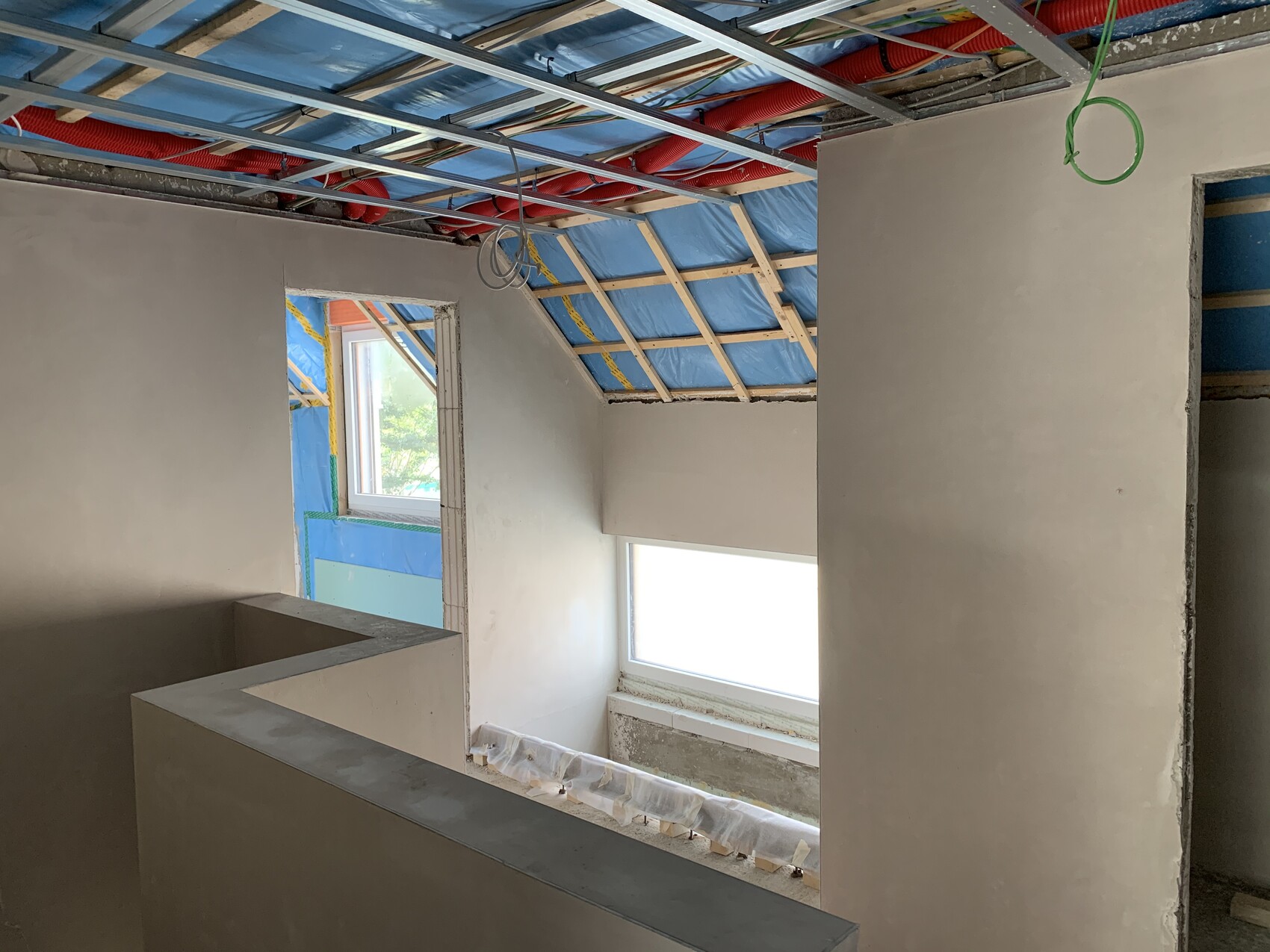

last weekend the interior plastering:
![IMG_7479[1].JPG](/attachments/51294/)
![IMG_7487[1].JPG](/attachments/51297/)
Great to see the progress – beautiful house! From the photos, it looks like the exterior walls have been plastered only up to the metal profiles of the suspended ceiling. Is that really the case? I’m asking with regard to the airtightness of the exterior walls.
Is there a reason why a combination of timber and metal framing was used for the drywall construction in the attic?
BobRoss schrieb:
Great to see the progress—beautiful house! In the photos, it looks like the exterior walls are only plastered up to the metal profiles of the suspended ceiling. Is that really the case? I’m asking with regard to the airtightness of the exterior walls.
Is there a reason why a mix of wood and metal framing was used for the drywall construction in the attic? To be honest, I can’t answer that from a “technical” point of view. What I can say is that the unplastered interior sections of the exterior walls are about 15cm (6 inches) wide. The ceiling between the ground and first floors is a cast-in-place concrete slab resting on the exterior walls.
Our architect has always done it this way. I trust her judgment.
As for the upper floor/attic, the wooden structure is part of the roof frame. The roof is insulated between and above the rafters. The metal framing is only for the suspended ceiling.
