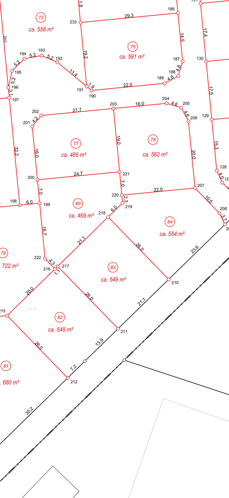

I have chosen plot number 83.

Site plan with plots, red boundary lines, and area information
