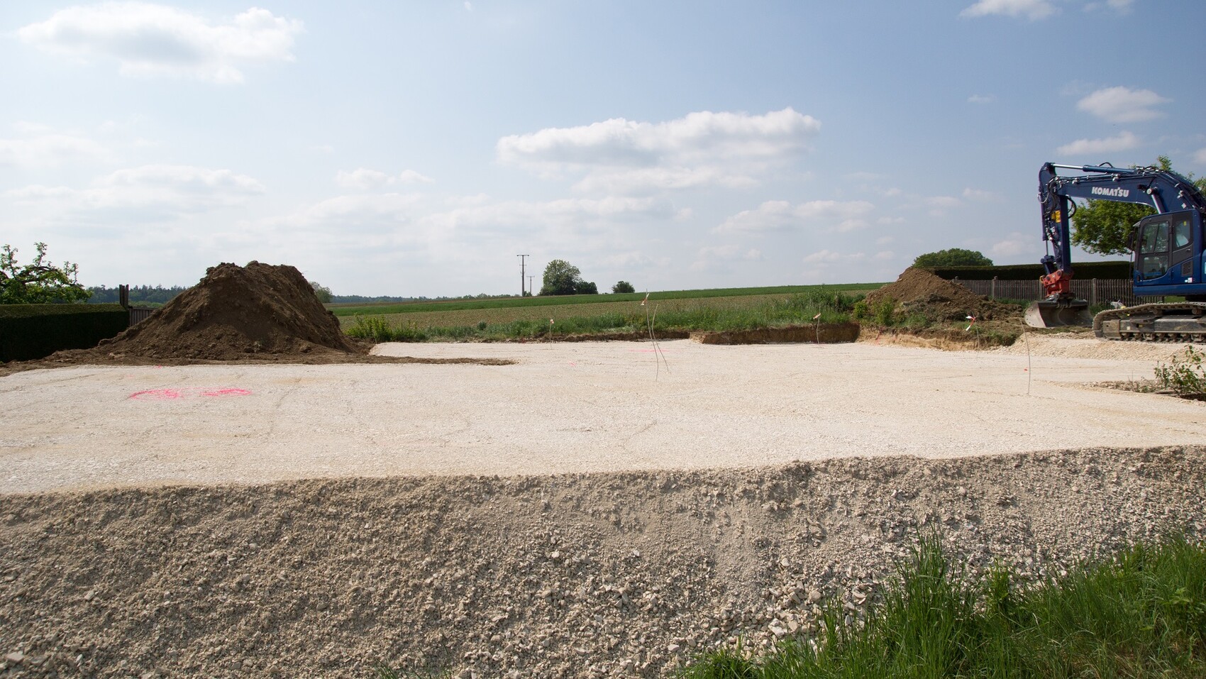

Our site fill is now complete, everything is ready for the foundation slab next week. I didn’t expect that with the extension we would end up so high above ground level.....
Construction site with sand surface, earth mound and road access in front of residential houses in the background.
Excavator on open construction site on the right, gravel ground, earth piles on the left, field in the background.

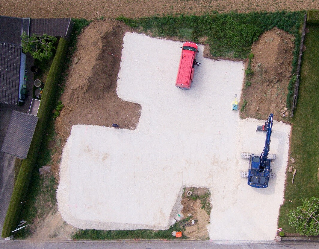

Bird’s eye view of a construction site with foundation slab, red truck and blue excavator

Our fill is now completed for the time being,
And what is it supported by?
KingSong5 May 2018 12:28
A 50cm (20 inches) high natural stone wall or gabion baskets will be added below, although I don’t find gabions particularly attractive; it depends on the price. Otherwise, the sides will remain as they are for now.
KingSong5 May 2018 12:33
The earthworks contractor and the structural engineer said that no support is needed, a 200 kN load plate bearing test at the corners was fine... but we want a straight finish at the bottom.
11ant5 May 2018 13:01
That looks very fine-grained. With an undermining (a pipe break is enough), I would expect it to collapse like a soufflé. Nowadays, a lot of embankments are made where I think: someone has probably never seen a landslide before.
KingSong5 May 2018 13:05
This is 0-45 frost protection gravel, but I don’t share your concerns. Everything is correct here. We are only that high in the last third of the extension; where the underground pipes will be, we are on a 60cm (24 inches) gravel base.
