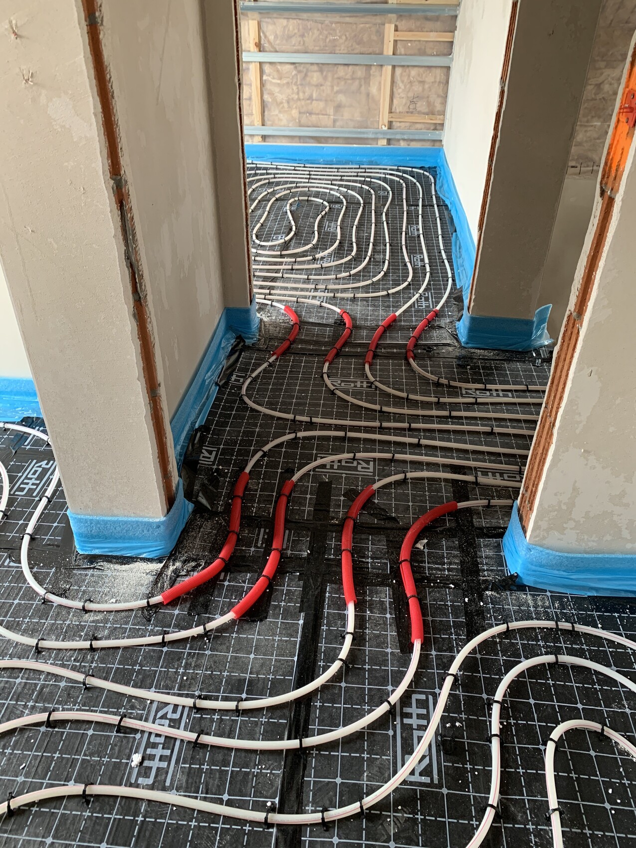

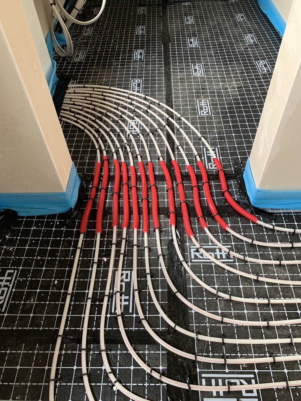

The underfloor heating is installed.... the screed will be poured next Wednesday.
Here, special attention was paid directly to the protective conduits, following the recent thread on this topic.

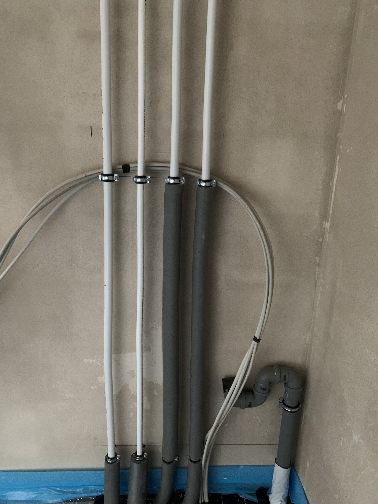

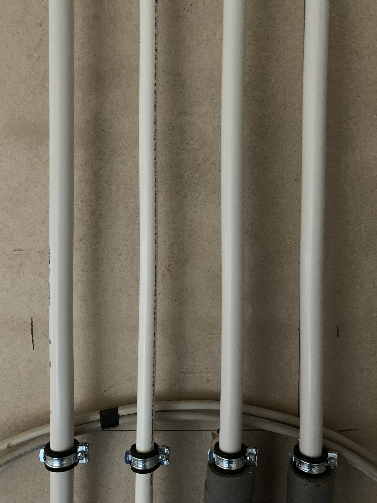

Perhaps someone knows why (in the last two pictures) the second pipe from the left is thinner than the others and only the two pipes on the right are more insulated?
Andre77 schrieb:
Maybe someone knows why (in the last two pictures) the second pipe from the left is thinner than the others and only the two on the right are more insulated?The second pipe from the left could be for underfloor heating?Andre77 schrieb:
The underfloor heating is installed .... next Wednesday the screed will be poured.
They paid close attention to the protective tubing here, referring to the recent thread on this topic.
Maybe someone knows why (in the last two pictures) the second pipe from the left is thinner than the others, and only the two pipes on the right have more insulation?Where is the expansion joint, or is it not necessary?
