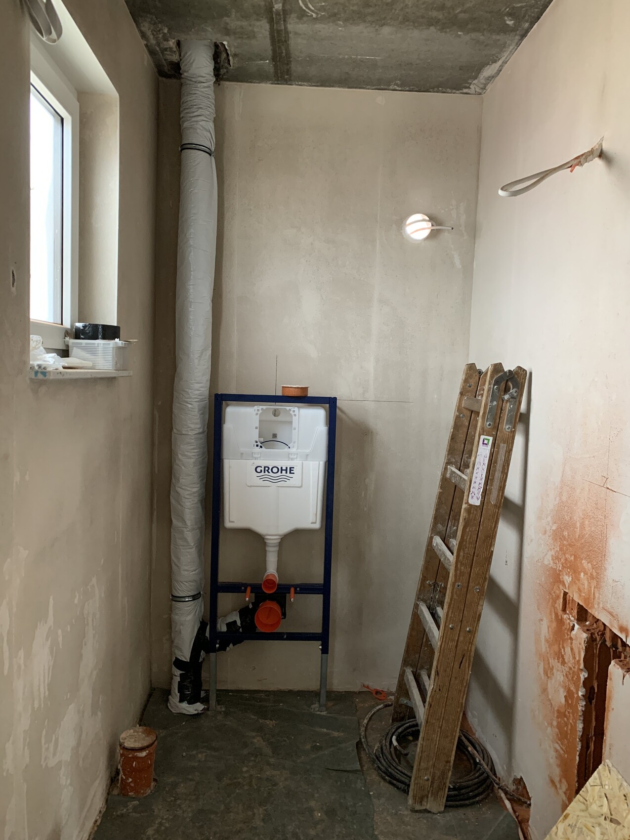

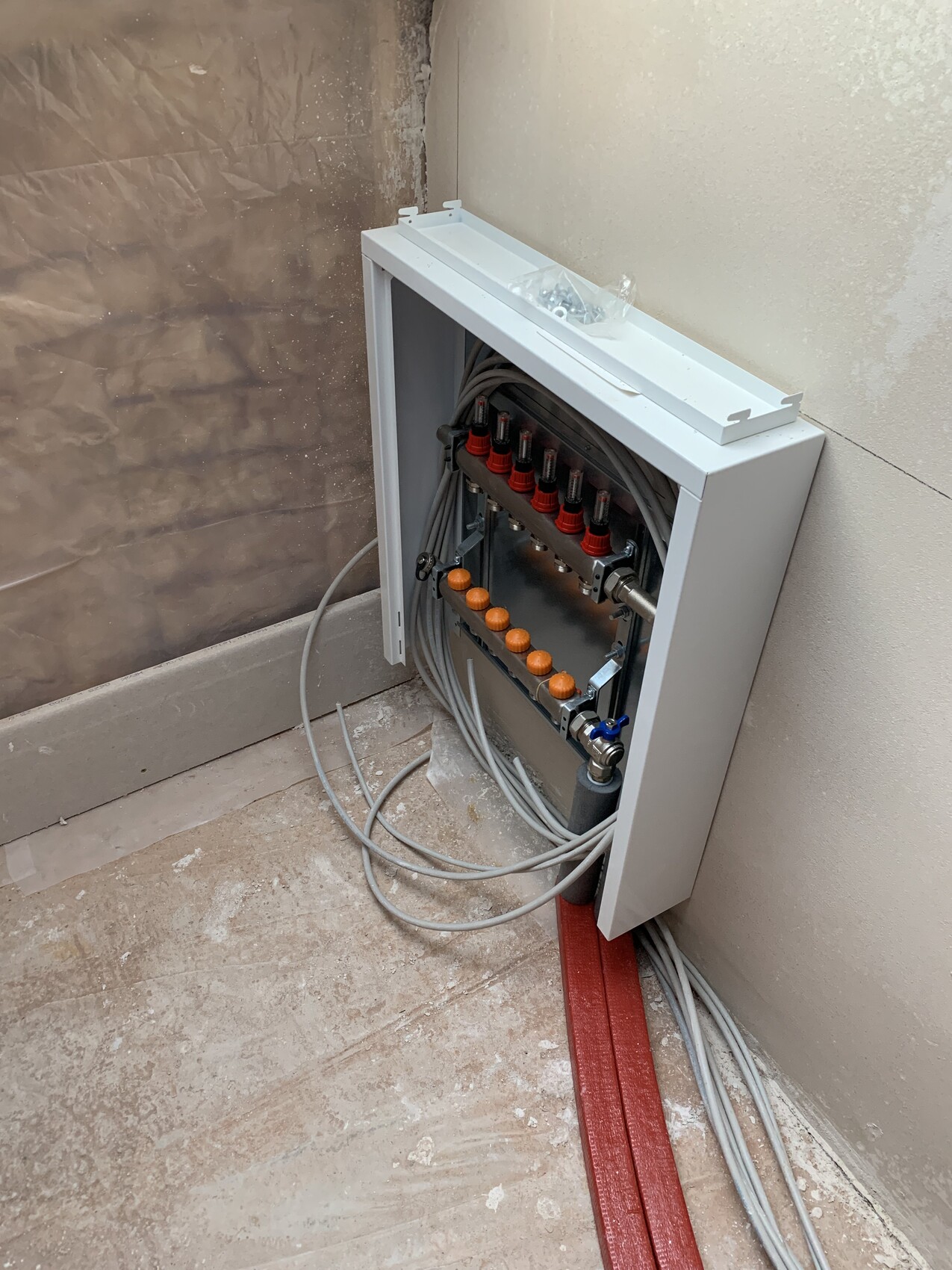

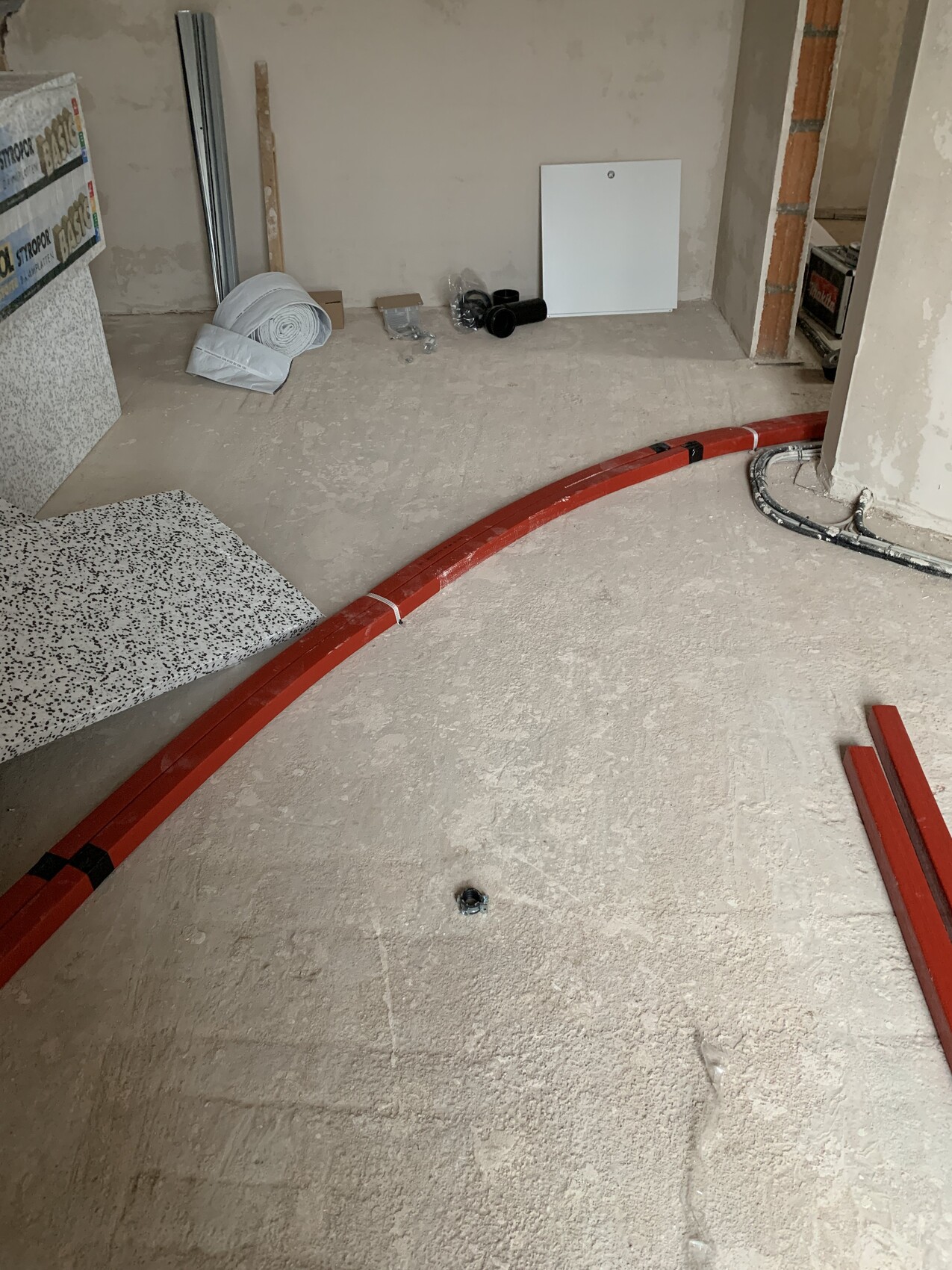

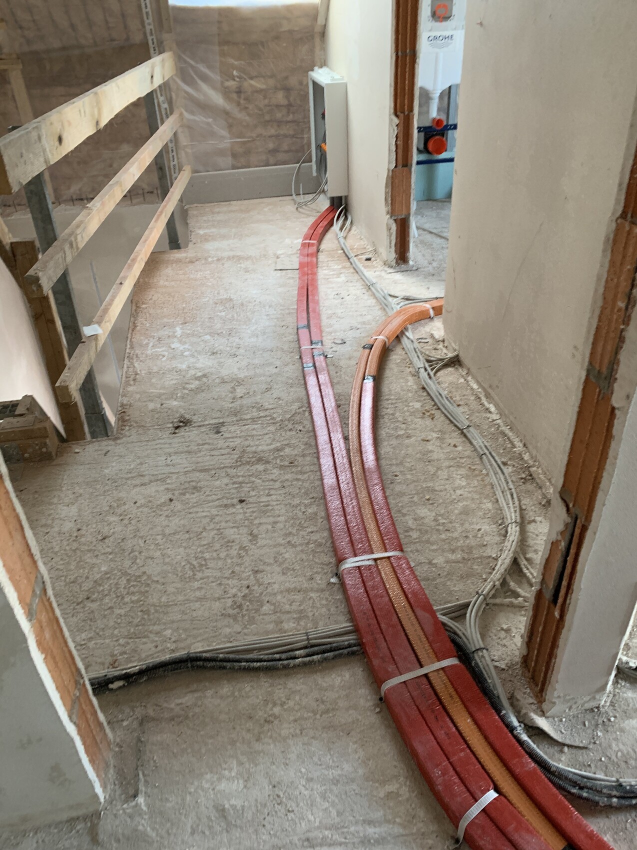

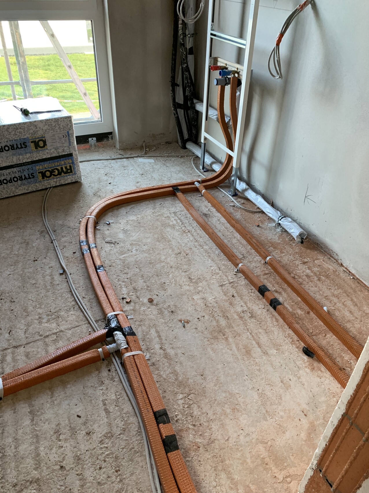

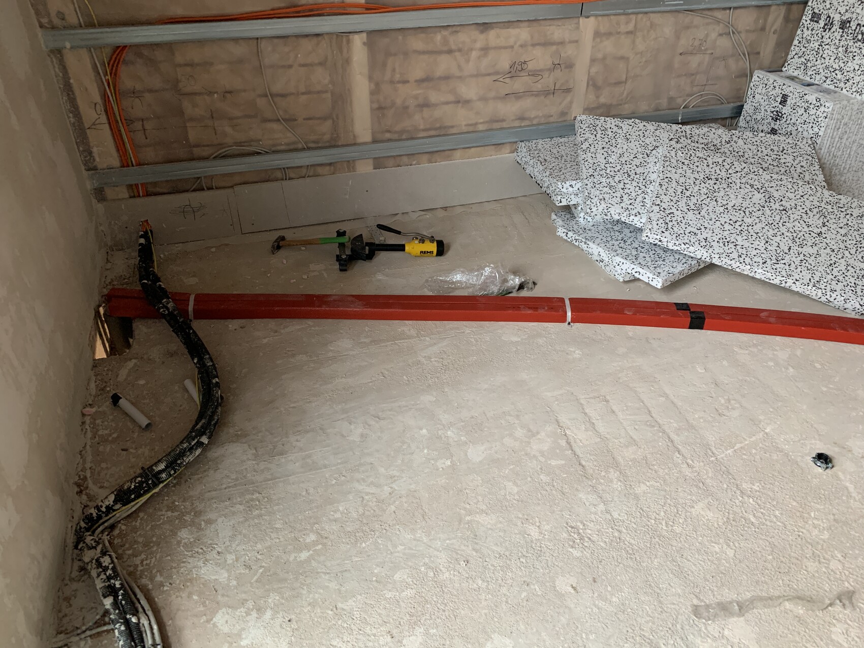

The sanitary installation is basically complete. Tomorrow, the insulation will be installed, and after that the underfloor heating will be laid.

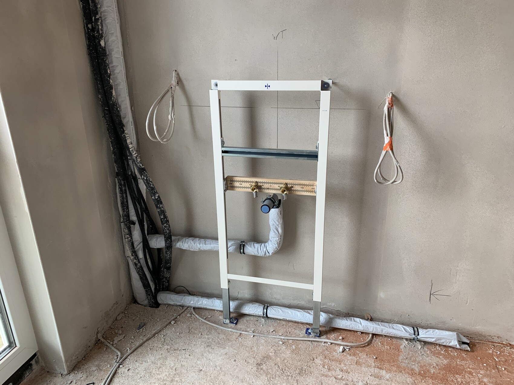

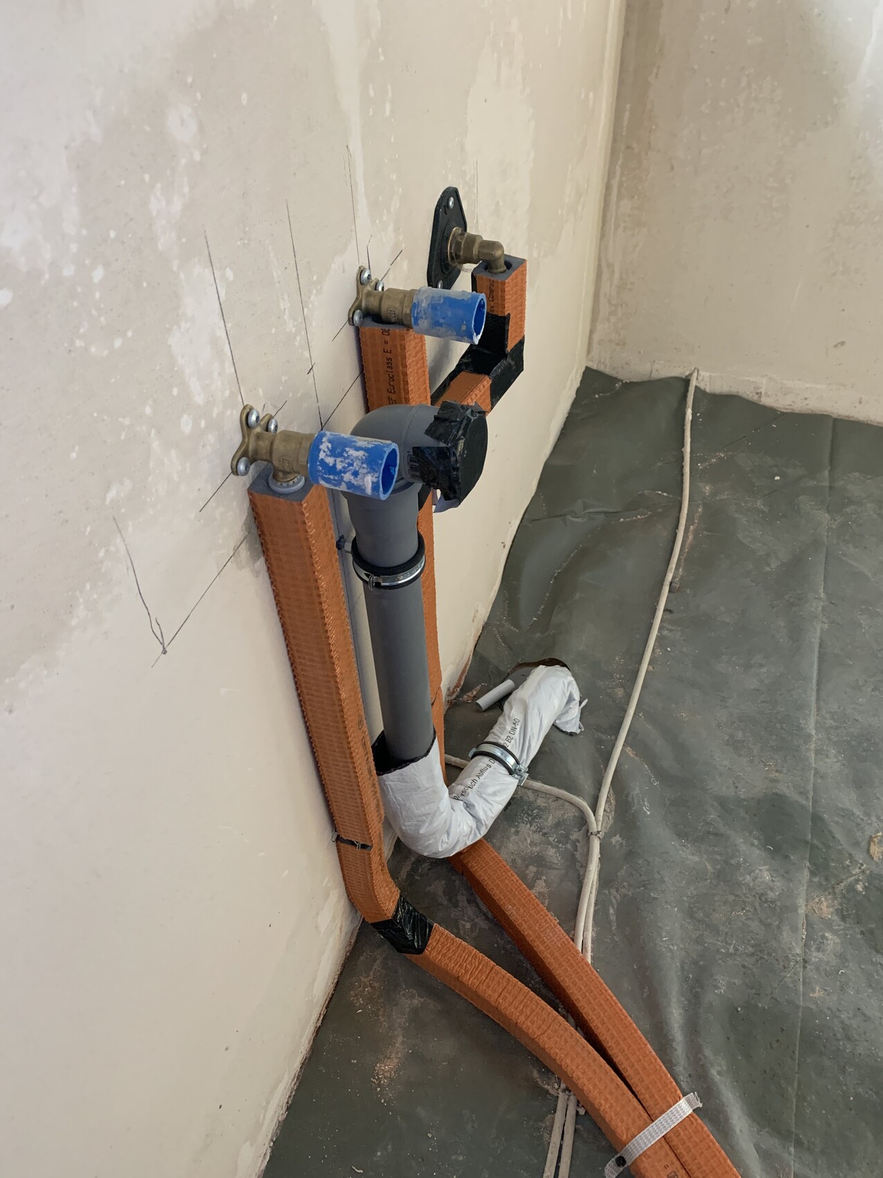

I was a bit surprised that the water supply and drainage in the kitchen are surface-mounted. Yes, it was stated in the scope of work, but I couldn’t really imagine what the finished result would look like.
Andre77 schrieb:
The plumbing work is basically finished. Tomorrow the insulation will be installed, followed by the underfloor heating.
I was a bit surprised that the water supply and drainage in the kitchen are surface-mounted. Yes, it was specified in the scope of work, but I couldn’t quite imagine what the final result would look like. Do you have a basement? If it’s just a slab foundation, then the bitumen waterproofing is missing; this topic was discussed here quite recently...
@seat88
No basement.
I recently discussed this topic with my site manager and my building inspector. Both said it’s not necessary. Since the foundation slab is made of waterproof concrete (WU concrete), it is not required.
The building inspector wrote to me:
"The requirement for waterproofing (e.g., waterproof membrane) is specified in DIN 18533.
However, this standard does not apply to components that are inherently watertight, such as the foundation slab of your building."
No basement.
