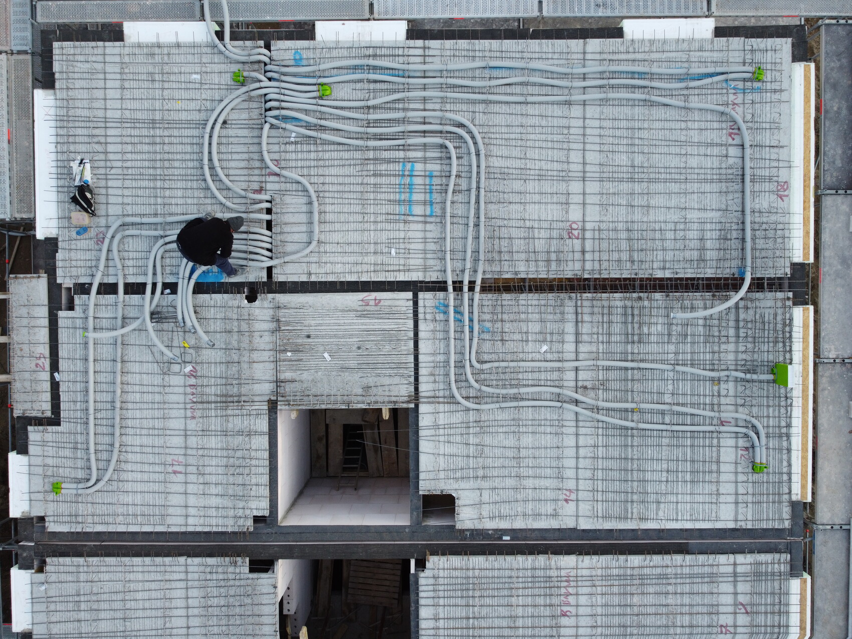

Strahleman18 Nov 2020 21:14After the ground floor walls were built and the concrete ceiling slab was installed over the past few days, today marked the second phase of installing the ventilation ducts. There was quite a bit going on within the ceiling space by the end of the day. Originally, wall outlets were planned in the supply air rooms on the upper floor. Unfortunately, a reinforced concrete beam from the ground floor was in the way inside one wall, so a floor outlet will now provide fresh air in front of the window.
