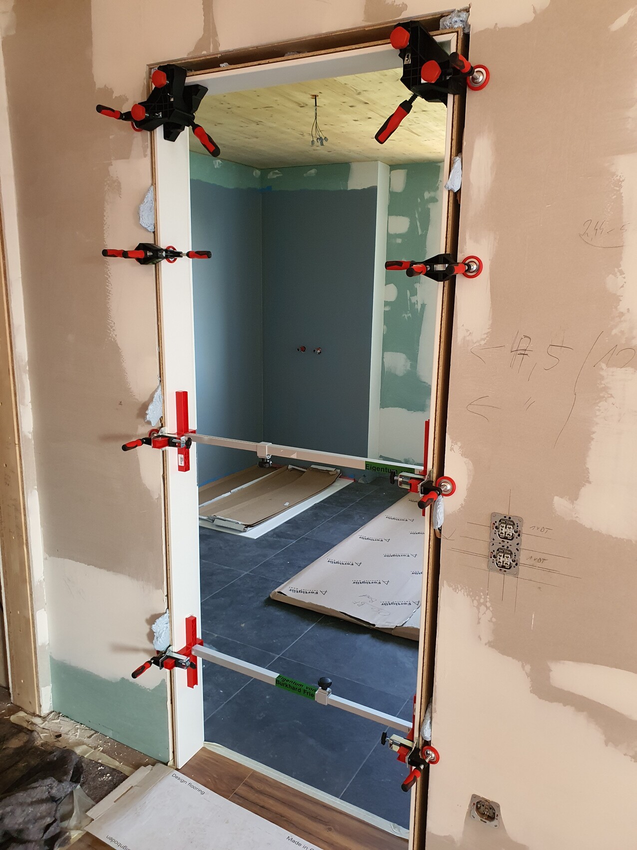

too bad 😉I’ll share something by the end of the week, as the exterior plaster should be finished by then. At the moment, I’m a bit overwhelmed. Installing the screed insulation myself is more complex than I expected and is somewhat overwhelming right now.
Friday will be moving day... into a construction site 🙄

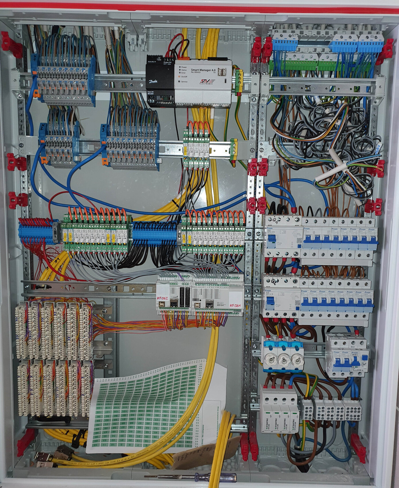

The electrical wiring (24V) is much more time-consuming than originally planned. Still, I would do it the same way again with only minor adjustments.

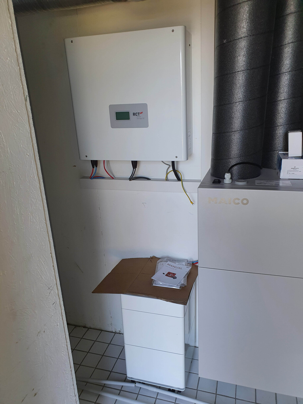

Today, the inverters and batteries have "already" arrived, on Friday Westnetz will come with the meters, and we will finally get "proper" electricity. At the same time, the heat pump and photovoltaic system will be commissioned.

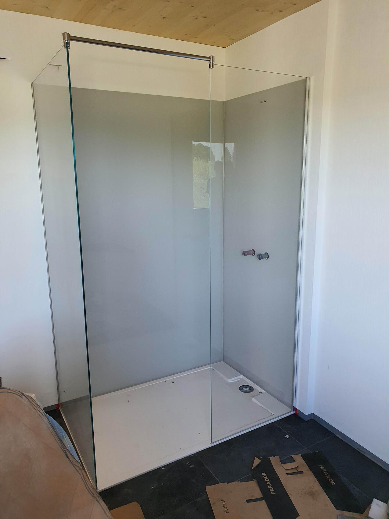

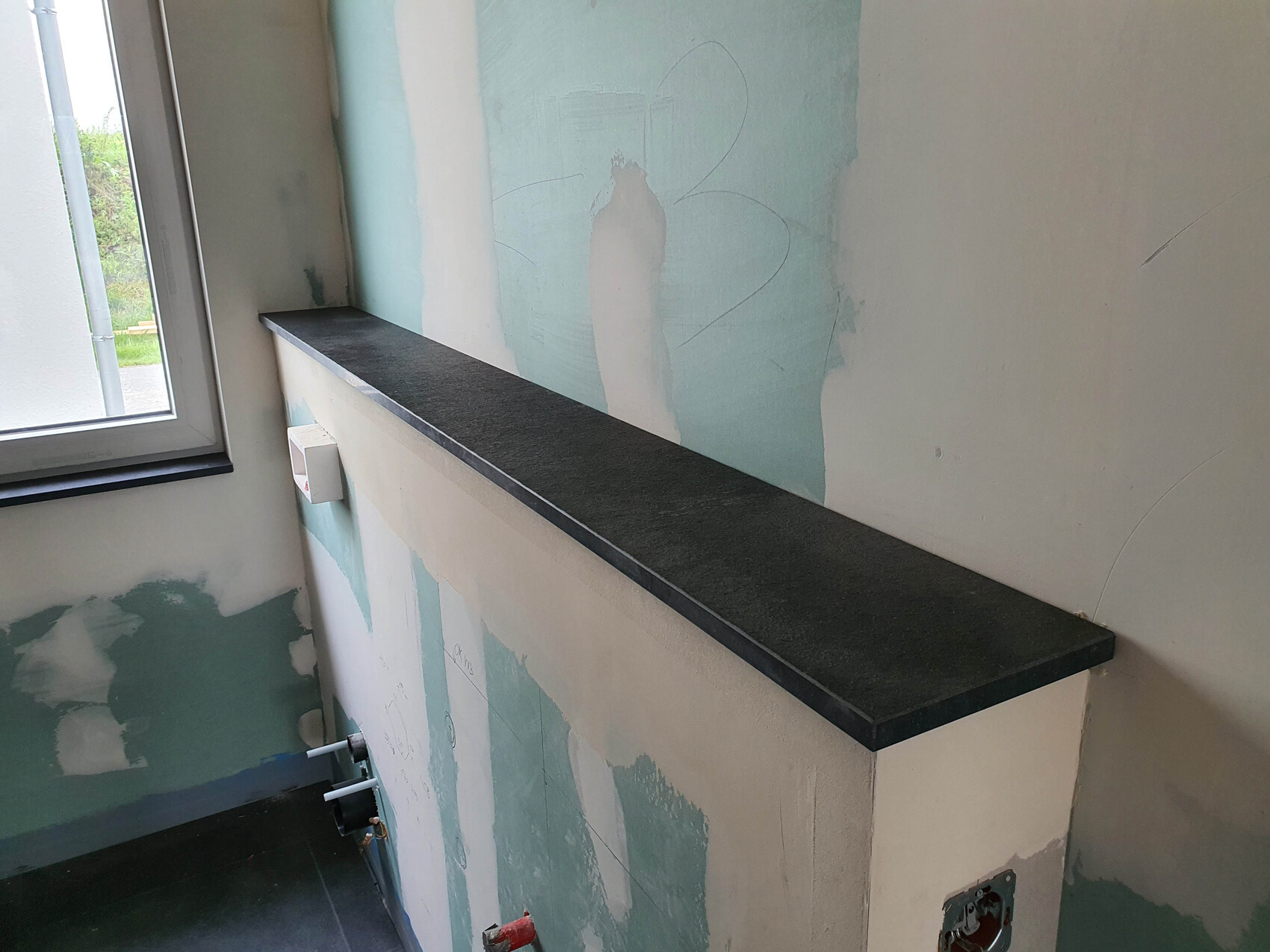

The glass for all showers is installed, as well as all window sills and shelves. Unfortunately, three glass panes are still missing, so not all base tiles can be installed yet 😕.
But we still have time until Tuesday for the rental apartments :p
Door installation, of course, is also being done by ourselves, 80% complete.
