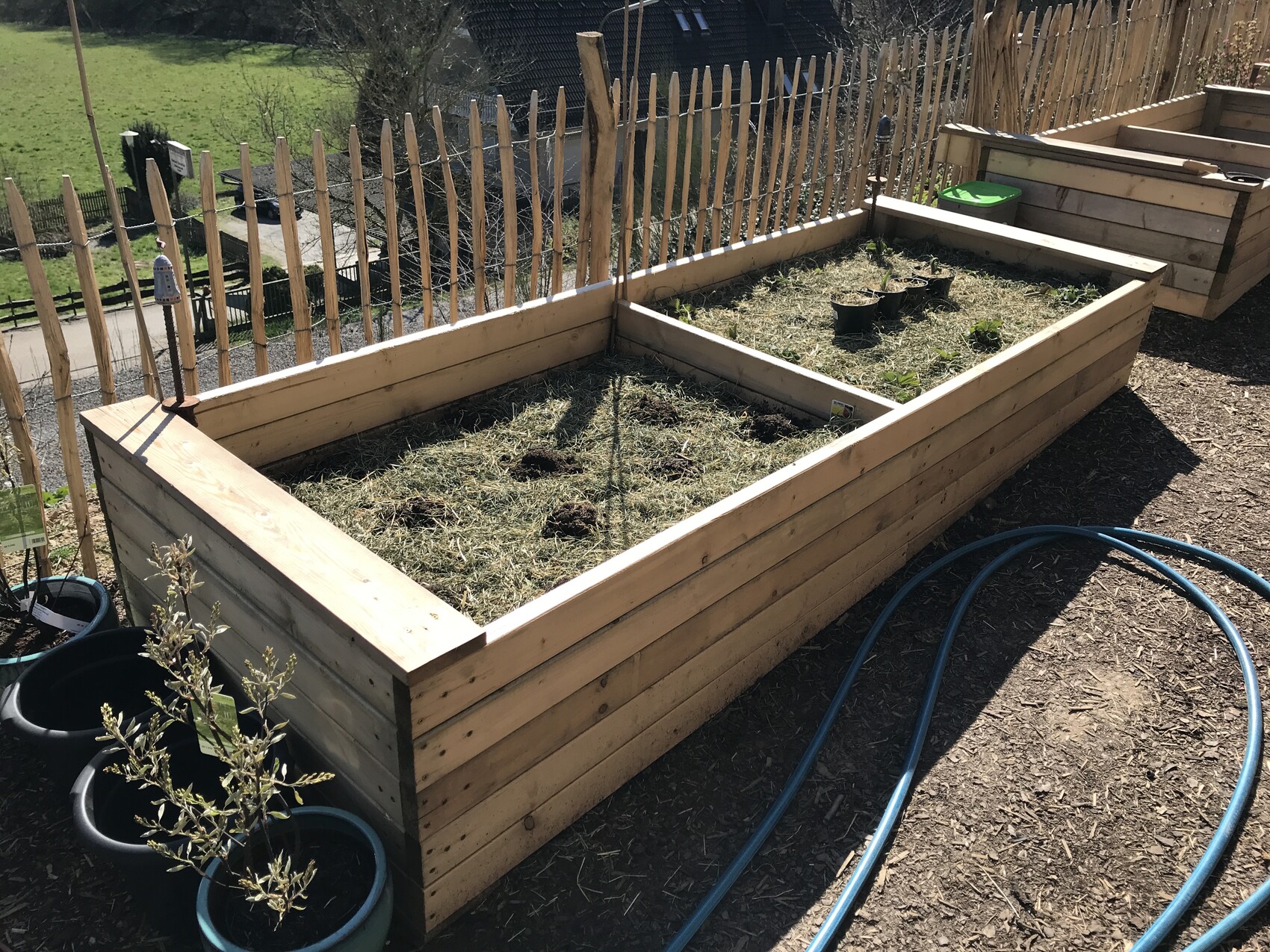

hampshire25 Mar 2020 12:53Building raised garden beds yourself is affordable and straightforward – the only real challenges come from the little ones. You don’t really need a landscape designer for this, just some good tools. A quality miter saw pays off with just this one project, and an 18V cordless drill with extra batteries is also very useful, often already available at home. Untreated wood is inexpensive; don’t use wood that’s too thin. Use square posts, staple chicken wire at the bottom, add a protective layer inside between the soil and the wood (if you don’t go for thick material), and a few boxes of general-purpose screws. Whether or not you want to treat the wood is a personal choice – it definitely improves durability.
For seed starting, you can build a wooden cover with a sheet of polycarbonate (Makrolon) on top of the bed – this is also quick to assemble. A raised bed measuring 3000 x 1000 x 550 mm (L x W x H) is not more expensive than a nice large plant pot. You can manage well with about €50.
I went a bit overboard with material thickness and screws and estimate that I spent about €75 for such a bed, including materials. (For adjusting it to the terrain, I also needed a circular saw with a guide rail.)
