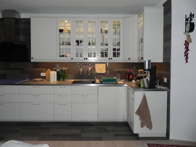

I have an 80cm (31.5 inches) front panel because the solutions described here in the forum (e.g. doweling or routing space for a rail) seemed too complicated for me. Otherwise, everything is 40x40cm (16x16 inches), but the mismatch at the dishwasher doesn’t bother me in hindsight.
At the moment, I find handles at IKEA quite difficult to choose. Luckily, I still had METRIK handles at home that I use for both the dishwasher and now also the fridge (I didn’t find the upward-pointing BLANKETT either attractive or practical)Okay, thanks for the information! I will try making a 20x20x40cm (8x8x16 inches) front panel. Let’s see how it turns out.

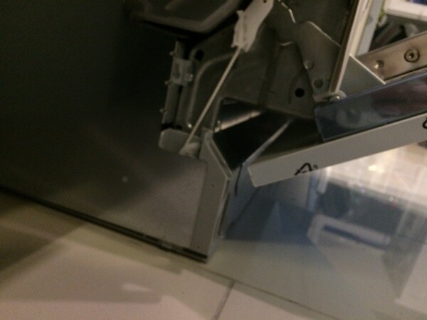

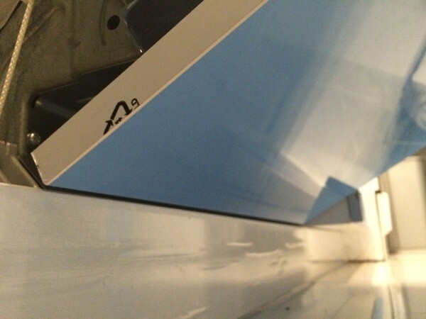

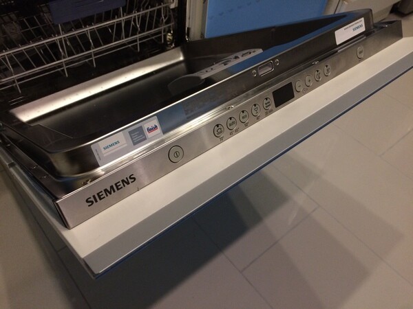

However, then I applied Steffan’s method, meaning I completely disassembled my Siemens SN65P082 and, lo and behold, it fits. I have two 40x60cm (16x24 inches) fronts even though I have the smaller machine and not an extra-large dishwasher. This is because I raised the kitchen by 2cm (1 inch) to 90cm (35 inches). Here are some pictures:

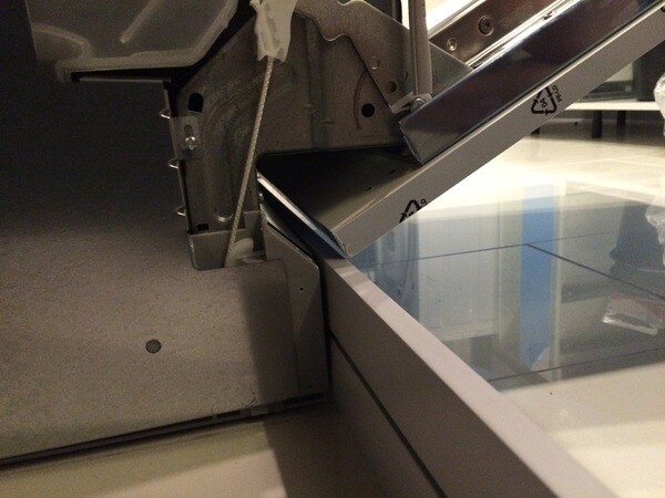

eriwikinger28 Dec 2016 17:22Hello,
here are a few more pictures with the trim strip 10cm (4 inches) and 80cm (31.5 inches) front.
I wonder if it would fit with a 9cm (3.5 inches) strip (9 80)?
As mentioned, the dishwasher is not an XL model but only 81.5cm (32 inches) high. The IKEA front is divided into two parts (2x 40x60cm (2x 16x24 inches)) and screwed on directly.

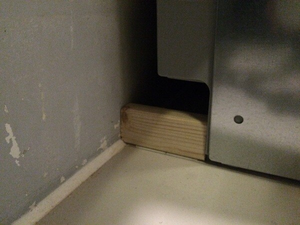

At the back, blocks are fixed with double-sided tape to prevent the dishwasher from sliding backward, since it is only fastened on the right side; the washing machine will be installed on the left.
