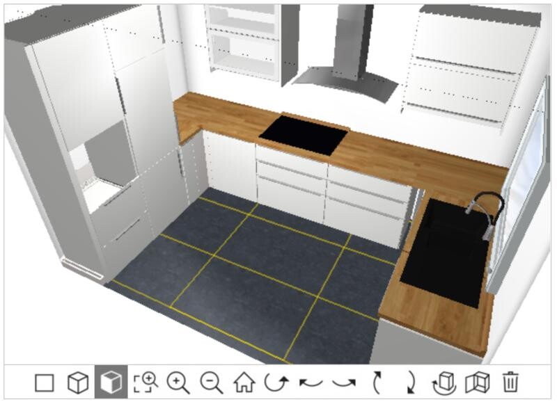

IKEA-Experte2 May 2016 14:31Do you have some pictures of the design? The planning software does not run on Linux.

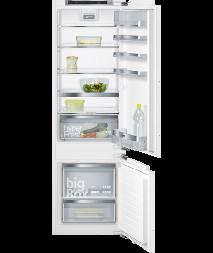

Regarding the refrigerator, the following Siemens model is among the finalists:
Do you think this unit will fit in the 220cm (87 inches) cabinet?

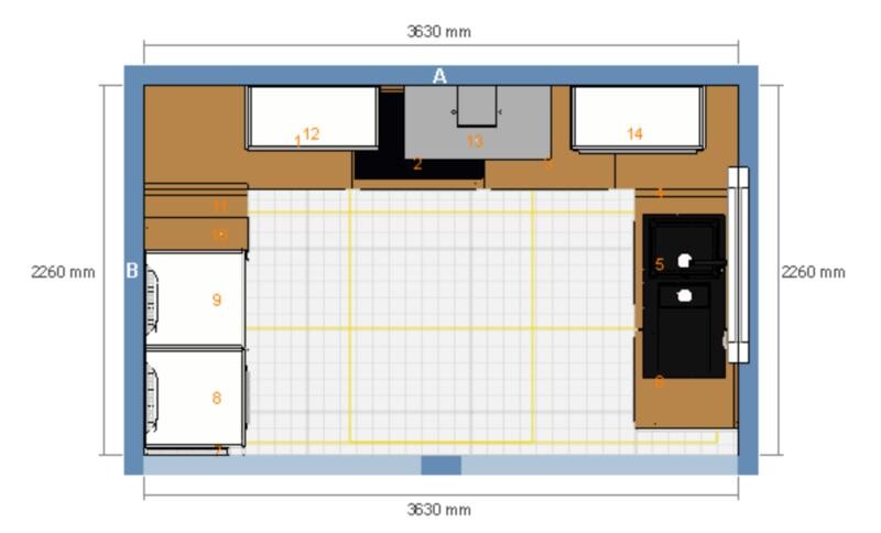

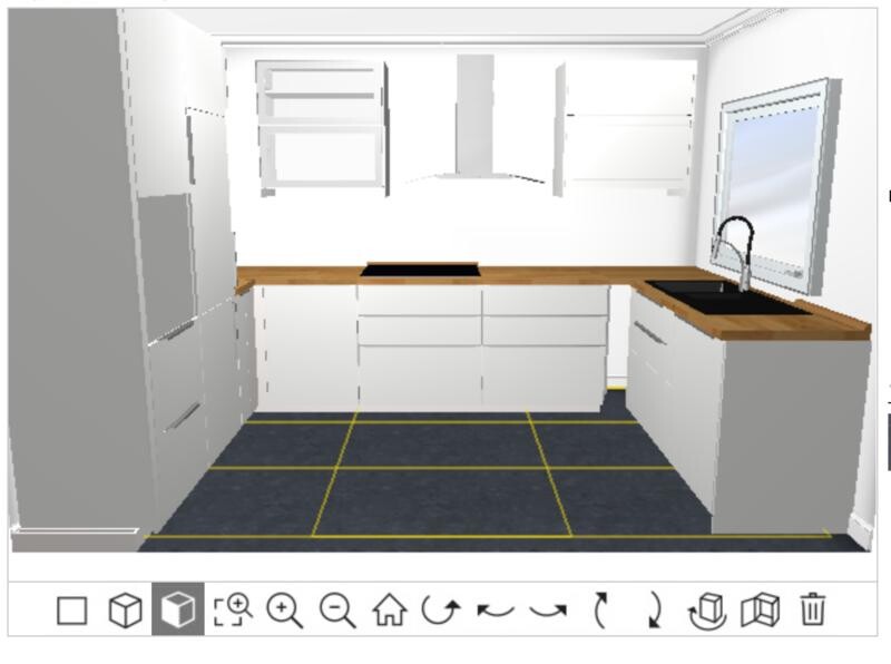

IKEA expert: here are the photos from the planner.
The induction cooktop should, as mentioned, be placed between the two 80cm (31 inches) cabinets, which the planner currently does not allow.
However, the thread about the corner isn’t really convincing. We could at best fit an additional 60cm (24 inches) cabinet if we remove the corner cabinet, but on one hand, pans with long handles don’t fit well there, and on the other hand, the 60cm (24 inches) cabinet disrupts the symmetry of both the base cabinets and the wall cabinets in relation to the base cabinets, in my opinion.

IKEA-Experte2 May 2016 15:10The combination fits in a cabinet with doors 80cm (31.5 inches) by 140cm (55 inches) or a drawer 20cm (8 inches), doors 80cm (31.5 inches) by 120cm (47 inches).
