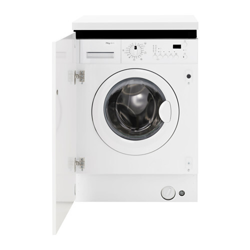

is it possible to fit this washing machine
into a similar
cabinet, so that a refrigerator could be placed on top and the washing machine below?

IKEA-Experte2 Sep 2015 21:58Hello,
Washing machines and dishwashers cannot be built into a cabinet; they can only be installed under the countertop.

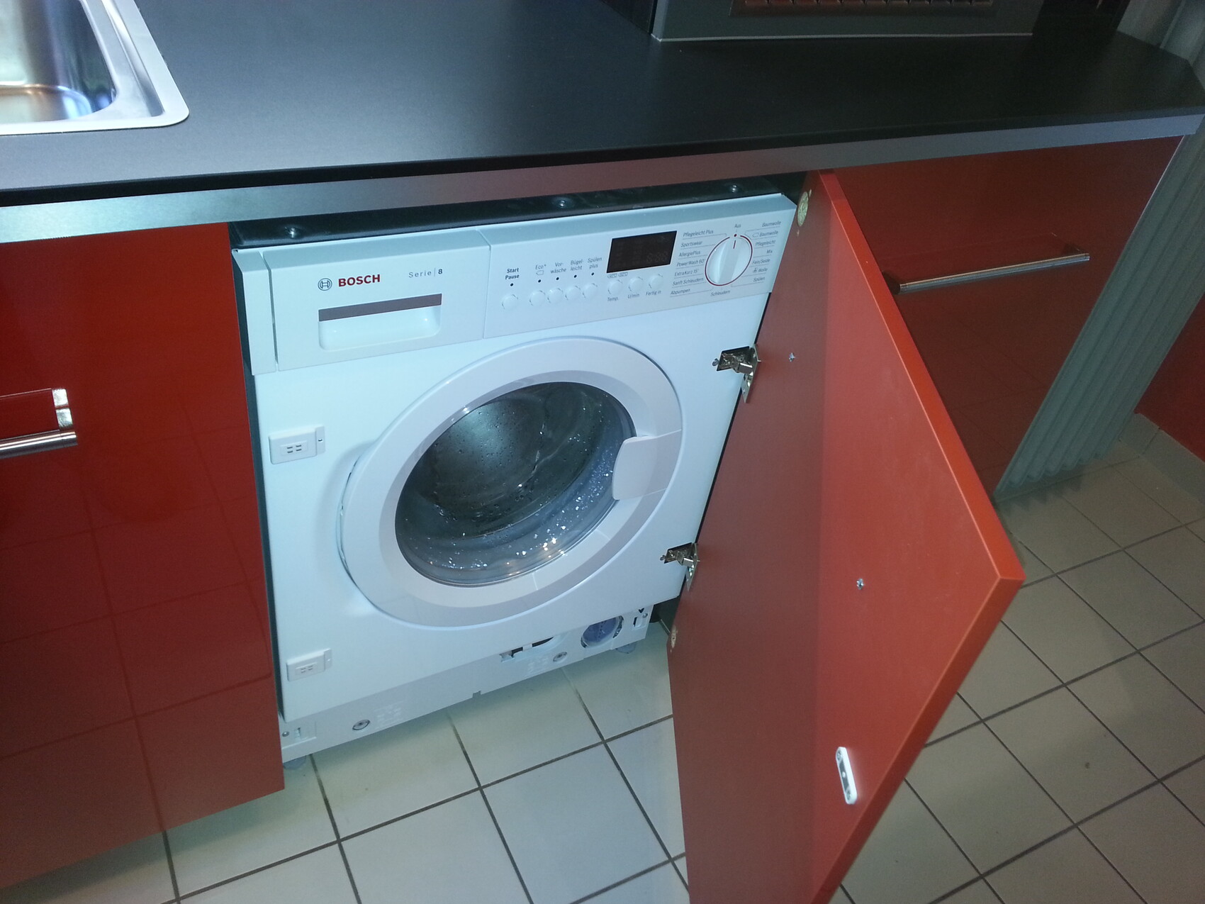

robi_aus_ffm2 Sep 2015 23:20Hello chfilm,
these are built-in appliances because you can cover them with a 60cm (24 inch) door to match the kitchen design. This way, they blend harmoniously into the overall look. Unfortunately, the appliances are about 59.4cm (23.4 inches) wide, so you can’t install them in these cabinets (which are only about 56cm (22 inch) wide inside). Also, in a built-in kitchen under the countertop, a cabinet carcass or panel must be installed on both the left and right sides of the appliances.

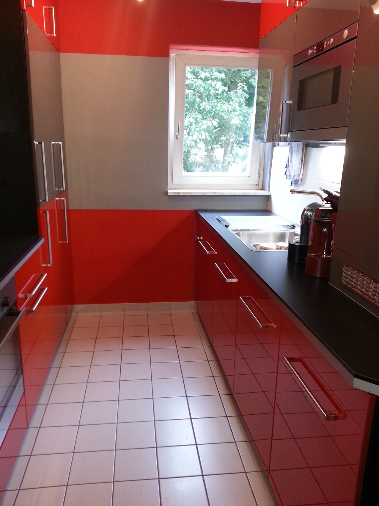

This is how it can look in my kitchen...
Best regards, robi_aus_ffm

Thank you for the quick information first of all!
Robi, you did a great job!
What kind of Bosch washing machine is that with the door opening to the right? That is also an issue for me, as the one from Ikea apparently only opens to the left, at least that’s how it appears on the website... or is it possible to change that?

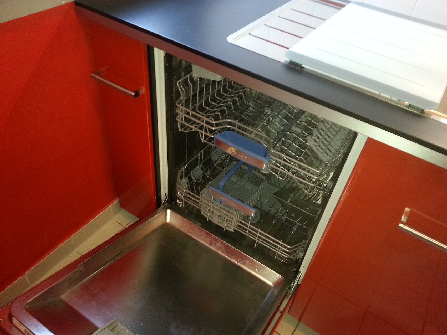

robi_aus_ffm3 Sep 2015 00:02hello chfilm,
yes, you can vary that.
The BOSCH WIS 28441 (WIS28441) is the washing machine.
The dishwasher, refrigerator, and freezer are also Bosch, and the sink is from Blanco.
BLANCOAXIS II 6S-IF
BOSCH KIR 21 AD 40 (KIR21AD40)
BOSCH GID 18 A 65 (GID18A65)
BOSCH SBE 65 N 00 EU (SBE65N00EU)
I bought all appliances, as well as the ceiling-mounted extractor hood, from innova24 (sorry for the advertisement, but I’m very satisfied with them and the price-performance ratio was also right).
(the induction cooktop, pyrolytic oven, and built-in microwave are from IKEA)
best regards, robi
