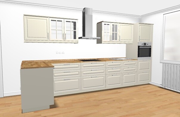

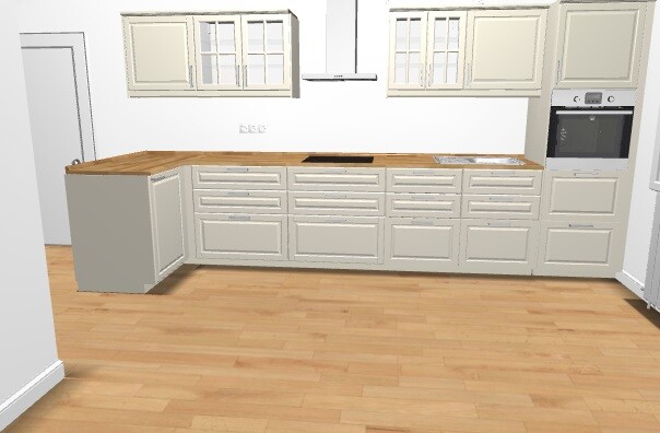

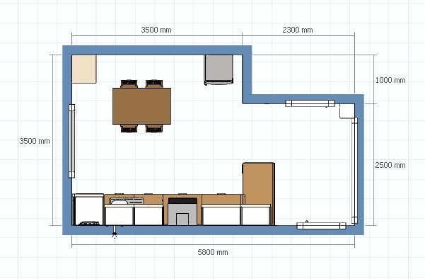

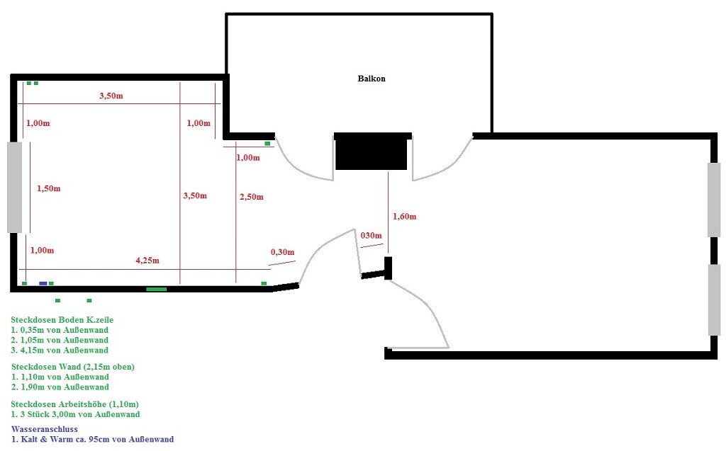

Coletrickle_780825 Mar 2015 19:22Hi guys,
Today I measured the apartment, including sockets, water connections, etc.
Specifically: I have to forget all previous plans.
On the wall where the kitchen is supposed to go, there is
- a socket at 35cm (14 inches) above the floor (just above the baseboard), another at 105cm (41 inches), and one more at about 405cm (13 feet 3 inches) (measured to the center of each socket).
- in front of the second socket is the water connection, meaning the sink and dishwasher must go there (which is probably the easiest option). IKEA also recommended this to me (I visited there today).
Therefore, the layout would now look like this...
1. Fitting strip (5cm / 2 inches)
2. Upper cabinet oven (60cm / 24 inches)
3. Sink cabinet (60cm / 24 inches)
4. Dishwasher (60cm / 24 inches)
5. Stove cabinet (80cm / 31 inches)
6. Regular base cabinet (80cm / 31 inches)
7. Corner cabinet
I would also keep the kitchen height at "only" 208cm (82 inches) because the upper sockets are at 215cm (85 inches).
The induction cooktop can’t be moved further either, because at 300cm (118 inches) from the wall, there are 3 sockets for kitchen appliances (again measured to the center).
For the sink, I am now choosing the Villeroy & Boch Subway 45 ceramic model. I plan to install it as far away from the tall cabinet as possible since the basin is only 40cm (16 inches) wide, so I could leave 20cm (8 inches) space to the tall cabinet.
Here are some pictures to show how I’m imagining everything.
Floor plan
Design draft
