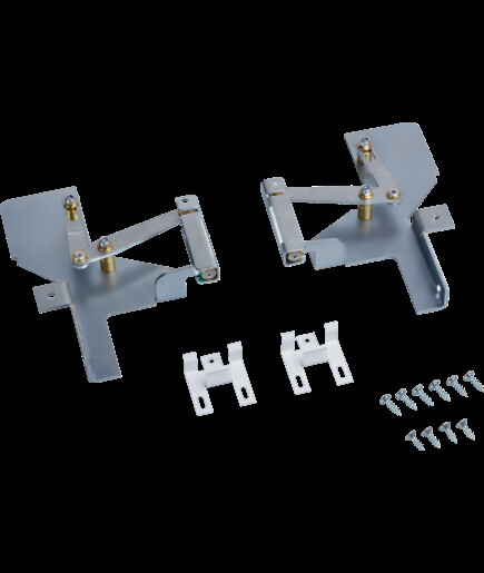

Felixcate2 Oct 2015 08:11Hello, I’m new here and have already read some posts in the forum. I want to buy an Ikea Metod kitchen. My problem is that I want to install a Siemens dishwasher SX878D06PE and I’m unsure if the dishwasher door will fit properly or get stuck. According to Siemens’ dimension drawings, the dishwasher is designed for cabinets 865–925 mm (34–36 inches) wide and fronts 705–775 mm (28–30.5 inches) wide.
According to the forum, all dishwashers with varioHinge, such as the SX878D04PE, fit. But what about this Siemens folding hinge?

IKEA-Experte2 Oct 2015 14:16Hello Tobias,
based on the specified dimensions, the folding hinge doesn’t fit. It might just barely work, but no one has reported this so far. In that case, you would need a 10 cm (4 inch) front panel at the bottom, then a 60 cm (24 inch) one above it, or a combination of 20 cm (8 inch) and/or 40 cm (16 inch) fronts, followed by another 10 cm (4 inch) panel. Do you want a front like that?
Using a variable hinge with a continuous 80 cm (32 inch) high front panel is a safer option.
With the Stefan method, you could also install your dream appliance, but whether an unforeseen issue arises that ruins the plan is uncertain.
What does the dishwasher have that a model with a variable hinge doesn’t offer?
