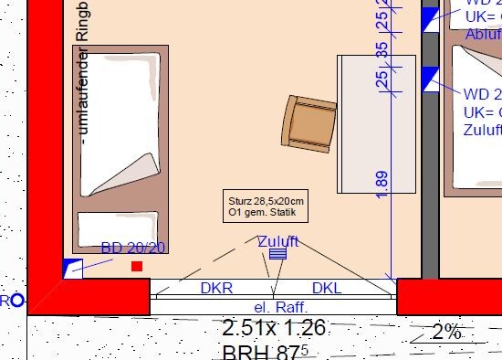

R.Hotzenplotz24 Jun 2018 02:21R.Hotzenplotz schrieb:
I can’t see it right now. On the plan, I actually see exactly what the picture shows – a pipe coming into the study from above and leaving the room again going south..... Ah yes. Now I see it too – but not in #589, since the picture above was cut off.
We really took a hit in the children's room. It is clearly drawn that the pipe is destroying the room. There is no pipe there, only a floor penetration – for the controlled ventilation system?
R
R.Hotzenplotz24 Jun 2018 14:4011ant schrieb:
There is no pipe; it’s just a floor opening – for the controlled residential ventilation system?That is a water pipe, not a ventilation duct, as the ventilation system has not yet been installed. The water pipe is already in place. It runs vertically from top to bottom. It looks somewhat similar to the pipe in the office, just straight down from above.
Honestly: You have pretty much lived up to the saying that you build your first house for an enemy; I can see you selling it again in less than ten years.
R
R.Hotzenplotz24 Jun 2018 15:4711ant schrieb:
To be honest: You have pretty much lived up to the saying that you build your first house for an enemy; I can see you selling it again in less than ten years.That may well be true. I really tried to do everything right, but unfortunately, that wasn’t enough.
Uhm... where exactly does the water go up or down in the corner of the children's room?
If that area is going to be covered, you could extend the covering behind the bed all the way down to the window sill height and actually create a nice spot there for a reading light and some books.
