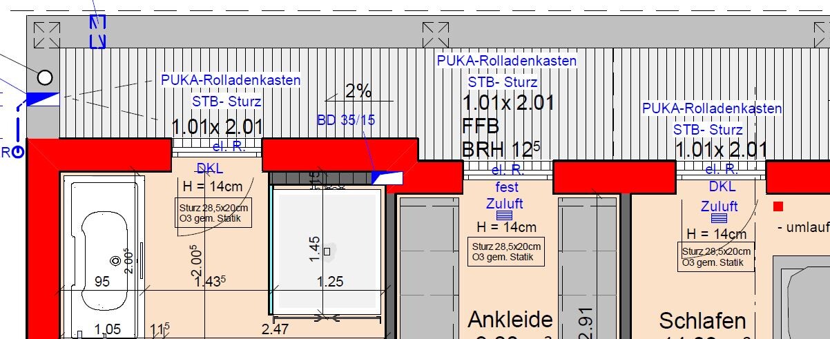

This is how it looked in the execution plan. Should I have expected that, as a 189 cm (6 ft 2 in) tall man, I would have to duck when passing through? If so, it really went unnoticed by the many people who reviewed it.
I’m curious which DIN standard the expert will cite here.
Otherwise, it might be worth investigating whether there is a case of inadequate performance by the architect (who is also the general contractor) and whether a claim for defect rectification can be made. I certainly wouldn’t design such a passageway for a tall person without at least pointing out this potential problem.

Is this a section from the construction plan? I ask because there is quite a lot of color with filled hatching, which I’m not really familiar with.
What matters first is the construction plan that you have approved.
If it is stated like that, then it should be assumed that it was also built accordingly (UK lintel = 2.01m (6 ft 7 in) above the raw floor).
Whether that information is nonsense is another matter; I cannot say if this even violates a regulation. But even when you approve the plan, I do wonder to what extent they can rely on it.
After all, this is no longer a matter of preference but simply absolute nonsense. Nowadays, even a 2.00m (6 ft 7 in) tall person should not have to duck their head.
What really surprises me is how this could have slipped past so many people (architects, their draftsmen, you and your expert, site foreman, foreman, window installer) without being noticed.
I find this really terrible right now and I’m sorry for you.

The situation is more complicated: we have been discussing ceiling heights here—with a clear preference for taller doors and windows. Then the building permit / planning permission process intervened, as the neighboring buildings have lower floor-to-floor heights. This led to a reduction—possibly including lowering the lintels (?)
R.Hotzenplotz schrieb:
We did not re-measure the lift-and-slide element
I only quoted that because I found a quite clear statement about it in the contract text. Your picture in #475 clearly addresses this (albeit only for the dressing room, but the two doors next to it are otherwise the same): it notes the clear opening dimension refers to a 12.5cm (5 inches) sill height. Therefore, the lintels should be at 213.5cm (84 inches) above the unfinished floor level. From that perspective, this wouldn’t be a comfortable dimension, but with my height at only 183cm (6 feet), I hadn’t noticed.

Tomorrow there will be an on-site appointment where the situation will be simulated using styrofoam, and I am supposed to try stepping through it.
In the meantime, the surveyor spoke with the general contractor and informed him that he assumes all the terrace doors leading from the rooftop terrace are considered emergency exit doors and cannot be designed as such, since a higher threshold clearly needs to be implemented. The general contractor did not understand this statement and has not taken a position on it yet. He will certainly review the matter.
This will now also be examined by an expert based on legal regulations.
