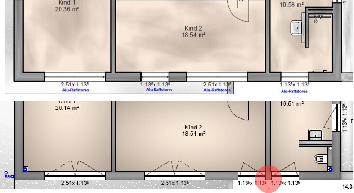

11ant6 Oct 2017 00:52
R.Hotzenplotz schrieb:
Would this be a feasible window layout on the first floor?
Both are structurally sound; I have compared them side by side:
Floor plan with two levels, children's rooms, bathroom, and corridors, dimensions
Above is the previous design,
below is the latest version, with the area marked in red where I recommended narrowing both “small” windows by 12.5 cm (5 inches) to avoid placing the window in child 2’s room right next to the wall.
R
R.Hotzenplotz
6 Oct 2017 08:06
Both options are structurally sound. Clear.
Functionally, the first one would probably be preferable, while the second looks better from the outside. I tend to lean towards the first.
However, the question is whether it would be possible to plan the same window for Child 1’s room and the children’s bathroom, and then have just one fairly wide, centrally placed large window between these two windows in Child 2’s room. Wouldn’t that be an alternative with fewer compromises? Given the compromises already involved, I don’t really see much sense in having both a large and a small window in Child 2’s room.
Alex85
6 Oct 2017 08:09
You can also place a post between Child Room 2 and the bathroom instead of a wall.
The exterior view and symmetry are also quite important.
I personally wouldn’t be bothered at all by the window right next to the wall; both children's rooms will be very bright with these window areas.
R
R.Hotzenplotz
6 Oct 2017 08:14
Alex85 schrieb:
The exterior appearance and symmetry are also quite important.
That's why the new idea is to have two identical side windows and one large centered window.
11ant6 Oct 2017 15:40
and then in child 2 only a fairly wide large window centered between these two windows
We already had that, and I was against it: it was wider than the room is deep and distorted the room’s proportions.
