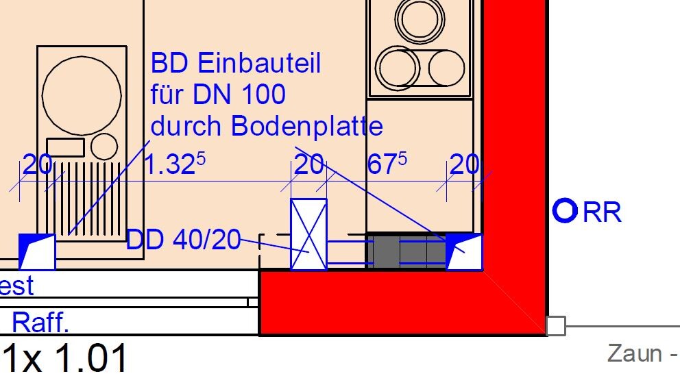

R.Hotzenplotz7 Jul 2018 15:1411ant schrieb:
You’re probably recalling discussions about pipes running through the exterior wall. But this is about a very small penetration.Okay, so apparently smaller than the pipe running along above. You might think that’s a main water line. I’ll clarify on Monday.
R.Hotzenplotz schrieb:
Ok, so apparently smaller than the pipe running along above. No, exactly the same size. Just not rising, but instead making a 90° bend before passing through the ceiling to the upper floor, penetrating the exterior wall and ending in a grille. Wall opening 20x20 cm (8x8 inches) or, if you prefer, a core drill hole 16 cm (6 inches) in diameter, pipe nominal diameter 150 mm (6 inches). No different than what zizzi did with the kitchen extractor hood. Nothing complicated. Just make the hole, put the pipe through, seal with mineral wool and filler. Any girl can do it if the guys are too clueless.
R
R.Hotzenplotz7 Jul 2018 15:30Ok, then they probably just didn’t consider it because it’s not compliant with the DIN standard, as the DIN requires a duct through the roof. Let’s see if they will accept it once I approve the relevant DIN deviation or if it will be rejected again. For the flush-mounted mailbox, which is 10cm (4 inches) deep, they refused installation in the Poroton wall where it borders the kitchen. We had to place it in the wall cavity on the far right instead. And that is not a mailbox with a drop-through slot!
It’s not about the bathroom ventilation but about the pipe ventilation.That is exactly what it does ... venting a pipe.R

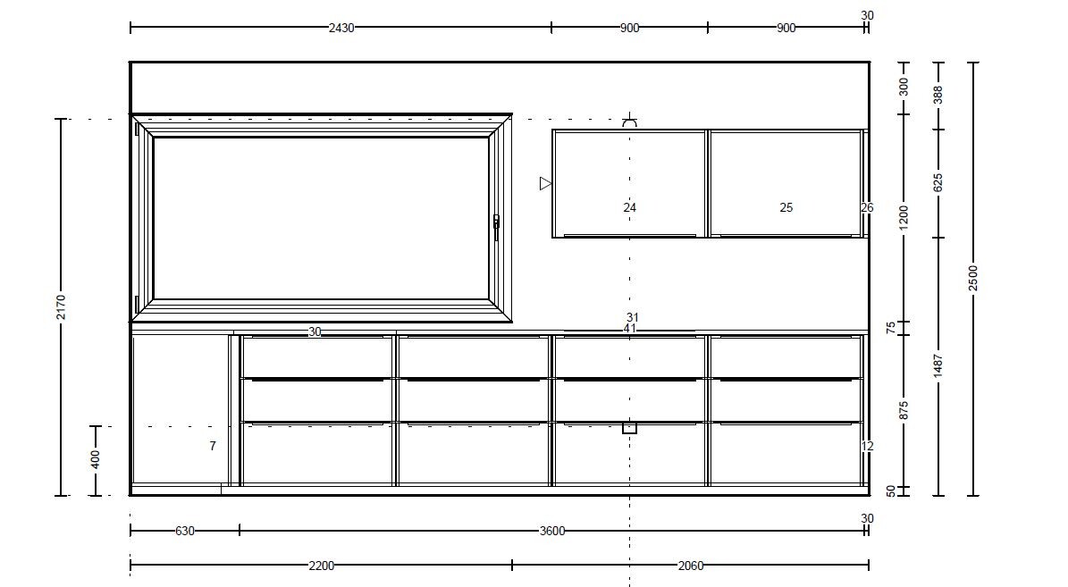

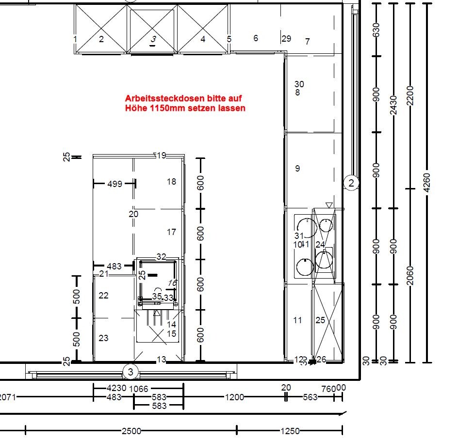

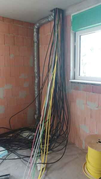

R.Hotzenplotz8 Jul 2018 09:23Another issue has come up that I only noticed today. The kitchen layout is actually not feasible. According to the kitchen plan, a wall cabinet is supposed to be installed in the lower right corner of the kitchen.
This will be difficult:
Is it common for them to simply ignore the existing kitchen plans? Even if the execution plan shows the situation differently (I see a floor opening, but not necessarily a pipe in the corner), shouldn’t the client be informed when submitting a kitchen plan? This is just really poor work.
