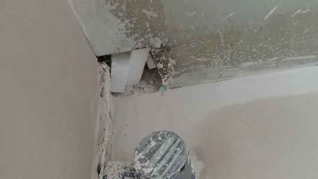

R.Hotzenplotz29 Aug 2018 17:54There are still openings like these inside the house.
Today, I asked how these would be closed up. I was told that the structural builder wonât come back for that and they just box it off. When I asked whether this wouldnât cause problems with sound insulation, I was told that there is no soundproofing required in a single-family house (which is technically correct according to the relevant standards). Still, I want the rooms to be quiet.
The expert then suggested that we could arrange to have glass wool installed in all those spaces.
What do you think about this? It also concerns the service shafts and so on.
R.Hotzenplotz schrieb:
There are still such openings here in the house. Oh wow, more than one as well. Which corners are affected?
I think, for example, the removed ventilation pipe ran through the children's room. Or rather, the downpipe, which would have been cut out of the desk surface in the study.

R.Hotzenplotz29 Aug 2018 18:4911ant schrieb:
I think, for example, the removed ventilation pipe led to the children's room. Or rather, the downpipe that would have been cut out of the desk surface in the study Exactly.
So now I have to decide whether to pay extra to have glass wool installed or look for another solution. It canât be that expensive, but even though there is officially no sound insulation required in a single-family house, we still want to do our best to achieve it. From our current apartment, itâs enough for me that my wife constantly comes upstairs to the living room telling me to turn the TV down. I find it really annoying to have to be so quiet even when weâre on different floors. Thatâs why, with some foresight, I planned the hobby room in the basement as a buffer, where a home cinema could go someday.

I donât understand the open holes. Why donât you buy a bag of masonry mortar and just fill them in? Place a board at the bottom and fill from the top. You can easily do it yourself. Or alternatively, fill them neatly with Styrodur (extruded polystyrene).
