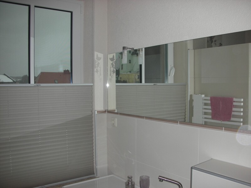

The bathroom next to Child 1 is only affected by the toilet position. On the north side, you even accept a floor-to-ceiling window there. Instead of frosted glass windows, which I always find terrible, you could simply use a pleated blind if you feel more comfortable sitting on the toilet at a height of 110 cm (43 inches) next to it.
