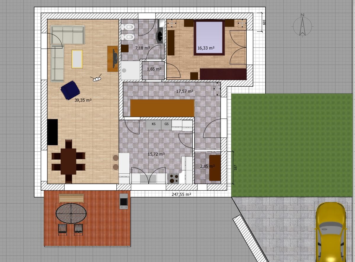

Attached is our floor plan. Our designer has now set almost all the windows at a sill height of 100cm (40 inches) and made them 126cm (50 inches) tall. Somehow, I don’t really like these windows. I often see these continuous bands of windows in new builds, which I find very appealing. What are the standard sill heights for those, and what height do those windows typically have?
How would you position the windows in my floor plan? The south side of the living room is almost certain—that means a 3-meter (10-foot) sliding door plus a double window in the kitchen (sill height 125cm (49 inches), 201cm x 101cm (79 inches x 40 inches)). But I’m totally unsure about the west side—what sill heights, window widths, and window heights would you choose there?

I find the front door placement a bit unfortunate. Is the intention for guests to be guided through the kitchen?
And why do you have two doors leading into the kitchen?
Also, the seats at the back of the dining table are hard to access. The table probably won’t remain in that position.
Two toilets? Or a toilet and a bidet? In any case, they are located far too close to each other.
Maybe you could share your architect’s plans. Perhaps more details could be gathered from them.

1. Yes, the guests are meant to go through the kitchen. This is intentional because I don’t want visitors passing by my bedroom. It’s possible the left door to the kitchen will be redirected towards the living room, but we still need to check if there will be enough space left for the TV wall and whether it would be disruptive.
2. This second door provides access to the bathroom, bedroom, and basement.
3. We will just place the table on our parquet floor without fixing it permanently, so it can still be rotated and moved if needed—note the irony. There is plenty of space available.
4. The second toilet is actually a bidet, and its position will be adjusted.

This floor plan comes from a designer who incorporated our wishes. Finding a reasonable layout here is an extreme challenge because everything revolves around the staircase in the middle. As it stands now, we are very happy with it, except for a few minor details.

5. Do the top edges of the clerestory windows align with those of the sliding doors on your side? 3. However, the table’s placement is quite important because of the lamp above… just a note that you should keep that in mind.
4. Is there enough space for that? Always plan with the actual measurements and positions to avoid an awkward final result.
