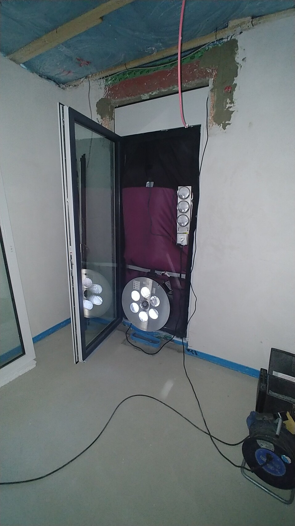

R.Hotzenplotz26 Sep 2018 19:35We had the blower door test today. It took a total of five hours until the leaks were reduced enough for us to reach 1.3.

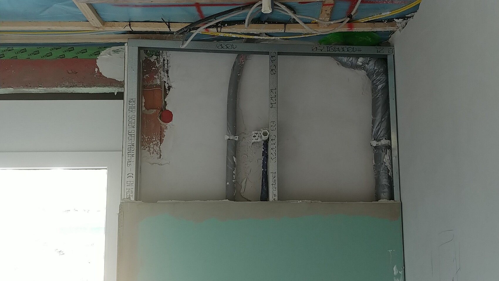

Drywall work had to be dismantled again, countless spots on the vapor barrier had to be corrected, and so on... but I think it was very beneficial that I was there.
What really surprised me was that the drywall installer sealed an unplastered area, which of course ended up allowing air to pass through.
