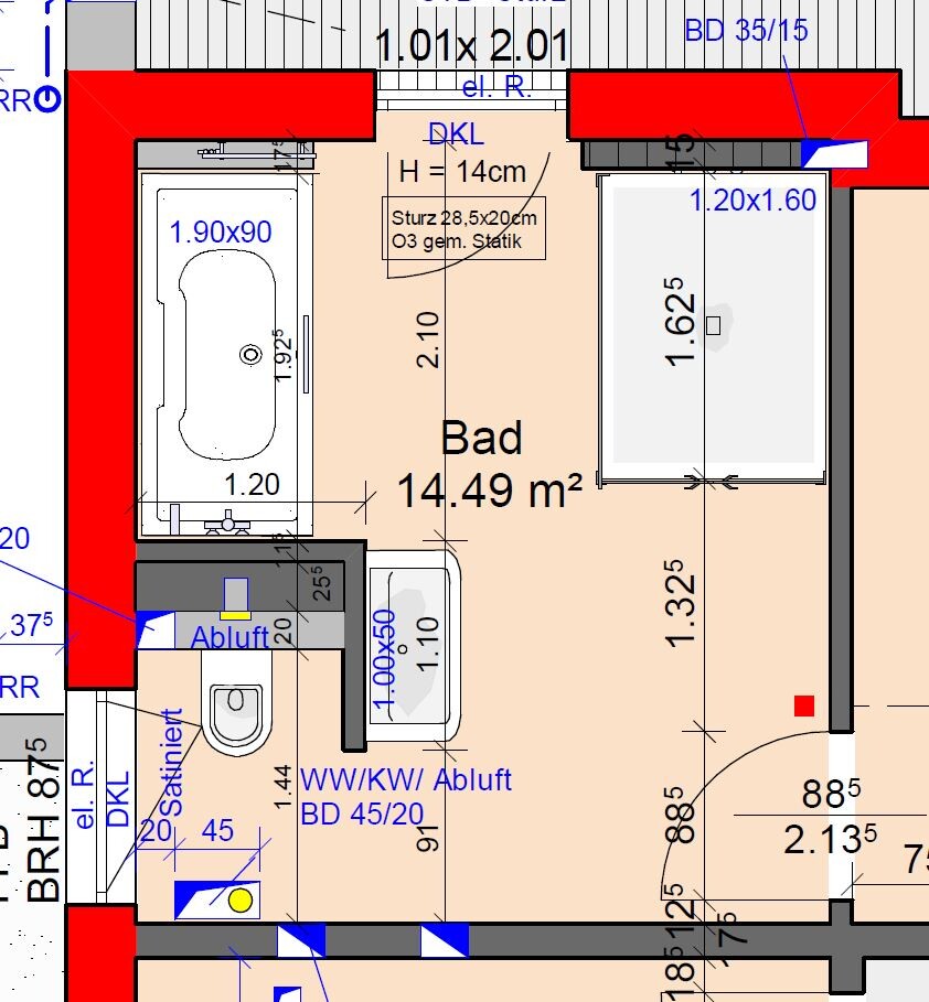

R.Hotzenplotz30 Jul 2018 07:56Climbee schrieb:
To be honest, I find mirrored cabinets, whether surface-mounted or recessed, pretty retro, sorry.It’s really just a makeshift solution, since the initially planned boxed-in structure turned out not to fit properly between the washbasin and bathtub passage.
Climbee schrieb:
Do you have an installation pedestal there?What is that? I’m attaching the excerpt here.

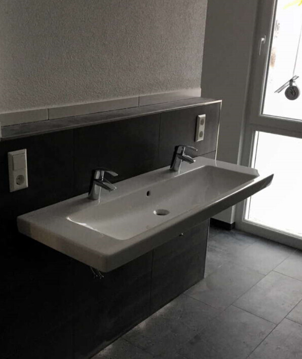

I don’t see an installation plinth by the washbasin in the plan. It’s a type of false wall, about 10cm (4 inches) deep, where the installations run. You see this in many bathrooms—usually with the mirror above it—and the ledge created is often used as a shelf. I find the mounted shelves just about as unappealing visually as mirrored cabinets.
Pictures speak louder than words, so here’s something like this
From the back, I use an extra handheld mirror stored in the pull-out section beneath the sink, which I find more flexible. With a folded mirror door, you always have to lean half over the washbasin awkwardly.
But as I said, I’m easy about it—if someone likes it for whatever reason, that’s fine. I just don’t like it.
Phew, Räuber, you’re really scaring me. I think our general contractor already considers me a nitpicker, but after your story, I’m probably going to top that reputation...

R.Hotzenplotz30 Jul 2018 08:17Climbee schrieb:
I don’t see a installation plinth in the plan at the shower enclosure.This is the current plan. Previously, something like that was drawn in. That’s actually how we wanted it. But it just doesn’t fit!
They had drawn it in before, but carelessly and with incorrect furniture dimensions. I basically had to beg them to even include my bathroom furniture, to change the bathtub from 180cm (71 inches) to 190cm (75 inches), etc. – they always wanted to postpone it, saying it would be done later, and then time ran out... simply frustrating.
