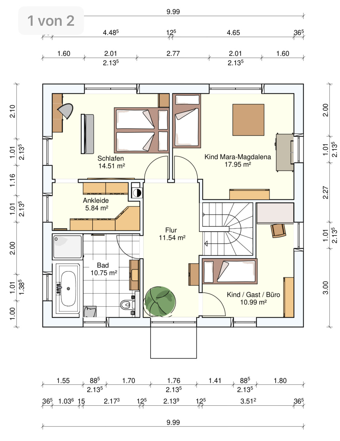

Hi, attached is a floor plan for a townhouse (142sqm (1,527 sq ft)).
What can be improved here? How can the upper floor be optimized in relation to Child 2’s room?
All windows on the upper floor are floor-to-ceiling and located in the same positions as on the ground floor.
On the ground floor, for example, I would create an opening from the kitchen to the hallway opposite the floor-to-ceiling window.
1. This would save having to go through the living room.
2. It would allow natural light into the hallway through that window.
Additionally, I might consider moving the fireplace closer to the living room.
- This would make the walk-in closet more usable; it would probably not disturb Child 1’s room.
Regarding Child 2’s room, the only idea I have is to incorporate the hallway space. Child 2 would then have the wide floor-to-ceiling window, but the hallway would lose its window entirely...
I’m really at a loss here.

Floor plan of the upper level: hallway, bedroom, walk-in closet, bathroom, 2 children's rooms, office/guest room.

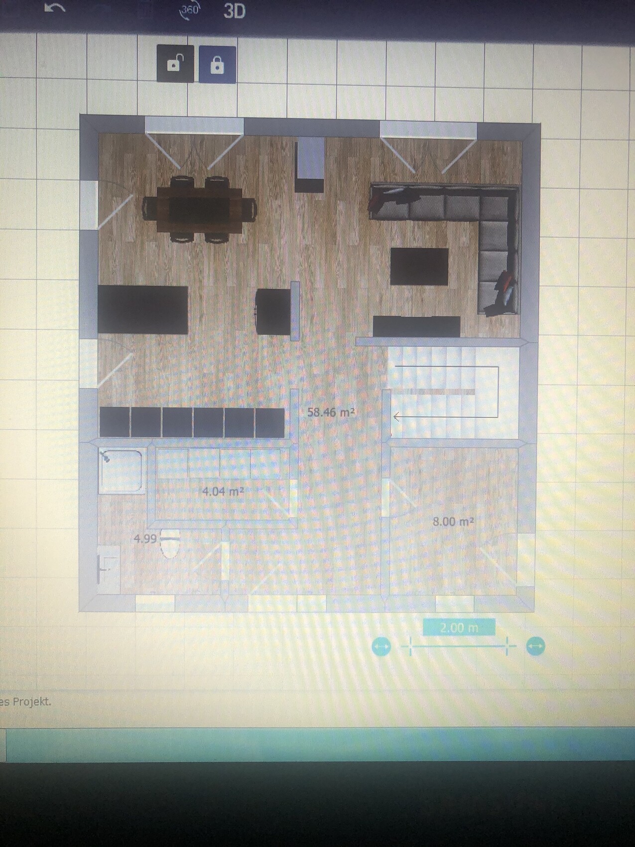

What do you think of my first attempt at designing the ground floor?
It’s now 9.5m (31 feet) wide and 10m (33 feet) deep. The interior walls are all 17.5cm (7 inches) thick since I’m not sure which ones need to be load-bearing.
I’m still uncertain about the bathroom and the dressing room/pantry. The shower will definitely be 100x100cm (39x39 inches). In the pantry, there are four cabinets measuring 60x60cm (24x24 inches) each, roughly equivalent to Pax-level storage.
The utility room is 8sqm (86 sq ft), which I believe is sufficient.
The kitchen features a 360cm (12-foot) long run, plus a peninsula measuring 180x110cm (71x43 inches), and a freestanding side-by-side refrigerator.
The dining table is the same size as ours, 180x90cm (71x35 inches). Then a sofa measuring 310x280cm (122x110 inches), along with a coffee table and TV stand. On the exterior wall, there will be a typical panoramic fireplace.
What do you think?
Oh, and I’d place a window at the landing on the upper floor, since the garage will be positioned alongside it.

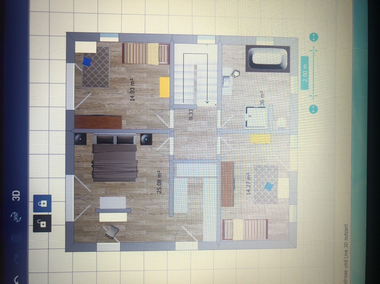

Here is the upper floor with furniture in actual size. The children's rooms are of similar size, just under 14.5sqm (156 sq ft). The bathroom layout is just an idea.
The bedroom would fit better now. The hallway gets natural light through the window at the staircase.
Honest feedback welcome. PS: The doors on the upper outside walls are all windows; I simply copied this from the ground floor.
