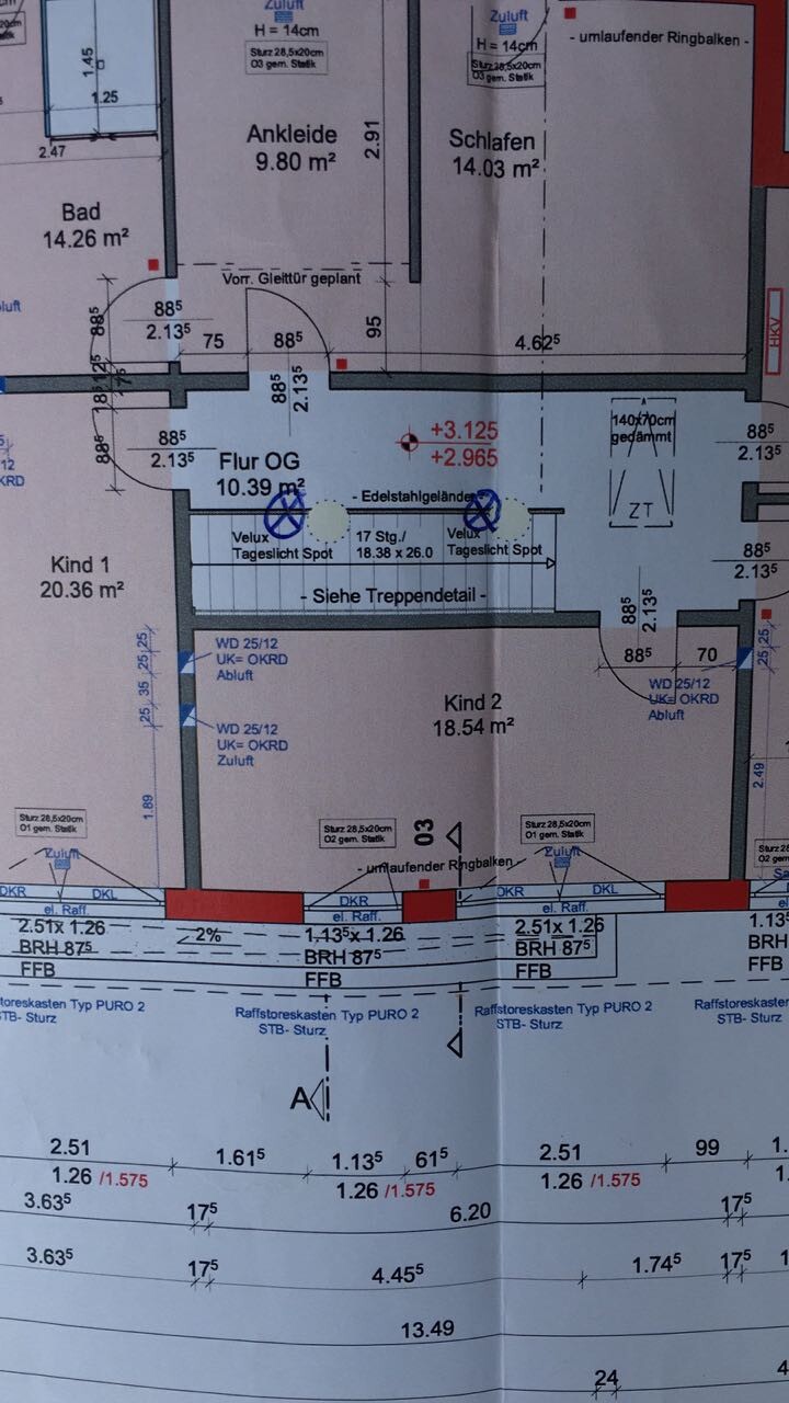

Hello everyone!
As some users have requested before, I’m now starting a new thread with the current planning of our detached house, which is about to be finalized.
These are the preliminary drawings for the building permit / planning permission application, and I have one last chance to review them and point out any issues.
It still seems to me that there is less than 1.20m (4 feet) of space between the two wardrobes in the dressing room. Or am I seeing this wrong? Apparently, the rooms on the left and right were overlooked and not adjusted accordingly.
Two Velux ceiling spotlights are still planned to illuminate the upper floor hallway.
In the basement, on the right side in the upper room, a window similar to the one on the left basement side is an option.
We still haven’t decided on the T30 fire-rated door to the garage, even though it is shown in the plans. Most likely, for safety reasons and the limited use of the kitchen at the other end of the house, we will eventually forgo it.
User 11ant pointed out that the right window in child’s room 2 is suboptimally positioned. However, this could still be changed after submitting the building permit / planning permission application. Our architect thinks moving the window to the left would negatively affect the house’s exterior appearance. We’ll have to see about that.

R.Hotzenplotz30 May 2018 13:24The daylight spotlights cannot be installed as originally shown because the roof structure is in the way. I also don’t like the sketched alternative because I feel the hallway will become too dark on the right side, and there won’t be any even lighting.
Besides, the light is needed more on the right side since some natural light also comes up through the well-lit stairwell from the hallway below.
My idea is either to move both spotlights to the right as far as necessary, contrary to the original arrangement, or alternatively, to place the spotlights at the same distance from the walls on both the left and right sides of the hallway.
The attic access is also no longer as shown; it has been rotated by 90°.
"Drawn" means pale yellow, "sketched" is checked, and where can you see the positions you would like?
R
R.Hotzenplotz30 May 2018 15:48Pale yellow represents the original plan. However, there seem to be roof beams in the way.
The crosses marked with pen were the site manager’s suggestion, which I do not like.
I have not drawn in my own ideas.
