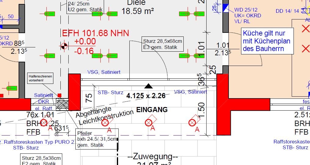

Hello everyone!
As some users have requested before, I’m now starting a new thread with the current planning of our detached house, which is about to be finalized.
These are the preliminary drawings for the building permit / planning permission application, and I have one last chance to review them and point out any issues.
It still seems to me that there is less than 1.20m (4 feet) of space between the two wardrobes in the dressing room. Or am I seeing this wrong? Apparently, the rooms on the left and right were overlooked and not adjusted accordingly.
Two Velux ceiling spotlights are still planned to illuminate the upper floor hallway.
In the basement, on the right side in the upper room, a window similar to the one on the left basement side is an option.
We still haven’t decided on the T30 fire-rated door to the garage, even though it is shown in the plans. Most likely, for safety reasons and the limited use of the kitchen at the other end of the house, we will eventually forgo it.
User 11ant pointed out that the right window in child’s room 2 is suboptimally positioned. However, this could still be changed after submitting the building permit / planning permission application. Our architect thinks moving the window to the left would negatively affect the house’s exterior appearance. We’ll have to see about that.

R.Hotzenplotz21 May 2018 19:31We originally planned to install a flush-mounted mailbox on the wall to the right of the entrance, centered at standing height. According to the construction manager, this isn’t possible because it would compromise the insulation. He suggests installing the mailbox at the very bottom on the wall bracket, where there is no interior space on the other side. However, I think that would look absolutely unattractive.
Now we’re considering alternative options. I don’t think a surface-mounted mailbox would look good. We’re also not quite comfortable with a freestanding post box yet.
Any ideas?
We definitely want a mailbox solution that is compatible with the Gira 106 door communication system.

According to the construction manager, we can’t do that because it would compromise the insulation. He suggests placing the mailbox at the very bottom of the wall plate, where there is no interior space on the other side. Apart from what I consider a somewhat overly cautious explanation, the suggestion seems reasonable to me.
R
R.Hotzenplotz21 May 2018 20:21Really? I somehow find that box out of place.
