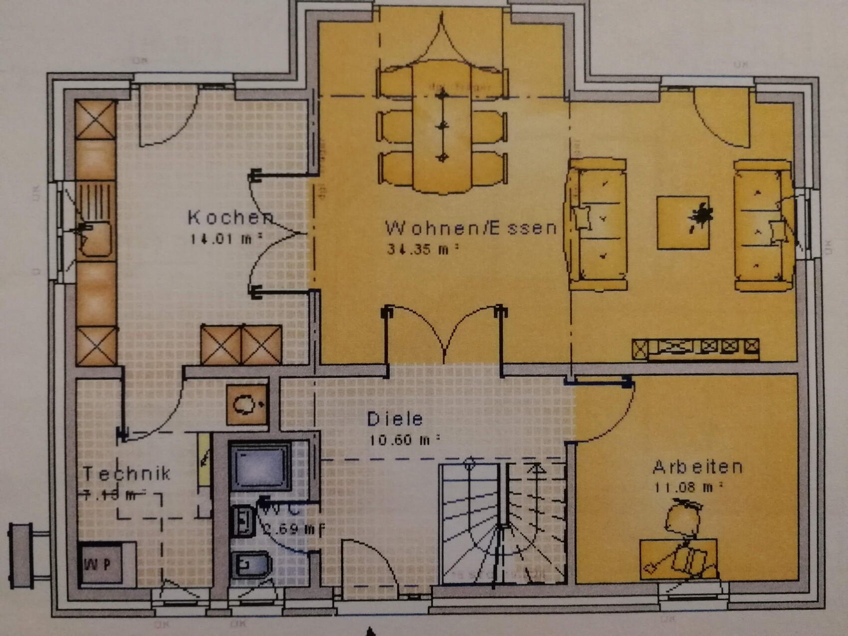

Downstairs, I am unsure if the utility room is large enough (it will include the heating system, washing machine/dryer, cleaning supplies, beverages, etc.).

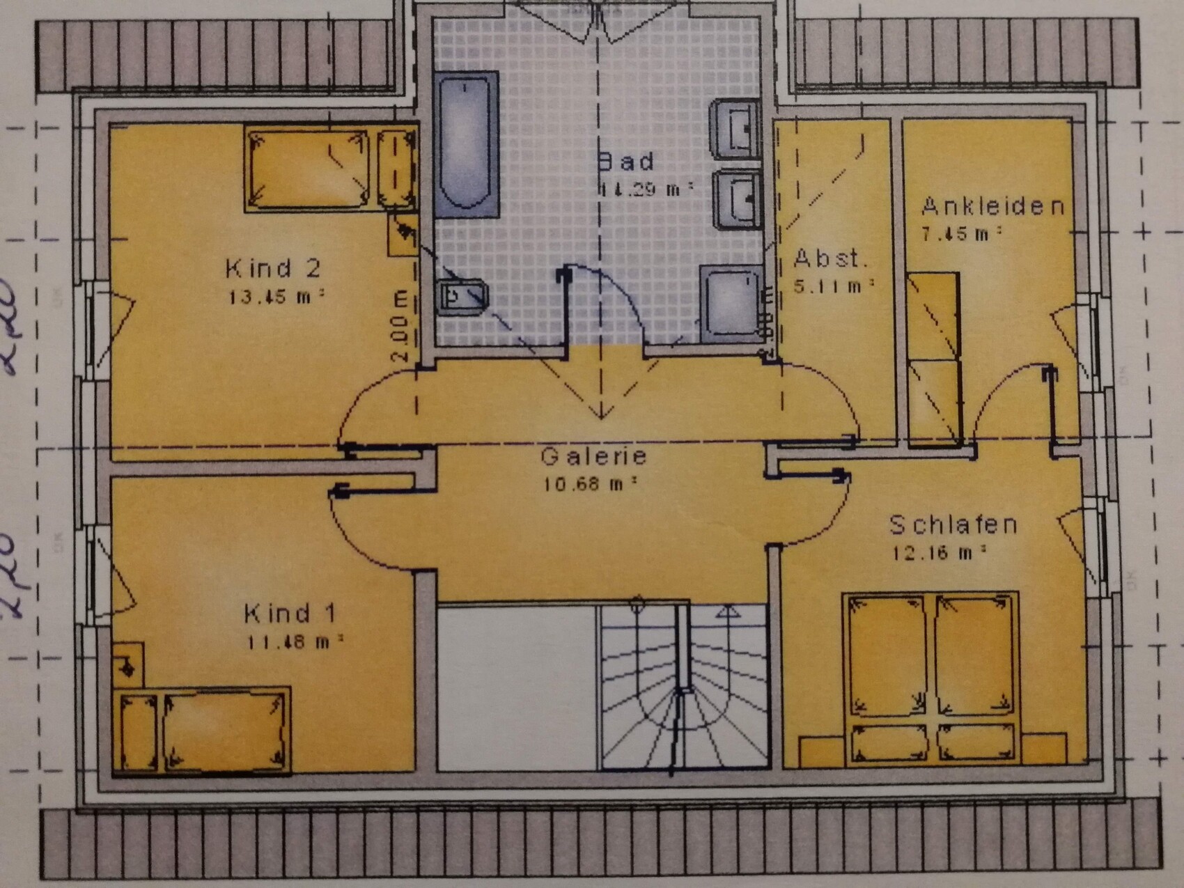

Pros: The basic room sizes (except the upstairs bathroom) fit our needs; many rooms but thanks to the gallery and rather open bright hallway it doesn’t feel like an “apartment” (possibly an additional bay window in front near the stairs and stairs with a landing; bay window also brings more natural light).
Cons: Because of the gallery and bay window upstairs, there are only few options to arrange the rooms. Or are we just out of ideas?
How can we rearrange the upper floor? (smaller bathroom, larger children’s rooms, different walk-in closet and storage layout)? General feedback welcome... 😉

- Double doors to living/dining area and relatively open hallway (no narrow corridor = you don’t bump into each other quickly) feel inviting;
- Access from kitchen to utility/technical room
What do you dislike? Why?
- Only one possible arrangement for sofa and TV
- Is the utility room large enough?
- Large bathroom upstairs not necessary; how to better use the bay window?
- Second children’s room at 11 m² (118 sq ft) is very small
- Walk-in closet and storage room not optimal

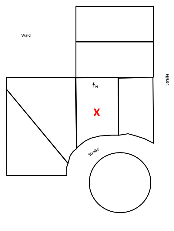

Please provide a site plan of the property to better assess the situation. Are the floor plans currently oriented toward the north?

Unfortunately, dimensions are missing from the floor plan, but overall, I find the room layout not very practical. Some rooms are too small (for example, the walk-in closet barely fits a wardrobe, especially with the knee wall there), and the walk-in closet feels trapped. For instance, if someone gets up earlier, they have to pass by the bed at least twice.
What is the element drawn in the niche within the utility room? A long storage wall is planned there through the door to the kitchen, but it also seems to be the only possible coat storage spot in the entry hallway.
The guest bathroom door should open outward with this layout; otherwise, it will be difficult to exit the room from the inside.
Bay windows and galleries increase costs. The kitchen wastes space and still doesn’t fit the item you want to have. The bathroom is also a large room without a sense of coziness.

I don’t find the floor plan itself so bad. Okay, the bathroom needs to switch places with Child 1’s room, mainly because of the wastewater connection. Child 2’s room should be a bit larger to balance that out. The whole dressing room / storage issue also needs to be reconsidered. But these thoughts aren’t really helpful when I hear you’re planning with a north orientation.
In that case, I would strongly recommend moving away from the "Brad Pitt" layout and finding your own individual floor plan optimized specifically for your country.
With a northern orientation in your country, the main rooms and terrace are usually positioned facing west to catch the afternoon sun. Of course, this also depends on the surroundings. If there happens to be a high-rise building there, the situation changes.
That’s why you really can’t make much progress without a site plan, as Kerstin already mentioned... 🙂

Thank you very much for the comments and questions!
I don’t have a site plan at the moment. However, I roughly sketched how the plot and the surrounding plots are arranged — very much as an amateur 😉 Maybe it’s helpful in some way?

I’ve mentioned my dissatisfaction with the bathroom myself. Of course, bay windows and galleries aren’t cheap, but the gallery in particular gives me a bright, open feeling.

Because of drainage? You mean because of noise? I’m not sure yet how to handle the north-facing orientation...
Thankfully, there are no high-rises—only single-family houses around 😉

Unfortunately, the floor plan is missing dimensions, but overall I don’t find the room layout very successful. Some rooms are too small (for example, the walk-in closet barely fits a wardrobe, especially because of the knee wall), and the walk-in closet feels trapped, meaning anyone getting up earlier has to pass by the bed at least twice.
This doesn’t matter to us personally because we usually get up at the same time and don’t expect that to change significantly. The sloped ceiling is indeed a challenge... We’ve considered rearranging the walk-in closet and making the small storage room accessible only through the walk-in closet. That way, the walk-in closet would have no slope. Maybe I can sketch that later.
kbt09 schrieb:
What is the element drawn in the niche within the utility room? Since the wall between the utility room and kitchen includes a long cabinet wall, there seems to be only one possible coat rack spot in the hallway.
Honestly, I’m not sure right now. I would have to check again.
kbt09 schrieb:
The guest bathroom door should open outward based on the layout; otherwise, it’s really difficult to exit the room from inside.
Yes, we would probably do it that way 🙂
Bay windows and galleries increase costs. The kitchen wastes space yet still can’t fit something you want. The bathroom is also huge but lacks a cozy feeling.

I don’t think the floor plan is that bad on its own. Okay, the bathroom has to swap places with child 1’s room, mainly because of the drainage. Child 2’s room would then be bigger — that works. The whole walk-in closet/storage setup needs reconsidering. But these thoughts don’t matter if you’re planning with a north-facing plot.
kaho674 schrieb:
For a north-facing plot, main rooms and the terrace are usually oriented west to capture the afternoon sun. Of course, this depends on the surroundings. If there happened to be a high-rise building there, it would be different.
Freehand sketches are great. 🙂
Phew, your left neighbor has quite a problematic plot. Is there already a building on it? Otherwise, you should definitely consider that awkward construction there together with the expected neighboring developments.
You should definitely start by planning how you want to position your house on the land. For example, where should the terrace be? Make sure to explain your choice right away, or the forum will object. 😉
